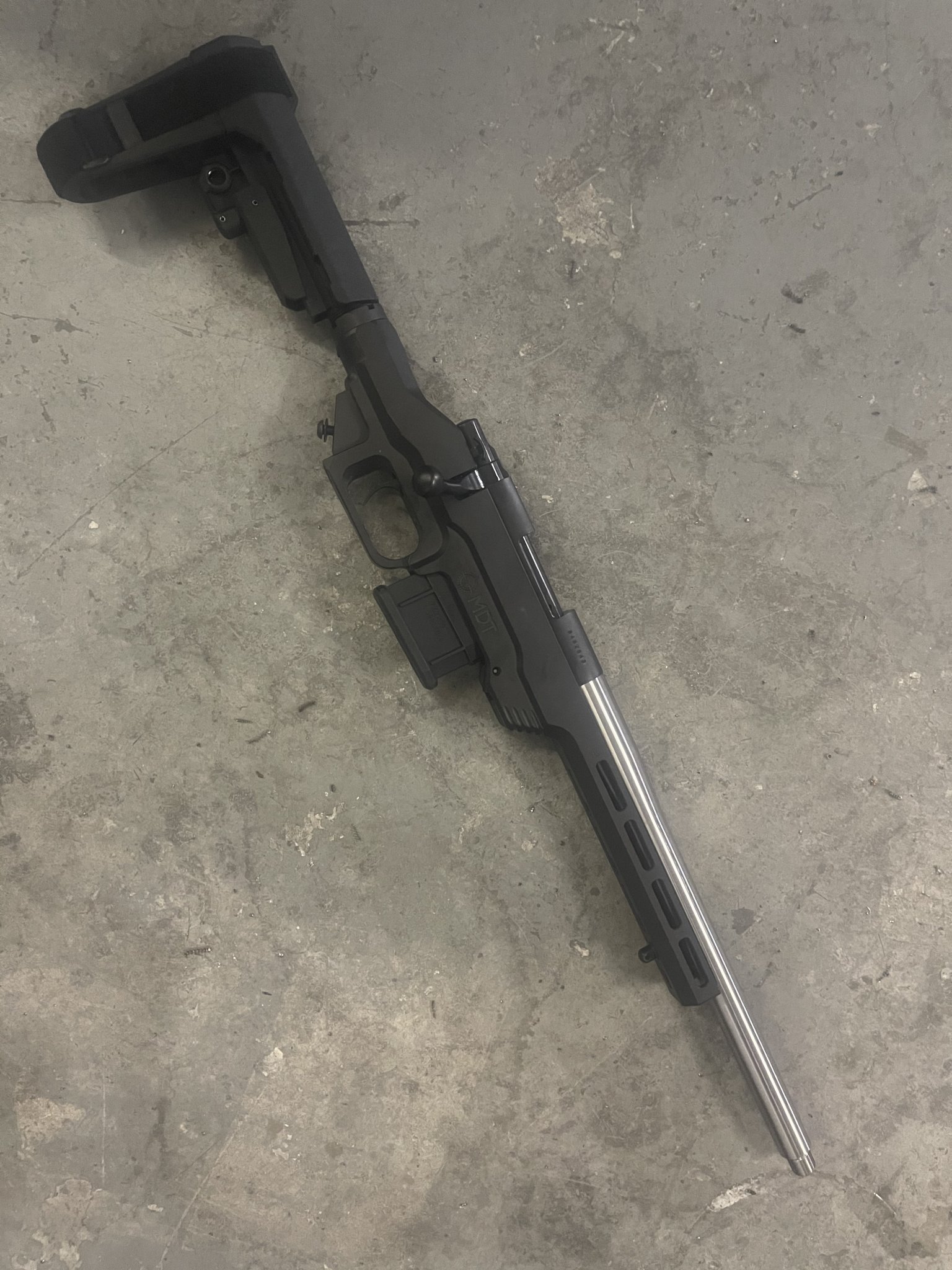

    Well I built a pistol out of a Howa 1500 mini action. The barrel is a 14.5 1/7 LH twist In 6 ARC. Going to try Berger 108s in first. I know I am posting this in the bolt rifle section but it started as a 6.5 Grendel barred action. I will be using this for deer and coyotes. Hope to be running a Eotech Vudu 5-25 on a 20 moa rail. Having a hard time figuring out which mount to run. Any suggestion.

    Is was built by a gun smith and built as a pistol never built as a rifle.. It was just a barreled action and never put into a stock. He researched it before we started this project.
    This is the same process that JTAC uses for it Elf Owl pistol.
    Cool, looks cool. Why didn't you just build it as a short barreled rifle?
    Cool build!
    If you're gonna go with a short barrel, might as well have the shortest action possible right?
    I've thought about doing this with a mini, but I personally dont get along with chasis very well. I've thought about doing it as an SBR with a Manners or something
    You can buy Howa Mini's as just a barreled action. That should be classified as a receiver, after that building as a pistol should be no problem. It might depend on how the FFL holder fills out the 4473. I hate that we legal-ese each other to death over this stuff, wish we could be more supportive and united as pro-gun people!
    Shrubjr, that’s exactly what we did. It is coming to my dealer as a pistol . The reason I went this way is I want a short pistol but long enough to take advantage of some length for bullet speed and energy for hunting out to 400 yards. Now it may go farther than that we will just have to see. I will also run a Thunder Beast Dominus.

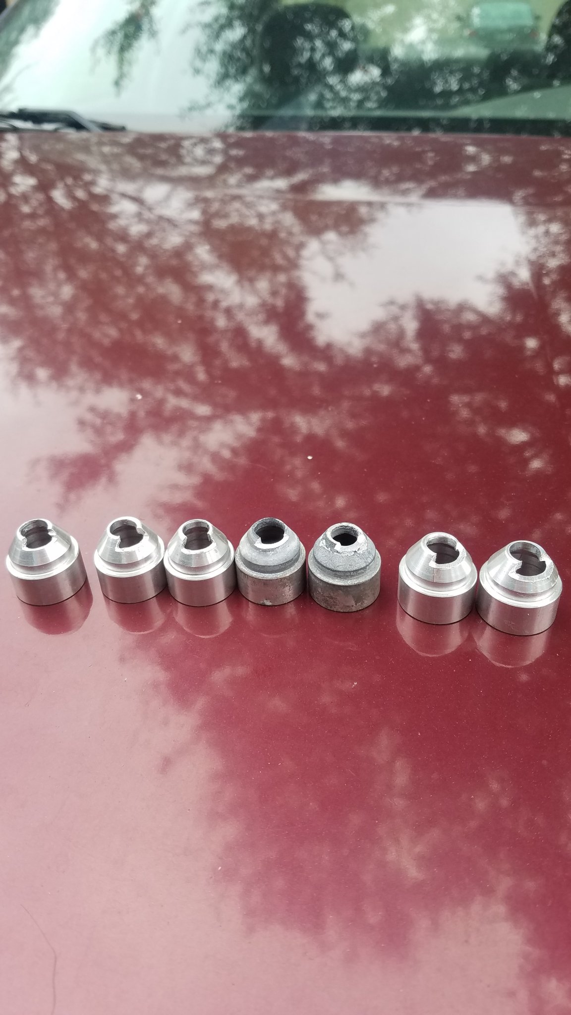

    Did you drill AND clip your baffles?
    Clipping makes a huge difference.
    I cheaped out and just used pressed free plugs. Is it worth clipping those also? I may as it can't hurt really.
    Probably.
    The purpose in clipping is to allow the gases to be trapped/slowed down between the cups.
    A straight shot through, lets the gas fly right through.
    I helped a buddy clip his cups on a pair of fm-1 cans and the difference is amazing.
    Here's a pic of the 22 cups after clipping.
    We tried different depths/sizes but in the end, any clipping works.
    Even the hole size doesn't matter much.
    Note: the end cap was drilled to be 22 only.
    What do you have to lose?
    Freeze plugs are pretty inexpensive.
