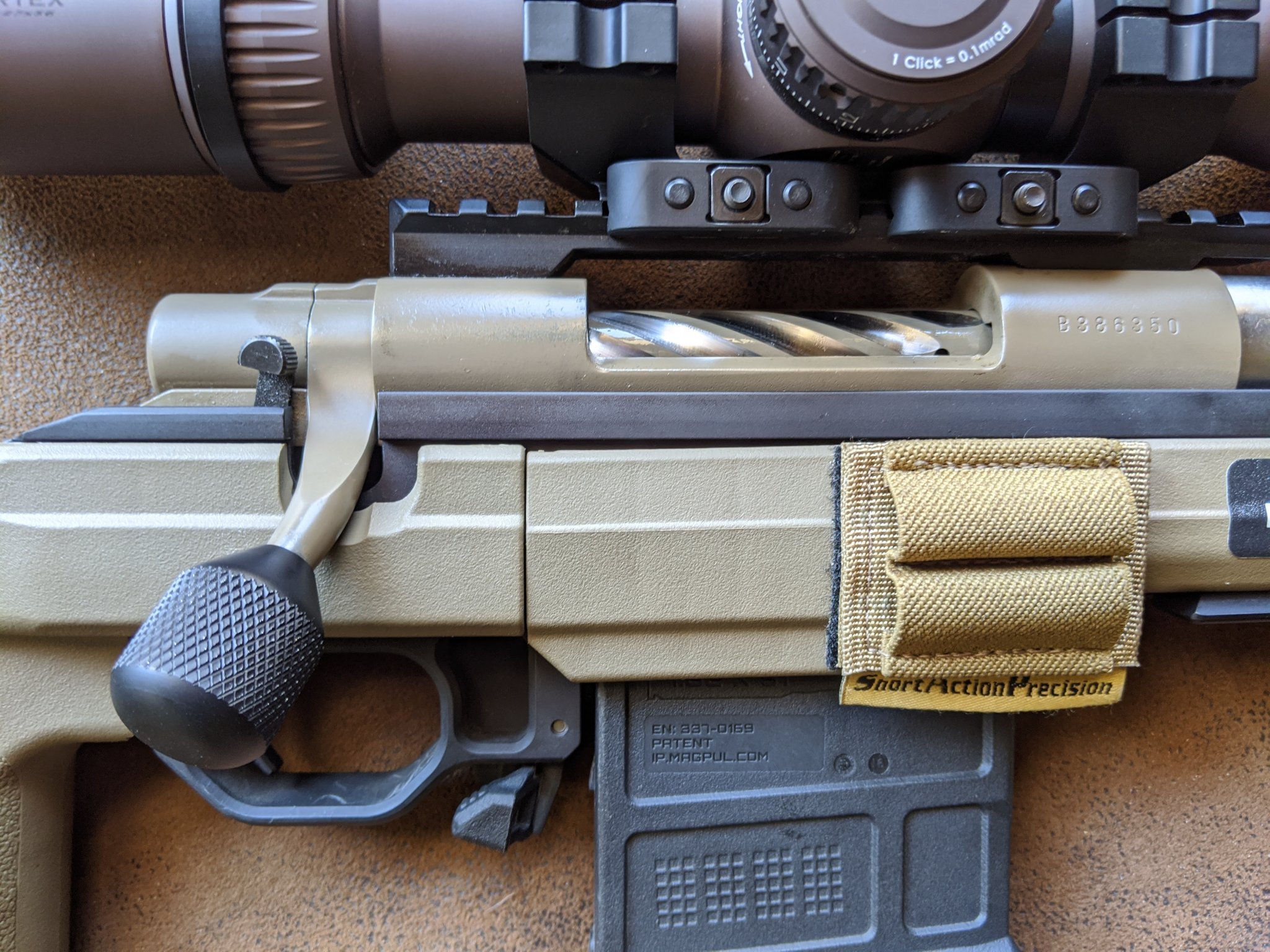

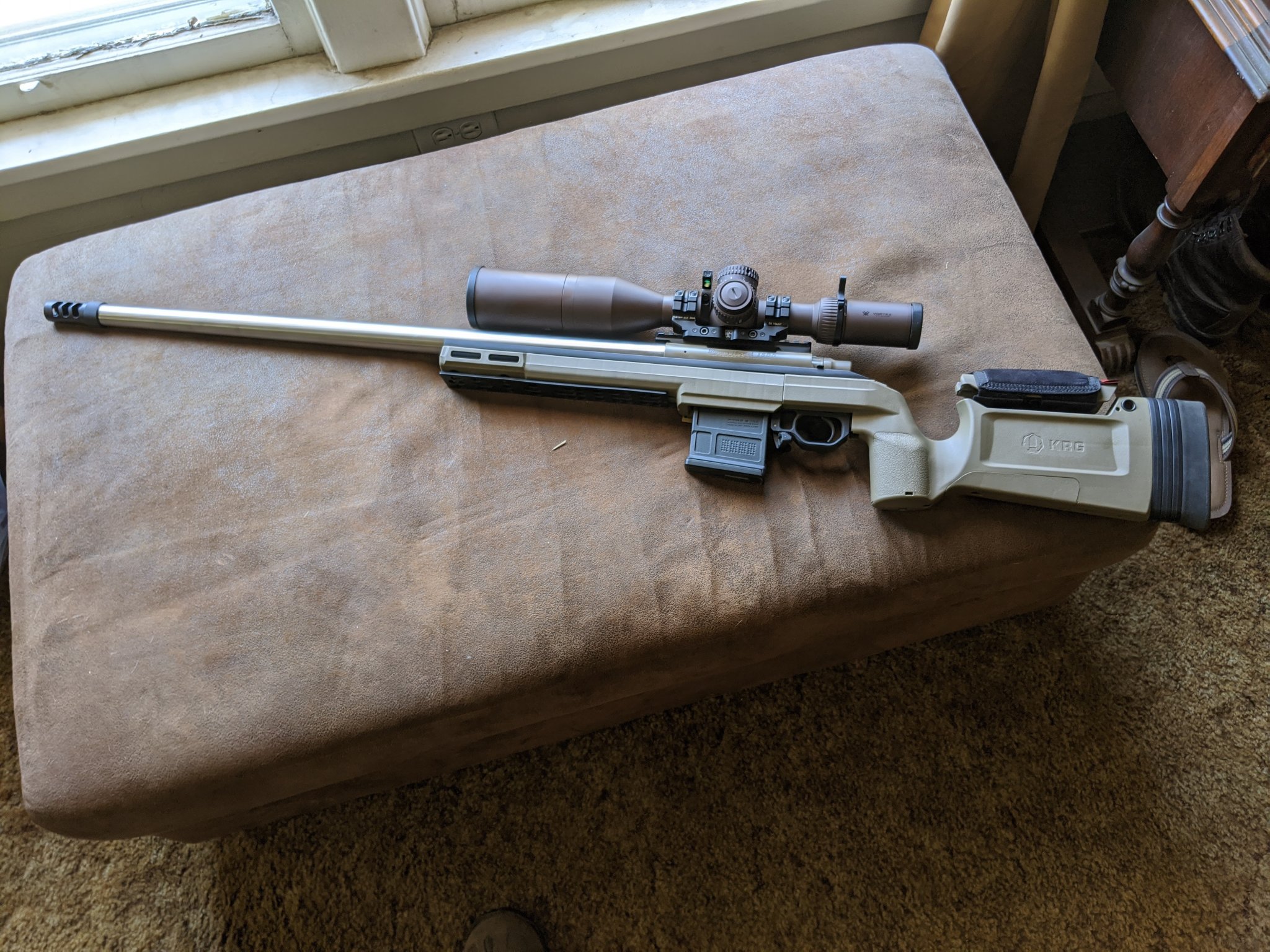

Had local gunsmith do mine, rebarreled with a heavy Krieger 8 twist 6.5 creedmoor

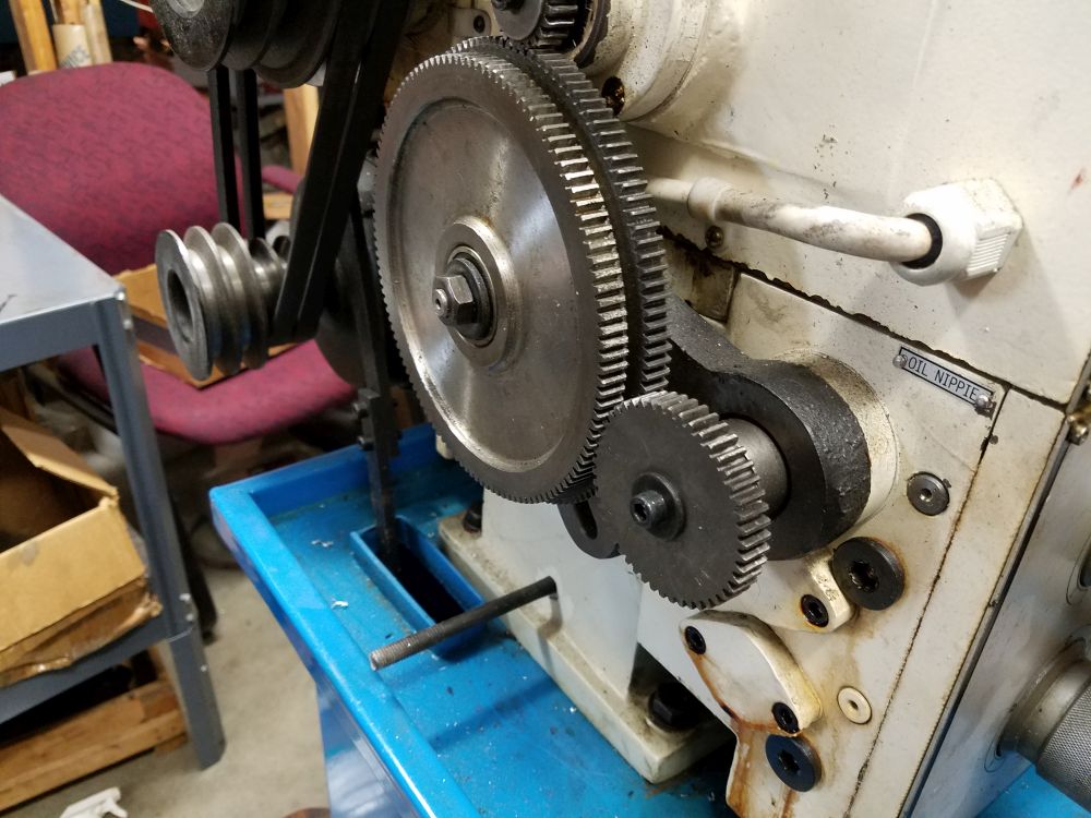

The metric thread I have done while rebarreling Arisaka rifles. My lathe is a Precision Matthews 1236.
To go into metric threading it takes an extra 10 minutes to dig out a gear, put it on, and tighten everything.
Here is a picture of the gears I had to swap for the 1.5mm pitch barrel threads. Yes, I got grease on my hands.
