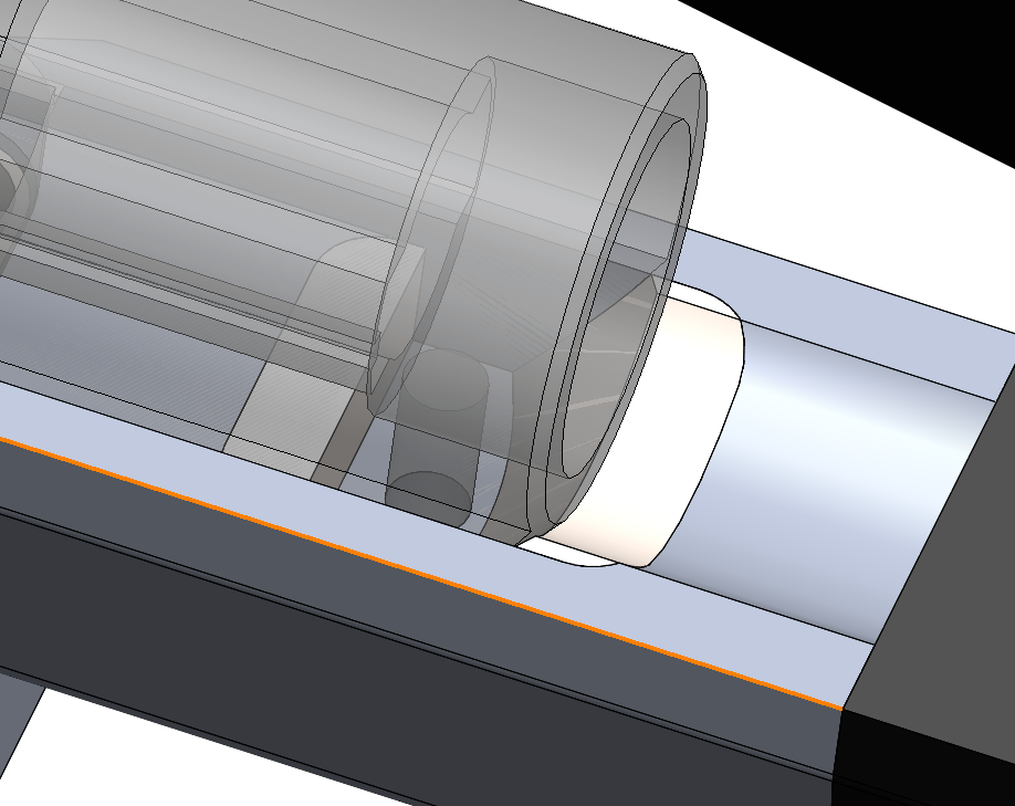

I’m glad I saw this. I’m milling a chassis for a Howa 1500 and wasn’t sure if the tapered bit on the recoil lug needed to be bedded.
