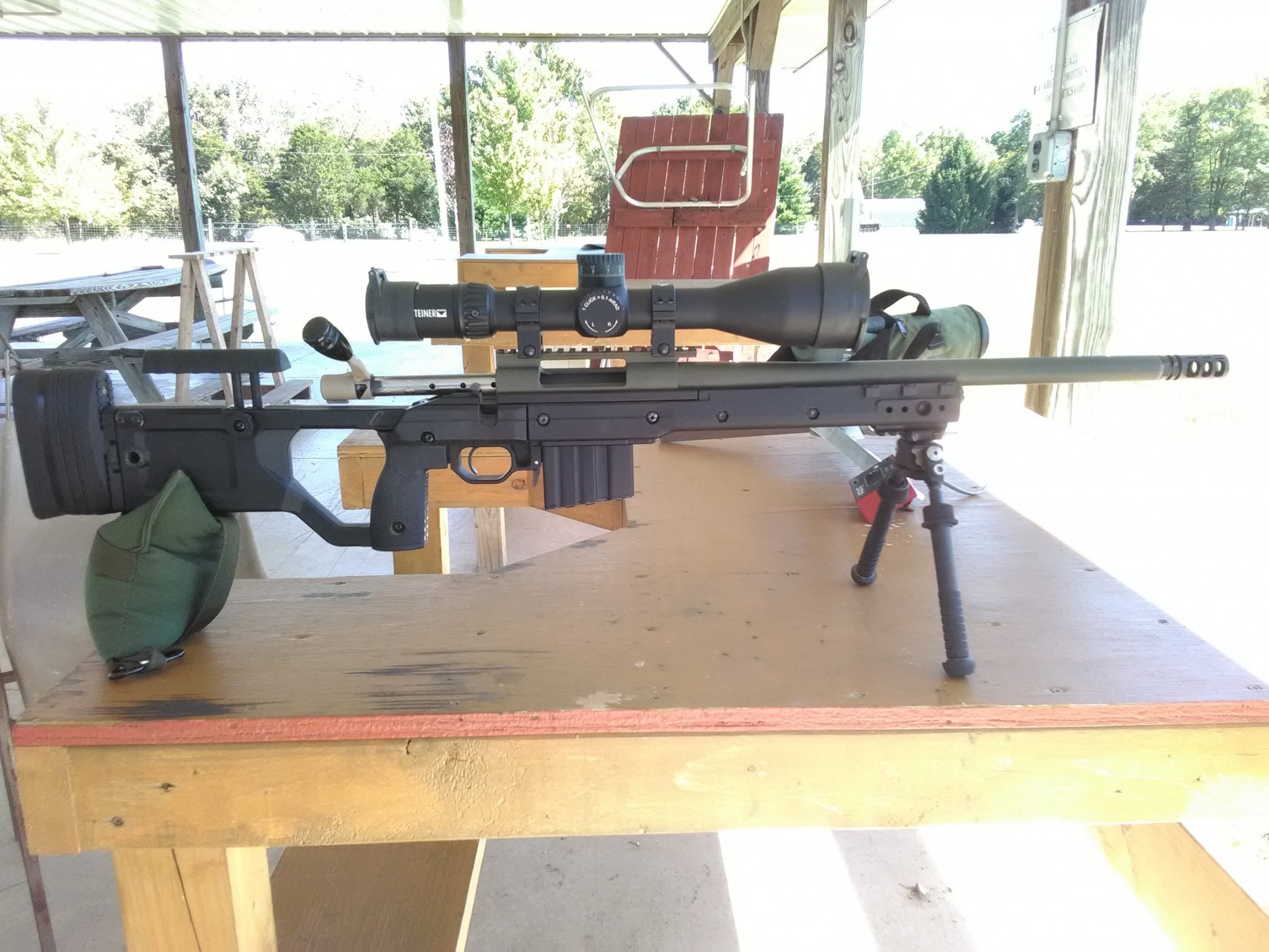

Here's mine: Howa 1500 BA from Brownells, Crown Ridge Barrel Works X-Caliber MTU 6CM 1:7.5, Bravo + almost everything KRG makes for it. Weighs ~23lbs unloaded, balances perfectly and puts rifles costing 4x as much to shame on a regular basis...

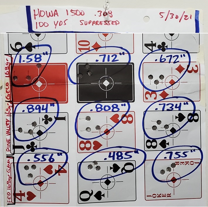

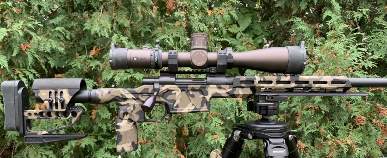

Stocks are always a personal choice, but my choice has been the bravo--very traditional styling but also very modular. Howa + Bravo is my personal choice for a first rifle.
I have a Rem 700 308 in a Bravo and a Howa 6.5 in a Bravo. Served me very well as I grow, add junk, remove junk, learn, fail, learn, succeed....
Reactions: M1A1Abrams

IMO there are a few things to consider if choosing between a BRAVO or ACC:
First would be feel, the Bravo feels more like a Manners to me, because it's part polymer it tends to soak up some of the vibes from recoil and feel more "dead", it's not a huge difference, but it's there and it's noticeable. The ACC will feel a little sharper and more direct under recoil. Again, not a big difference but it's there, I prefer the KRG/Manner-ish feel. YMMV.
Then there's the weight you want it to end up: I've gotten my Bravo to ~22lbs using the all the weights KRG has available without any extra DIY stuff or tinkering (no wheel weights, lead shot + epoxy, etc), and that's about as heavy as it can go (that's with an MTU contour, a straight/bull contour could go a little heavier of course, but not a lot). An ACC can be made a bunch heavier than a Bravo between internal and external weights, so depending on one's body type or what they're looking for, if they want a super heavy "knocking on 30lbs beast", the ACC is it.
Lastly, concerning cost: try not to think of the Bravo as a $430USD solution, because it's not IMHO.
A Bravo in stock form is a good lightweight hunting platform, that's about it, that's what you "build on". Factor in an additional ~$250-300USD in add-ons and weights to arrive at a Bravo that can hang with the best of them in PRS/NRL form, so realistically it's more like a ~$700USD chassis for that kind of thing (which still isn't bad considering what it'll do and how it'll perform).
IDK anything about the B&C stock so can't help you there, but I'm weary of putting too much money into anything that doesn't let you "grow with it" these days.
The Bravo has spoiled me in some ways, you can bolt on or take off whatever you want, and it can adapt and change over time... I also have a Manners TCS, pretty much as good a stock/chassis as one can get these days, but honestly there are quite few things it could learn from the Bravo. The Manners has most everything one would need, lots of bells and whistles, but it's no where near as adaptable as a Bravo is, no way. Honestly, JMHO here, but having been behind all the KRG's, besides them looking cool, I have no idea why KRG still sells Whiskey's and X-Ray's... the Bravo's are far better IMO.

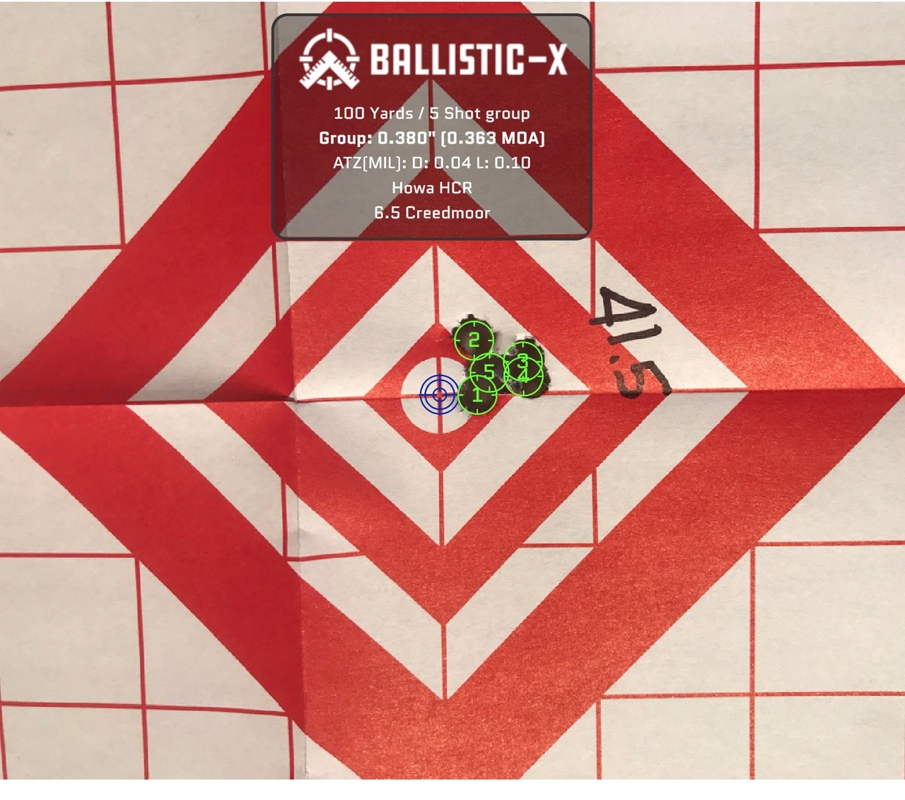

Mate thanks for the feedback. Sounds to me like the Bravo is a good place to start. At the price, I really have nothing to lose. If I don’t like it I can move on and try something else.
Has yours been bedded?
Pretty much any add-on you buy that will work with a Bravo will work with all the Whiskeys and X-Rays out there too, so if down the road you want to try one of those or just sell it all off, you don’t have to worry much about being stuck with it.
I’ve never bedded a Bravo. Never had more than 1/2moa with one, so never really had a reason to bother. Pulling the BA and dropping it back in, usually mine returns to zero or needs a click or two of adjustment, that’s it.
