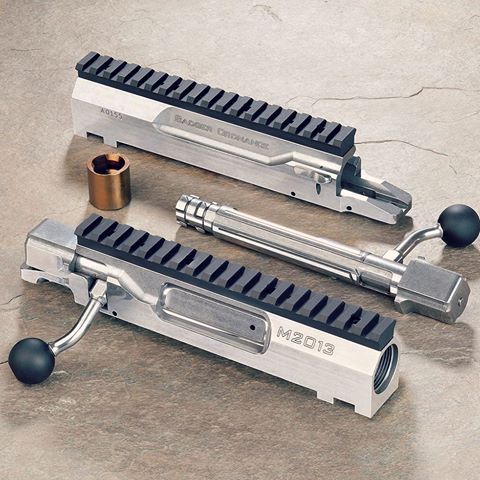

    Last year I ordered a custom barrel from CBI (through Northland Shooting Supplies - another great shop to work with) cut for a barrel nut threaded for my Badger M2013 action. CBI was great to work with. I had the barrel short chambered, and cut the last .030" with a reamer by hand to set the head space. The custom cut fee was only $50. They followed up by email to make sure the barrel worked out. I couldn't ask for more.
    Maybe I misunderstand but........if you bought a custom barrel-nut barrel for your Badger, why would have it short chambered? You could have increased headspace from minimum (bolt barely closing on a GO) in infinitely small increments with barrel rotation.
    The M2013, like other 60 degree throw 3 lug actions (AI and Tempest), uses a breech ring. This ring is made of a softer alloy than the bolt to prevent galling, and the lug abutments are machined into the ring. The reasoning behind the use of a breech ring is that all the wear occurs on the ring, and it is inexpensive and replaceable.
    The breech ring slides into the action before the barrel is screwed in, and is captured between the action and the barrel face. Therefore, unlike a Savage/Remage barrel nut installation where the headspace is set by screwing in the barrel (using a go/no-go gauge), the M2013 headspace is controlled by chamber depth, i.e., case head protrusion.
    Badger provides the CAD drawings which includes case head protrusion measurements. I could have asked CBI to ream the chamber to that measurement, but I wanted to control the headspace myself and had them short chamber the reaming. Hand reaming is quick and easy, but you could have CBI ream the chamber to design specification and it should headspace correctly. That was just my preference.
