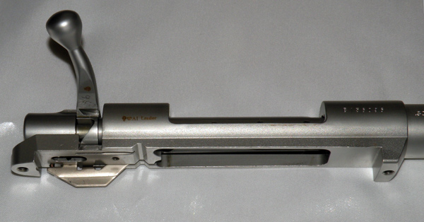

Just the projection. I did not have to mess with the bolt stop, but I will double check it after hearing about others that had to change theirs.
A couple crappy cell phone shots. It's hard to make out, but the action is as of yet unaltered. The only other thing I forgot to mention was that i had to open up the feed lips on the AI mag to get the rounds to time properly.
