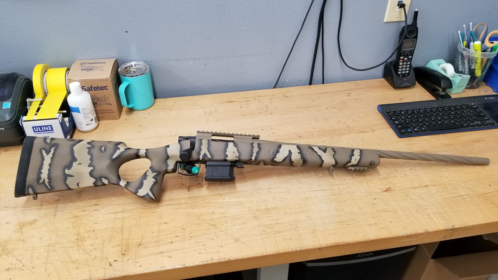

Mine was in a b&c. Didn't feed right. Apparently that's fixed and I want another in white with Oregon gunsmithing bdl
