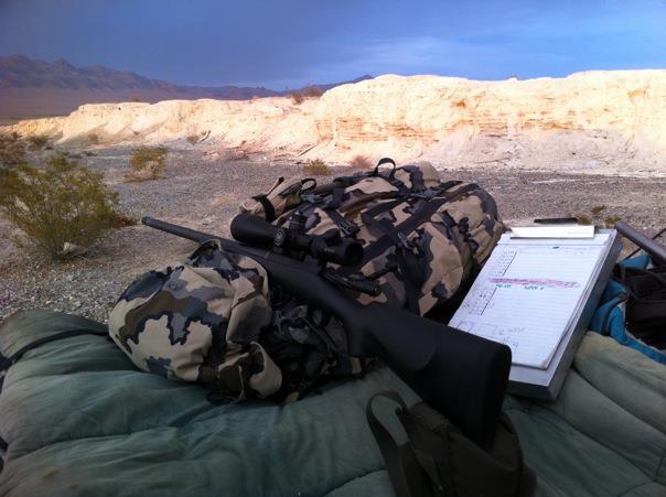

off a set of sand bags and shooting the 168gr. VLD at 2960 avg.
Gun is a Christensen Arms 7wsm with a 4-16 pst and talley low rings (super close to the gun)
...Man Im ready for muley season...
