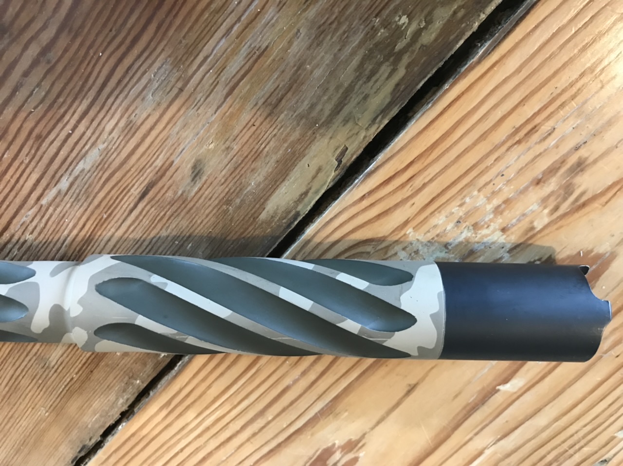

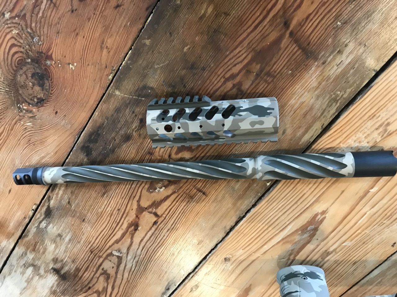

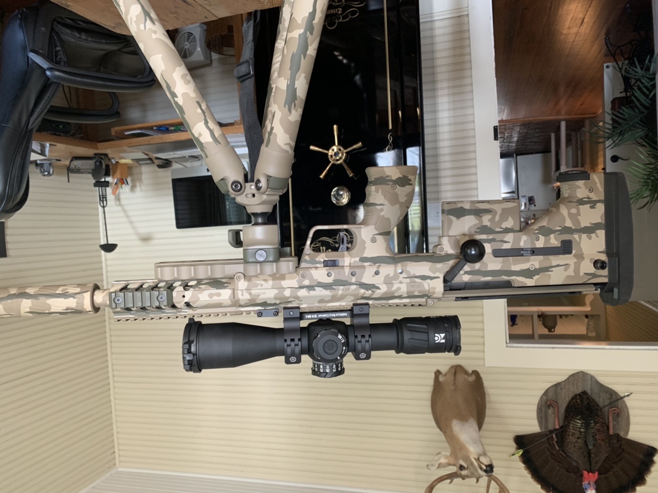

Had an A1 and put it on a diet with a 16” barrel, heavy fluting on the barrel and shank, lost the mono pod and still only got it down to to 13.5 lbs with MK5 3-18. Still a heavy bitch to haul around. Sold it and built a light weight rig.
