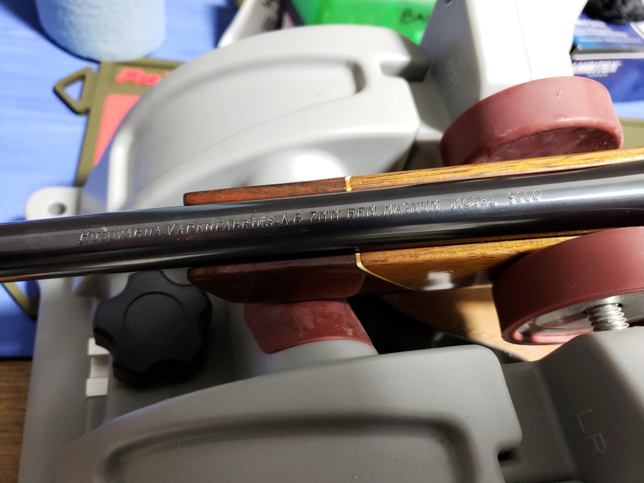

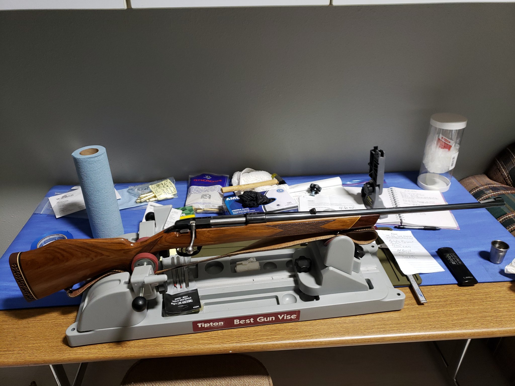

    Someone has got to have a definitive answer on this, cuz I sure as hell can't find one.
    I'm trying to find a Picatinny Rail for a buddies Husqvarna Model 9000 in 7MM RemMag. I've got a loopy base for it, but he's hell bent on a Picatinny Rail.
    Google Fu has come up with 'nothing'.
    I thought they were based on a Mauser action? Maybe try one of those
    Reactions: jcmullis2

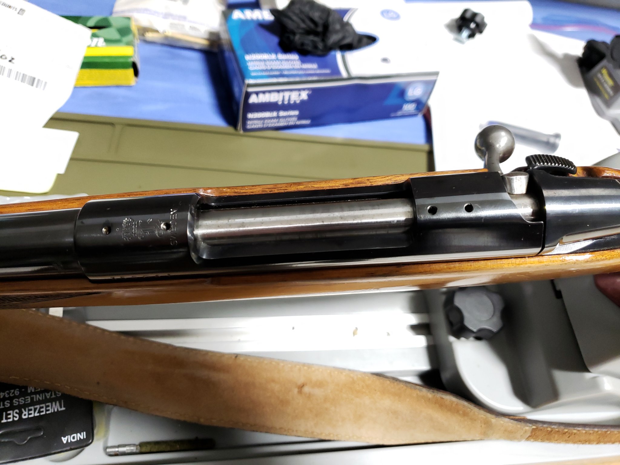

    That rear hole spacing looks like Rem model 7 or possibly 788.
    Tell him to get weaver bases and widen the slots for Picatinny rings.
    Use Burris if he needs/wants some cant.
    Reactions: 1J04

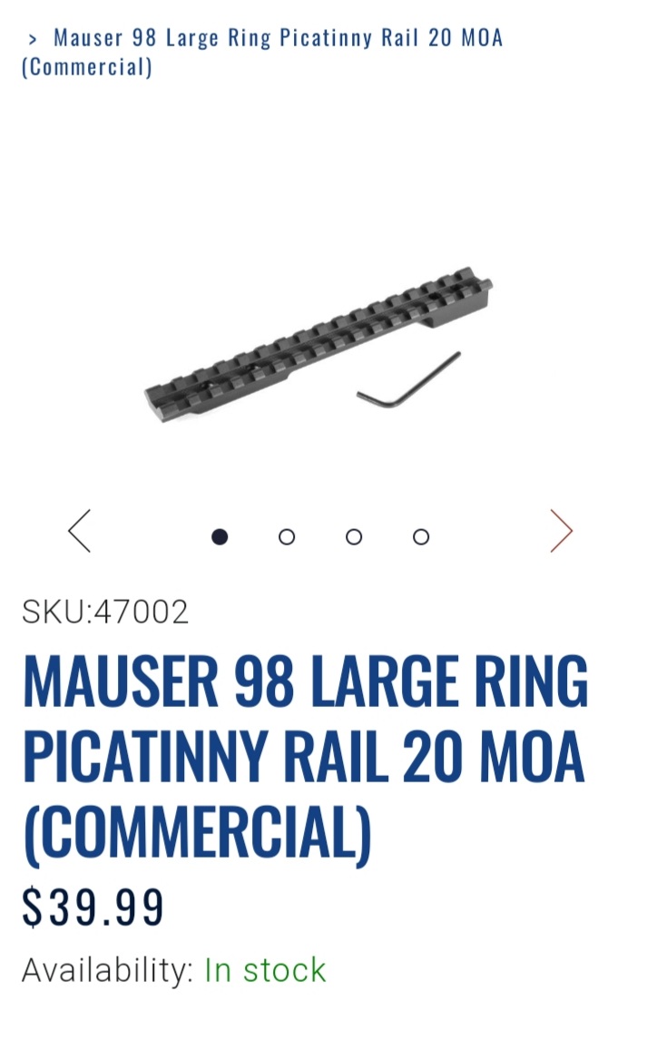

    This commercial mauser base from EGW should work.

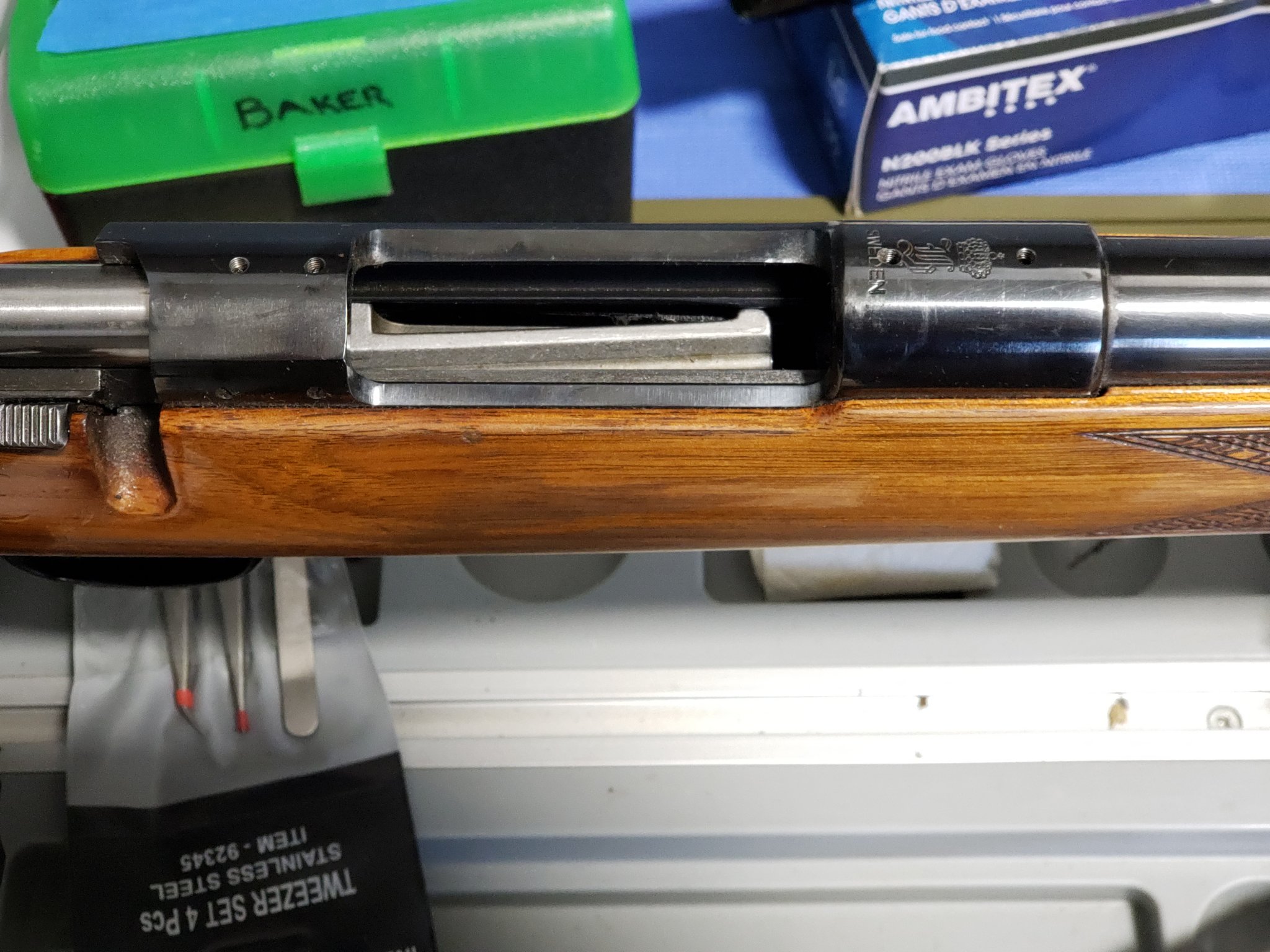

    I really appreciate the input! I'm gonna measure the spacing tonight, but I think you guys are definitely on to something. Again, thank you. 💪
    LOL I thought someone bought a new Chainsaw or Trimmer forgot they made firearms.
    Looks weird that the factory would drill through the "SWEDEN" on the receiver.
    Right?!

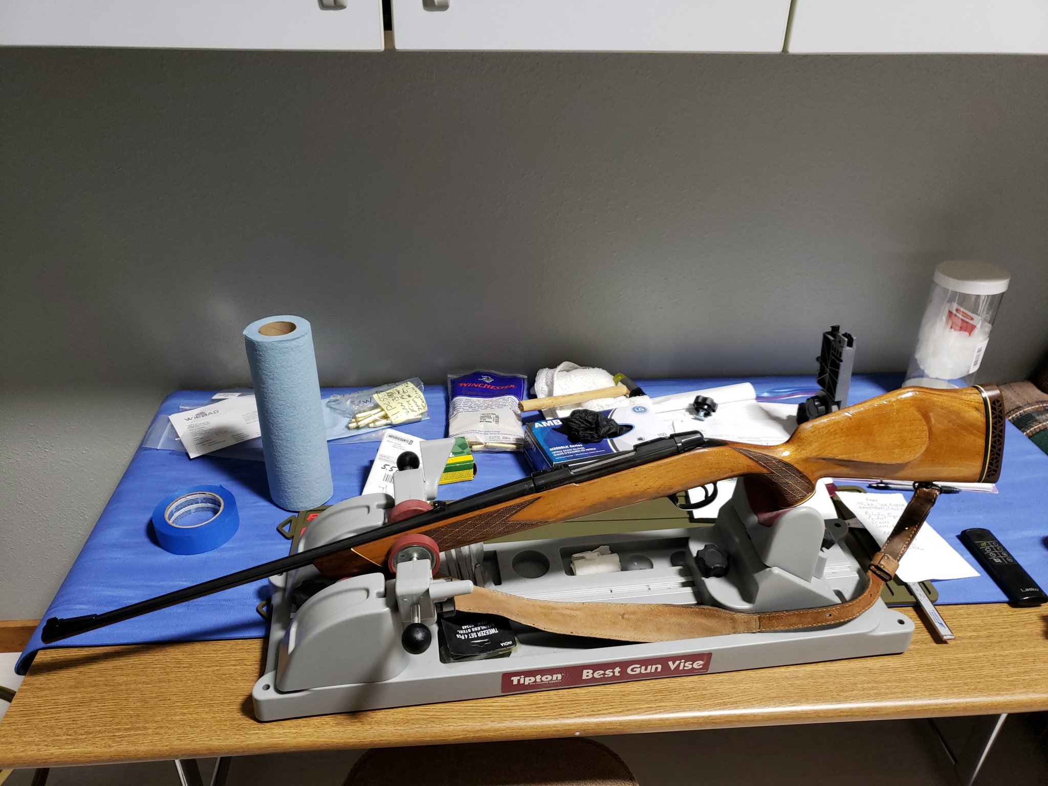

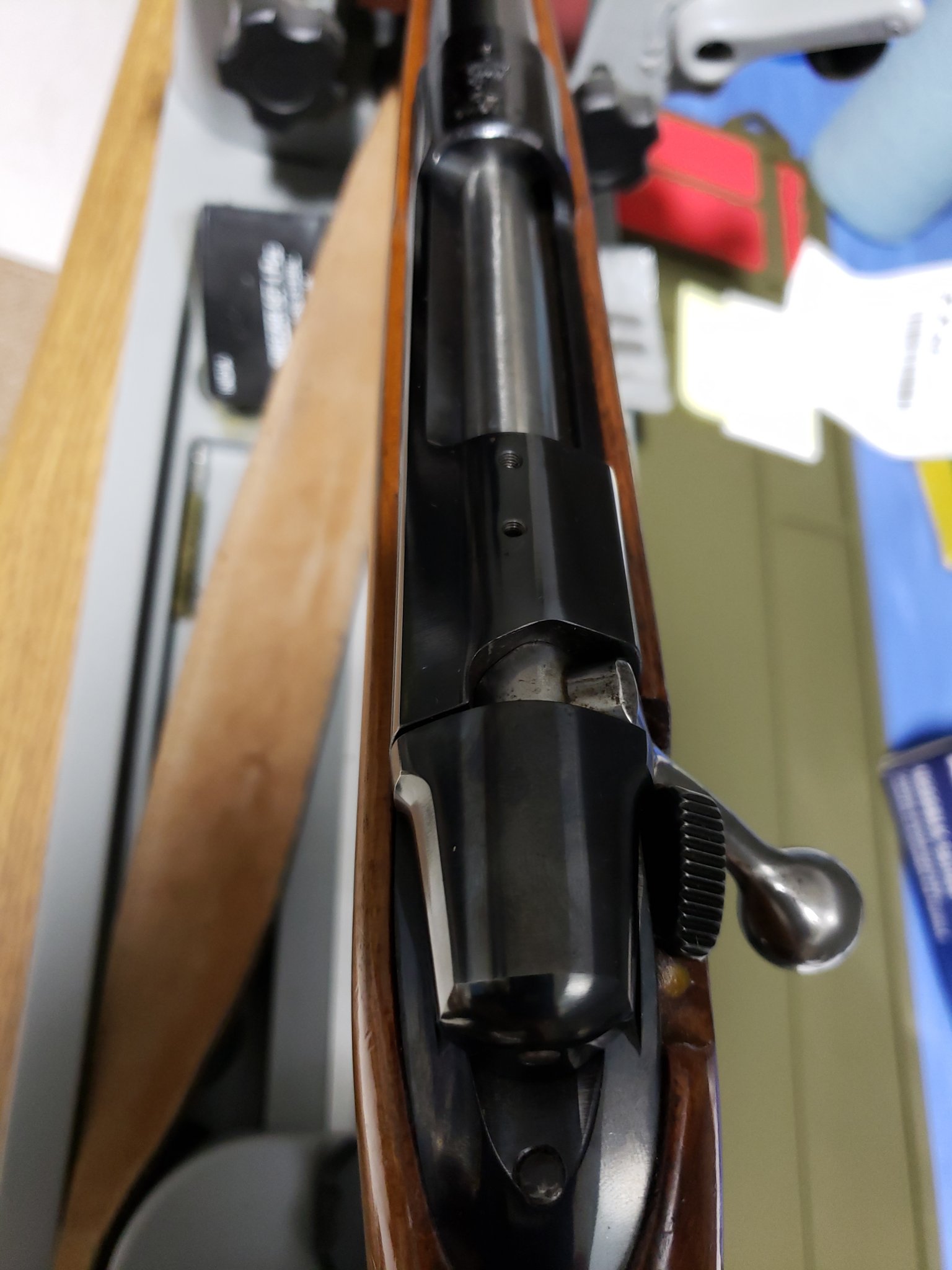

    I'm being told they didn't tap these at the Factory. But that this is after market work.
    If this was done aftermarket you may need to get the base with no holes and have it drilled to line up. I would bed the base because some old receivers were not consistent. They were not intended to have a base originally and many were hand polished thoroughly.

    I have never heard of a "Model 9000". Possibly the importer has come up with this designation?
    The 1600/1640 series, produced in large numbers in the 50's and 60's, are based on the M96 design with some elements of the small ring M98 but it is a unique design, with side safety (and no flag safety) as per your image. I believe the main difference between the two is barrel length, so no major (if any changes) to the action between the two.
    The 1651 series are the Magnum versions of the 1640 so I suggest you look into bases for those models and see if they may fit your rifle.
    Edit: Contessa appears to make a rail for the 1600 and 1900 series, Warne also has scope bases, possibly the M898/828M combo fits?

    Some commercial mausers had the rear receiver ring ground down and polished when they were converted to sporters. There was no standard for the rear ring geometry from factory to factory. So some bases do not sit with full contact, particularly on the rear ring.
    Depending on the grinding and the type of polishing technique used, yes hand polishing can remove alot of material.
    Often hand polishing metal starts with a file, then maybe stones, or emery cloth, then maybe to a cloth wheel with polishing compound.
    So it depends on who, when and how, the material was polished.
