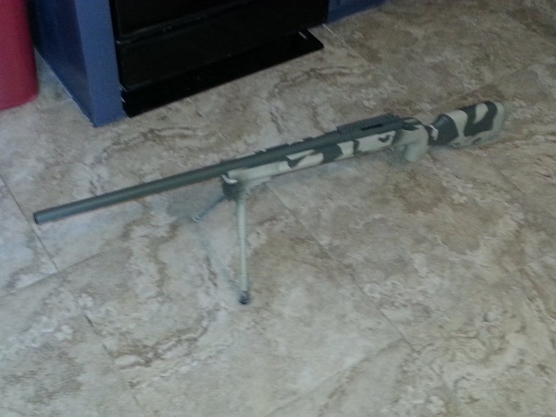

I'll second what Lash told you. I painted this one and it was pretty easy. It's a Boyds laminate.

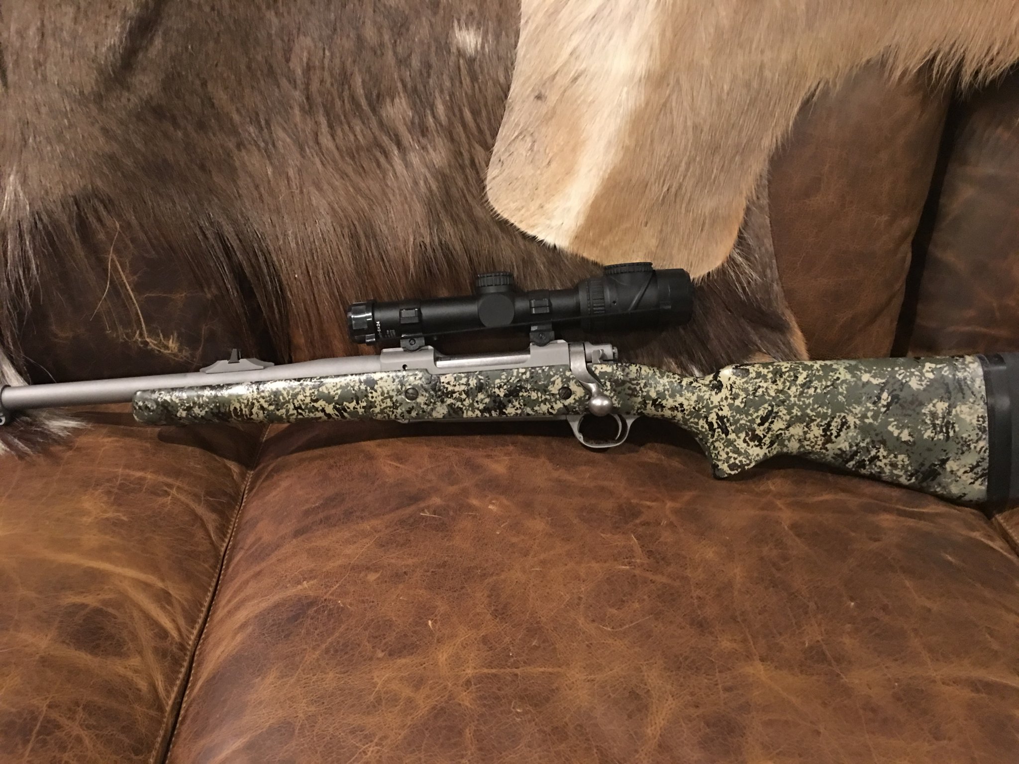

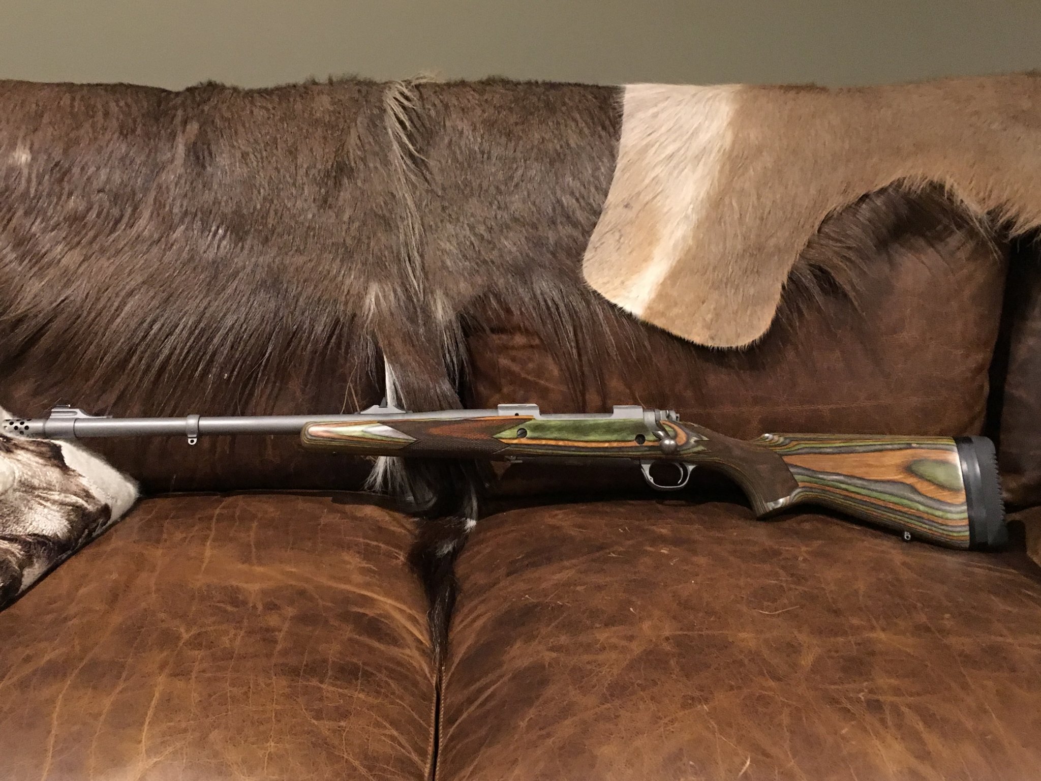

I figured I would follow up on this thread, since I finally picked up the rifle and decided to refinish the stock. As recommended, a good sanding, Some Bondo over the checkering areas that had been sanded down, priming and painting, and I am much happier with it. After finishing it, I decided that I wanted to add back some texture to the forearm and grip, so I remanded those areas, added some Marine-Tex, and repainted. Overall, a pretty easy job. Here are the before and after pics:
