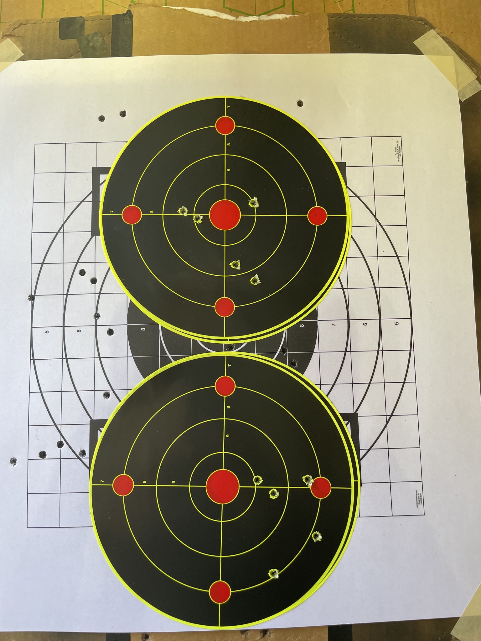

I’m having issues with the grouping of my rifle. I know something is wrong. The gun is a LWRC IC-DI 556. The optic im using is a Steiner T432 prism. I went to the range today with 90 rounds of Norma 233 55 grain FMJ. I was doing a 100 yard zero. I sand bagged the front of the gun. I torqued everything to manufacture spec and put paint pen on all points of movement. I’m not impressed with the groupings.
I’ve had the same problem previously with this exact rifle and optic setup. I first zeroed the rifle with spam can 55 grain Tula and basically had the same thing happened but just with a wider inconsistent spread that was a few inches wider,compared to Norma. With everyone’s experiences what’s going on with my grouping. Im having a consistent wide spread.

As for your rifle, that’s extremely unusual for an LWRC. I’ve had my M6A1 since 2009, and it has always been a tack-driver with anything & everything I’ve fed it, even cheap steel Tula 55gr.
I’d contact LWRC about it. It could be a rare lemon. Usually their QA/QC is one of the best in the industry, but anything man made can have hidden defects or issues. It could be a tolerance-stacking issue, barrel nut torque issue, or even a bad barrel or headspace issue. 🤷🏼

Change ammo. When you do try some heavier stuff. 55 fmj and that type of cheap ammo shoots exactly like what you see here.
A great gun shoots great with great ammo
A great gun shoots like shit with shit ammo
Start there
Check if the mount is cracked. The Steiner T series has a pretty low torque spec, and over torquing will crack the mounts.
Hand it to someone else there shooting small groups and let them shoot it. It could be you. It hurts to admit it, but sometimes it's the shooter. If you don't shoot ar's for groups quite often, those fundamentals slip away.

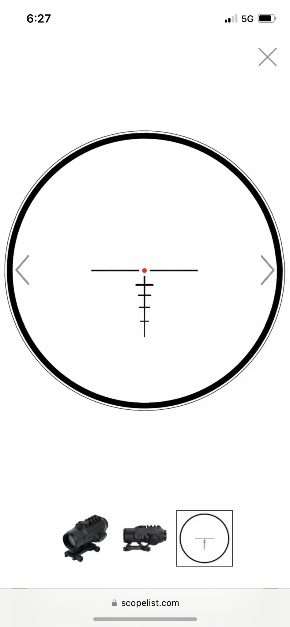

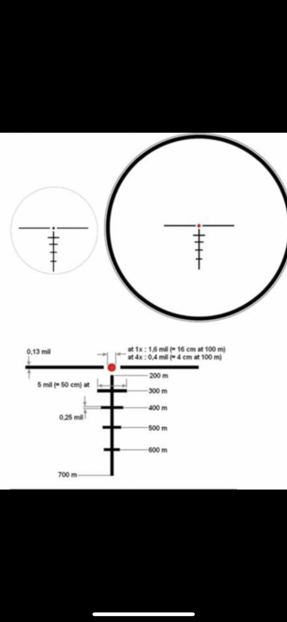

The owner’s manual directions. They said 100 meter zero. Would me zeroing at a closer distance fuck up the bdc on the reticle? I tried that previously with the Tula, And same shit. I’m not trying to be confrontational,I’m trying to learn.
There’s no reason to zero closer if you’re throwing that size groups at 100. Not accurate is not accurate at 30 or 300 yards. Unless it’s a fundamental issue your still not going to be satisfied
Reactions: Bridgebuilder34
Can also zero that reticle at 50 where the 200m point is...
Ah, BDC. Got it. and yeah, if your marks are based on 100 yds then yes, my understanding is that’s where it needs to be be.

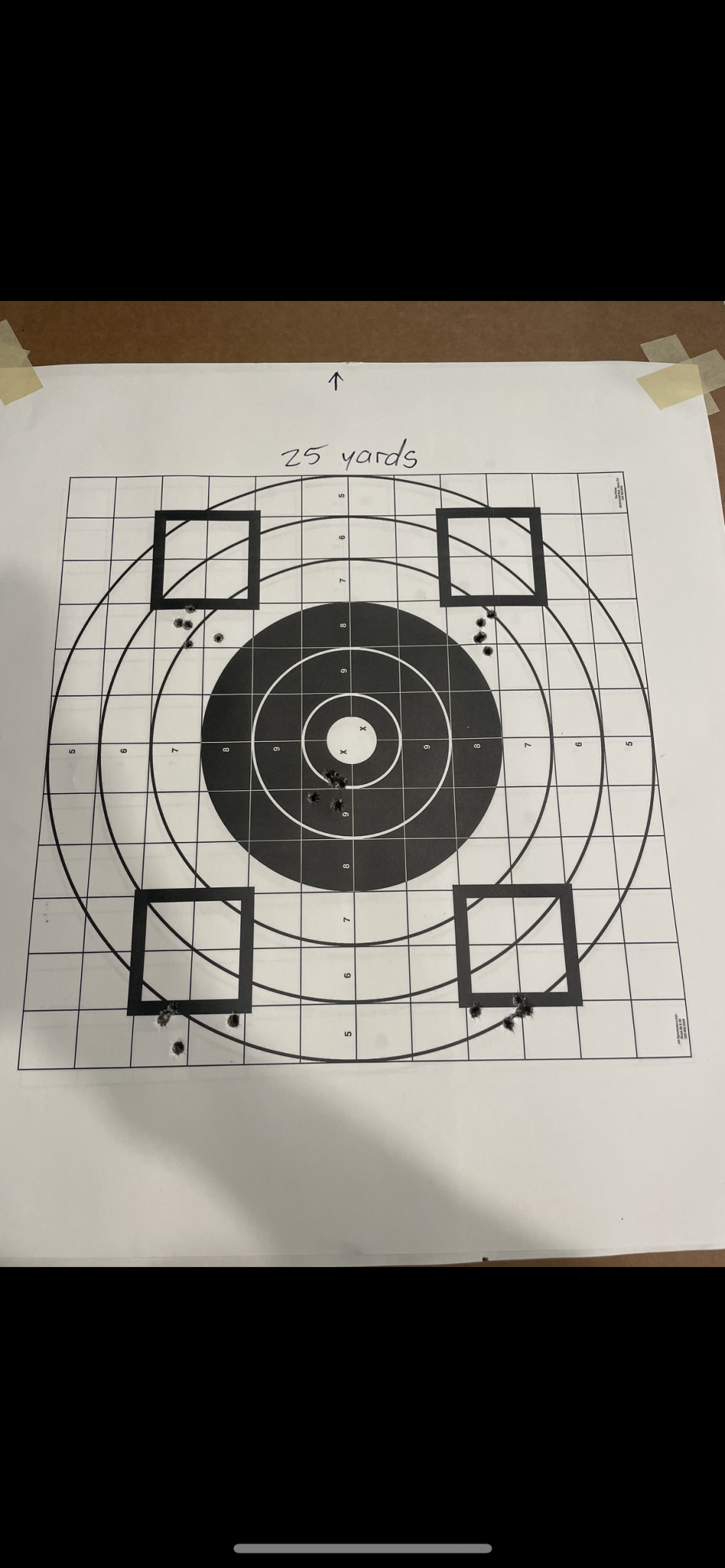

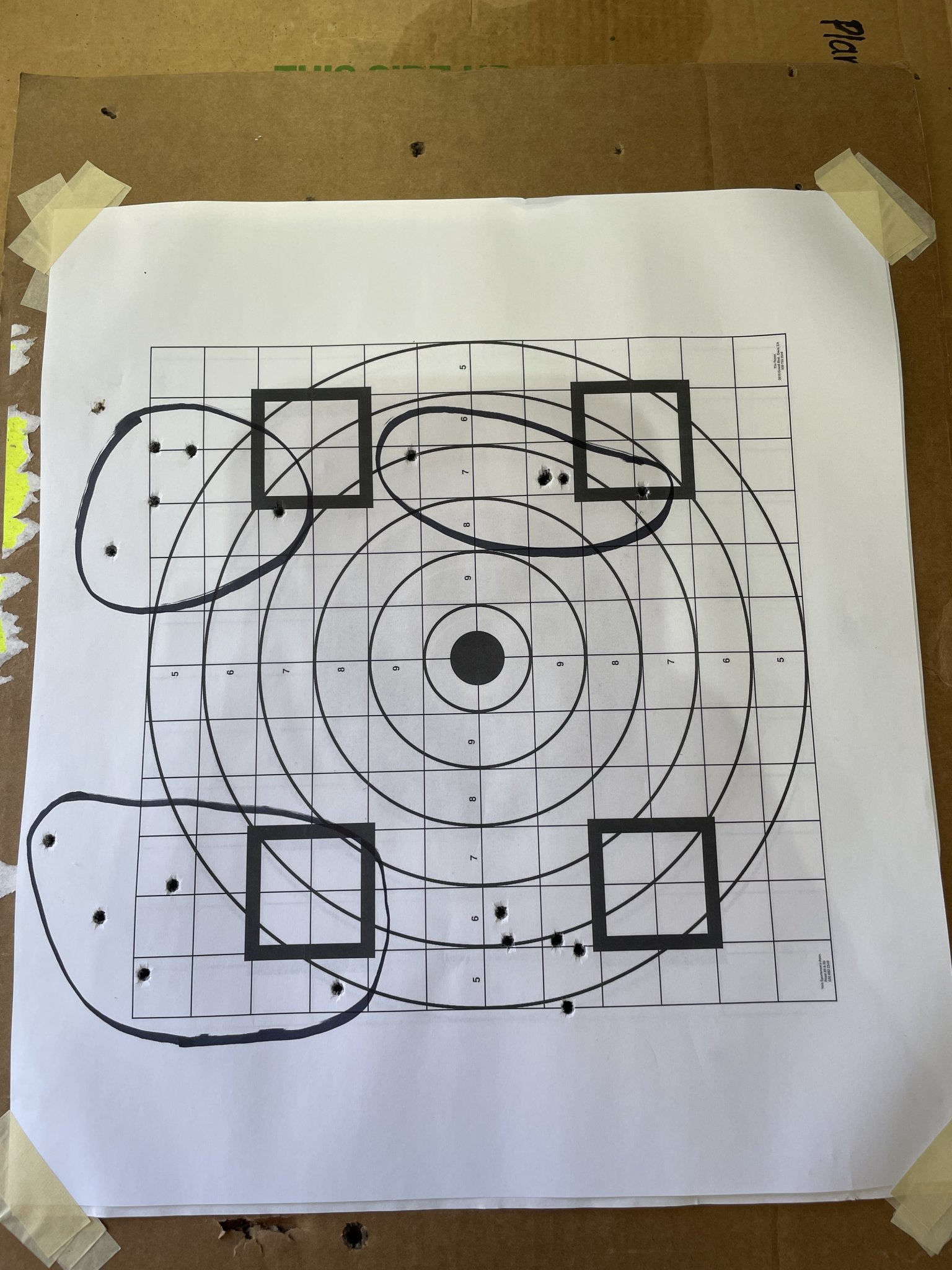

Here’s some targets at 25 and 50 yards. I started zeroing at 25 then I jumped to 50 yards. This was with Tula. At that close of range I’d expect rounds to be a lot tighter. Would you be satisfied with those grouping?
There’s no pics
See post 20 - if the answers to both my questions are "No" then buy or develop better ammunition and re-test.
Don't worry about zeroing at different distances - that advice made no sense anyways. Changing what range you zero at will not fix precision problems. If you weren't even hitting the paper, then moving closer to get on paper is an option, but you're already hitting the paper and close to zero'd. Just grab some known, good quality ammo and try it again, with a really solid shooting platform. A good quality front bipod, good quality rear bag, a known good shooter, and known good ammo are all needed to tell you if the gun or optic are the problem.
