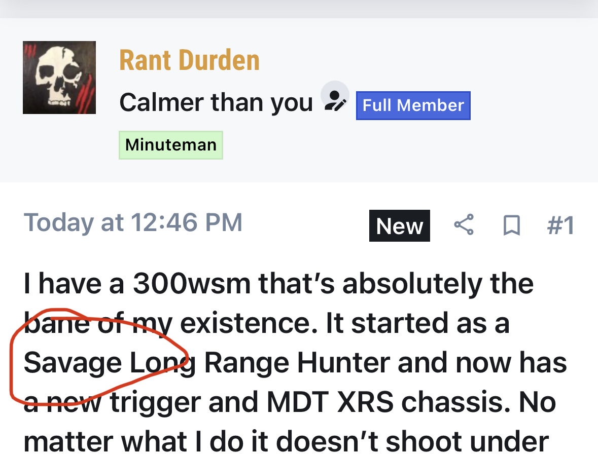

I have a 300wsm that’s absolutely the bane of my existence. It started as a Savage Long Range Hunter and now has a new trigger and MDT XRS chassis. No matter what I do it doesn’t shoot under 2”. I’ve tried multiple bullet, powder and primer combinations. Bullets from 150gr lead and copper all the way to 185gr lead and copper bullets. It like everything at least 50 thousandths off the lands.
My son and I each took a deer with it a couple weeks ago, but the shots were within 250 yards.
Im getting single digit SD’s and occasionally putting two bullets I. The same hole, but can’t get a really good group. I’ve had a couple shooters at my range have very similar results.
Factory ammo is worse.
Will moving further off the lands help?
Any suggestions are appreciated.

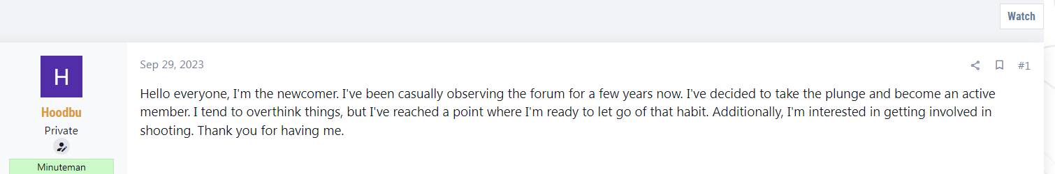

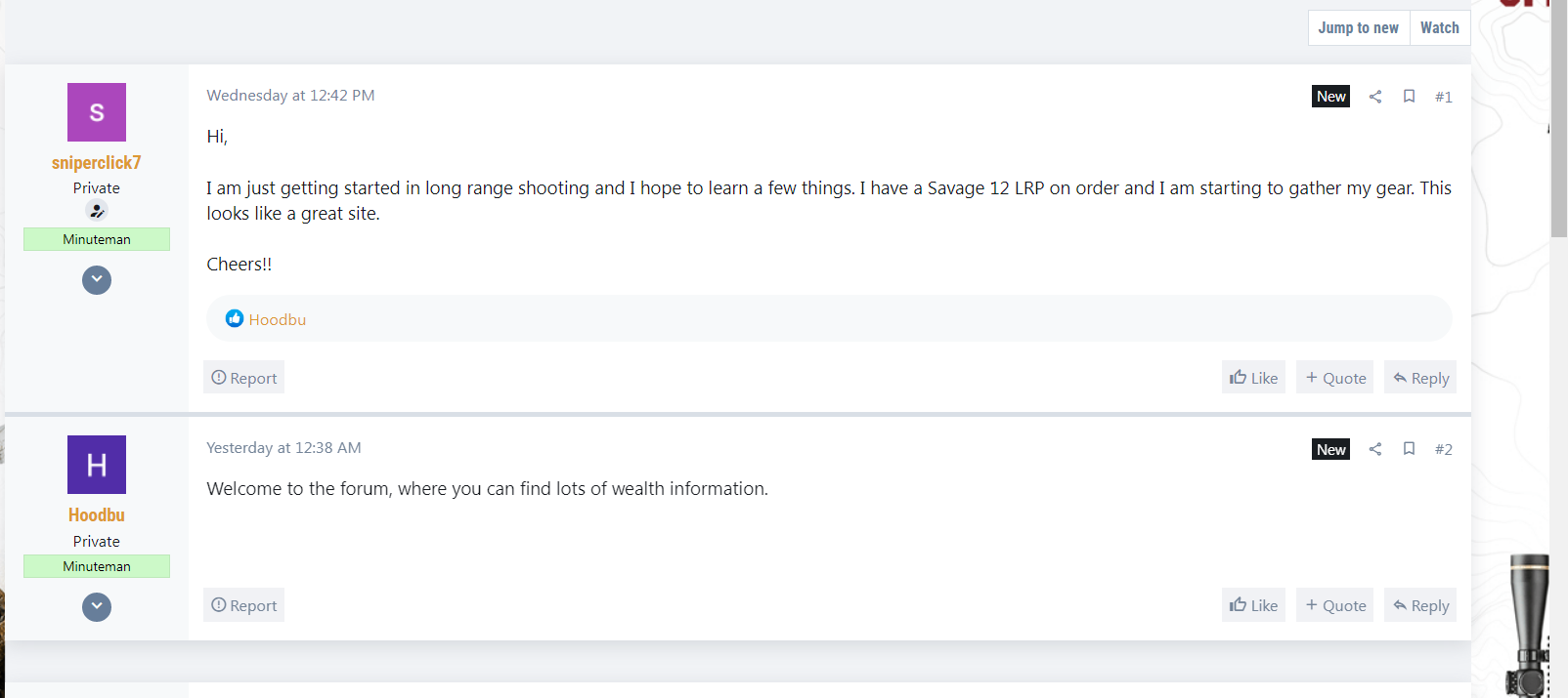

Is it just me, or do those two previous posts by Hoodbu and sniperclick7 (both very new members from LA) sound AI generated?
Yep. As of now, subtle clues are there for bots. Just wait until there isn’t. These 2 are pretty easy to spot when you look at post history.
