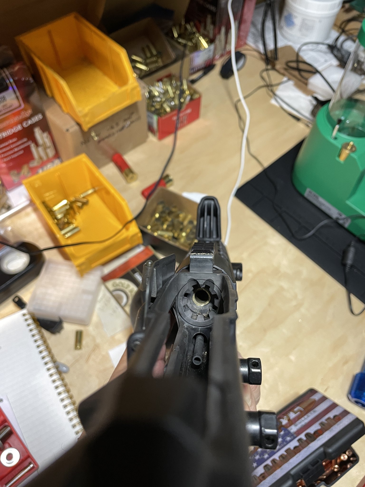

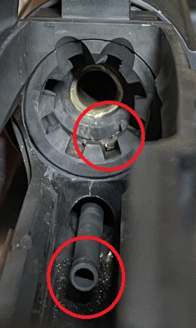

After 40 years of reloading, I think I finally screwed up ..... I think.

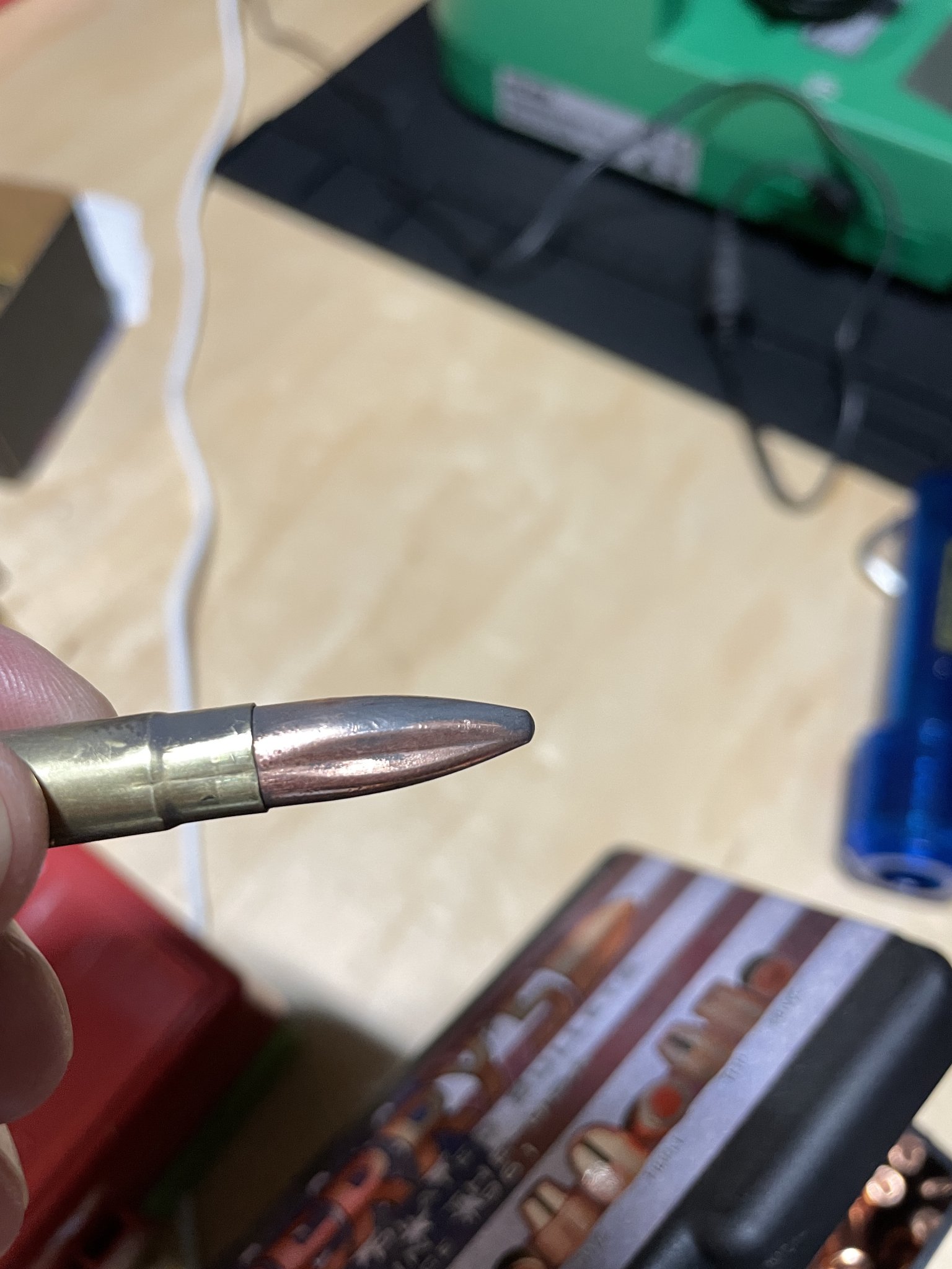

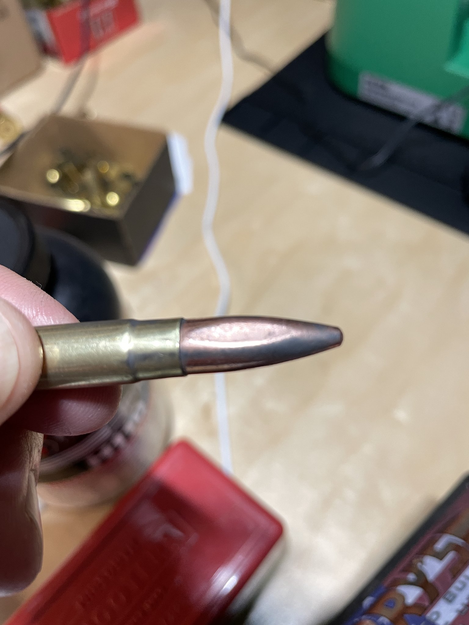

I was working up a new subsonic load (300 blackout) for one of my rifles, just a plain Jane AR15 that I've had a few years. I saw a load on Ultimate Reloader on YT and thought I'd give it a try. Berry's 220 gn plated bullets over 9, 9.5 and 10gn of H110, COAL 2.230", loaded 10 of each.
First shot .... BOOM! Thought I'd lost my hand! I rarely shoot with my left hand on the magazine but this time .... yep. It blew the mag to pieces.

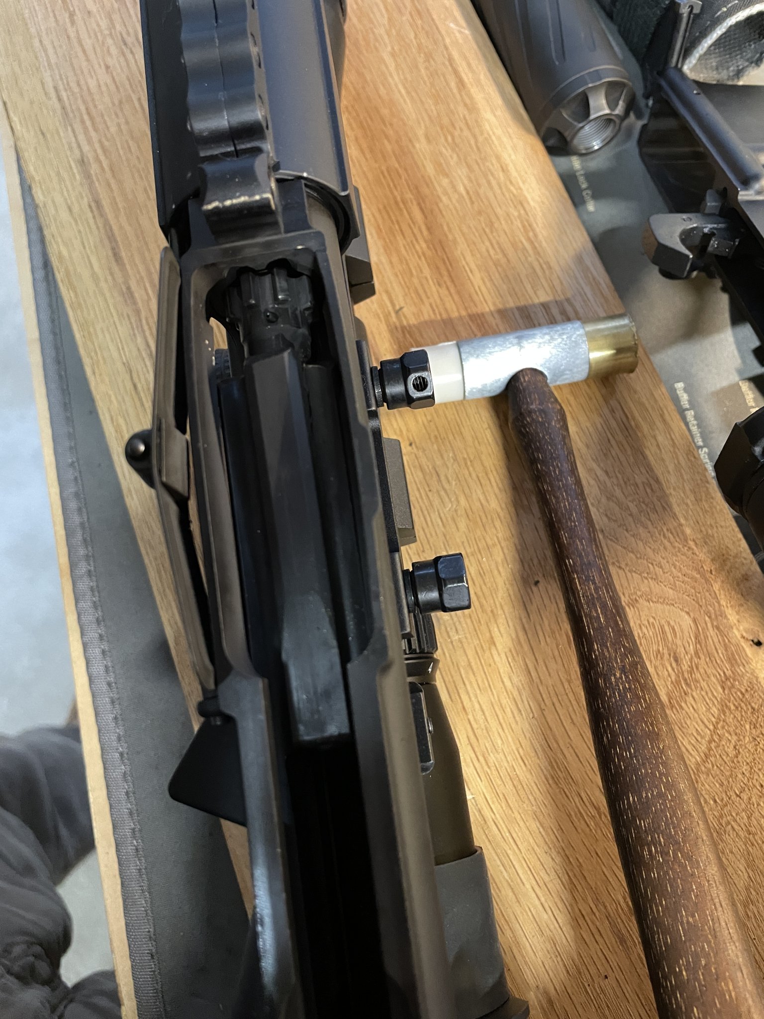

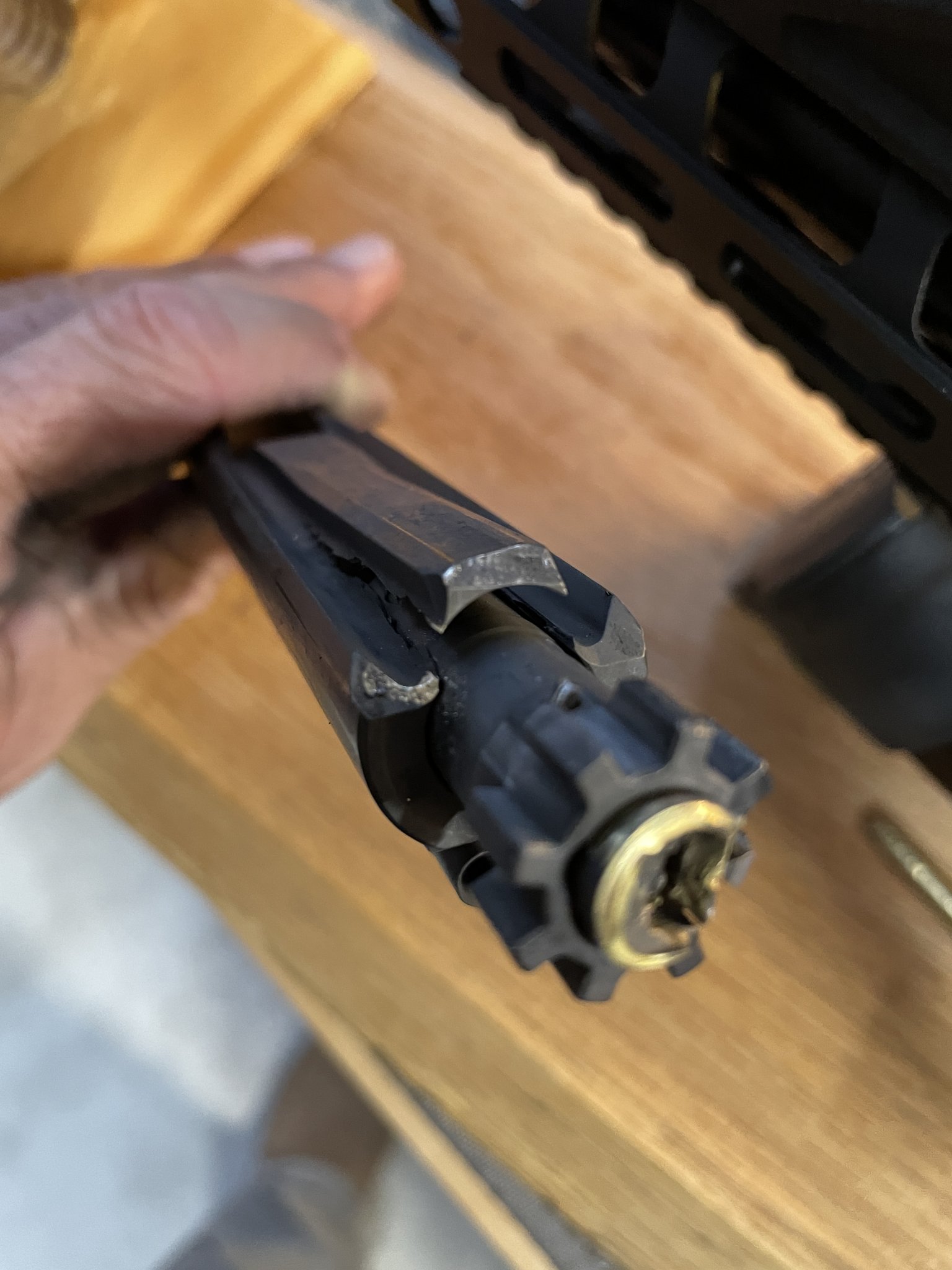

You can see in the photos that the case head is still in the bolt face (bolt and upper are toast), the rest of the casing is in the chamber. It sent the bullet and thankfully didn't blow up my suppressor.
I have no idea what happened. My first thought was a double charge, still leaning towards that. I pulled all the others I loaded today and they were all on the money so my powder measure was working fine. I've mic'd a random selection of the bullets, they all measure .308-.3095 (is that acceptable??)
Would a bad case (head separation) be so catastrophic? It tore the bolt apart!

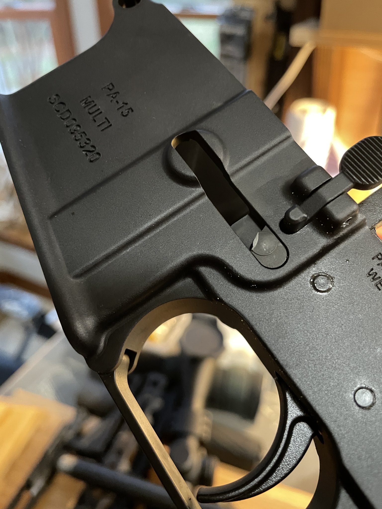

So clearly my upper and bolt are history, would you scrap the barrel too? The lower looks very slightly bulged at the mag housing and it broke the mag catch arm off but seeing as this component doesn't (normally) take any force, and you can by heavily skeletonized versions and polymer ones, I'm thinking I'll be ok to use it again, what do you guys think?
When I pulled the bullets I double charged one just to see if it was possible. It was, kind of. Two loads fit in but with a 220gn bullet it's a very compressed load and the round wouldn't stay at the set length, easing the bullet out a fair bit. It would still fit in the mag I think (didn't try) but I think it would have been noticeable in the box.
So, thoughts on what may have happened and thoughts on reusing the barrel and lower appreciated.

I can certainly see an out of battery explosion causing the mag to grenade, and even the case to separate but tearing the bolt apart?? Mind you, the bolt head was in the extension but not locked .... I don't know, it's weird.
My BCG looked almost identical to the pics in the OP... so yes.

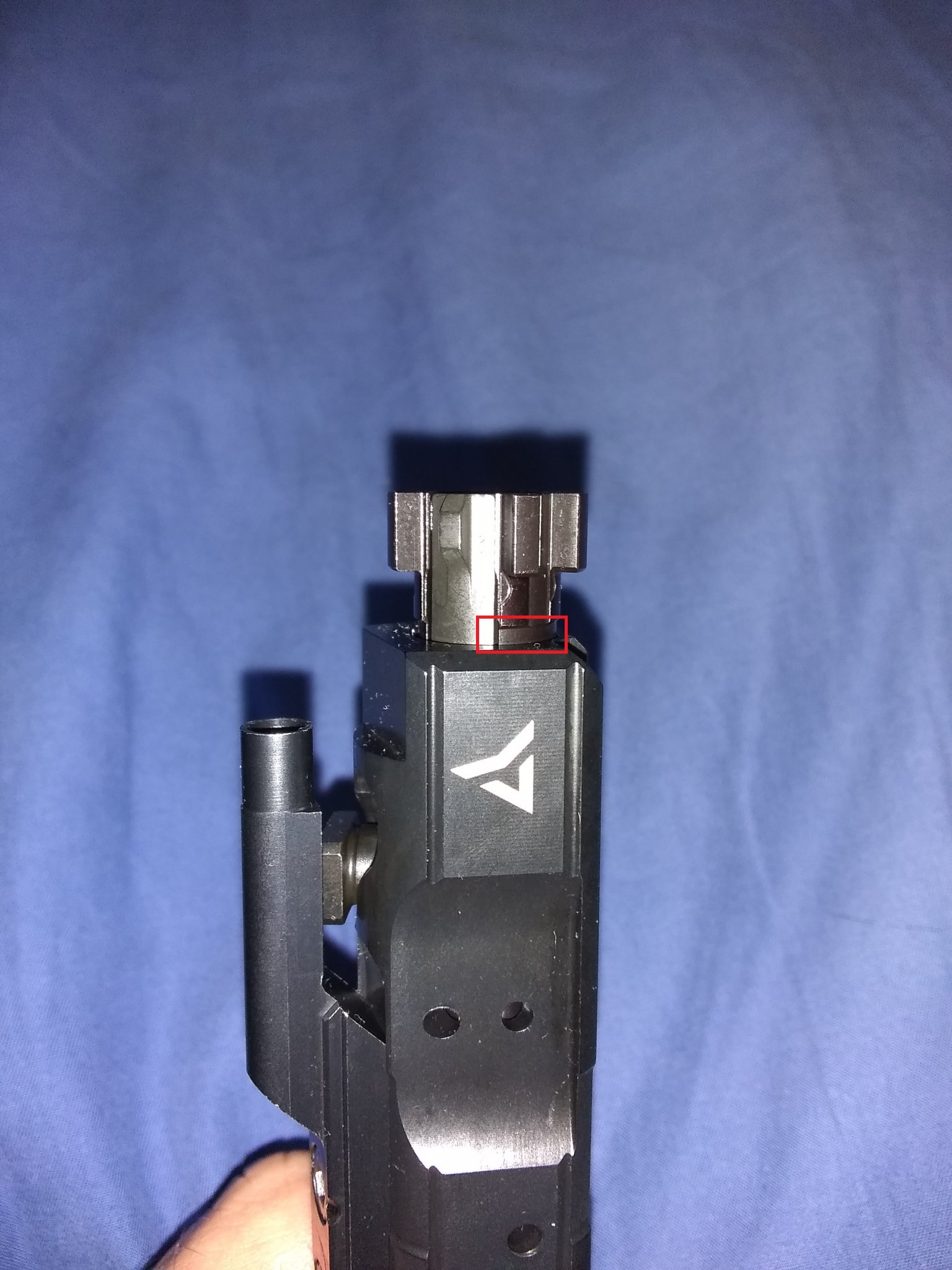

The answer is no. "Far enough forward" yes. Completely, no. I am holding in my hand a brand new Radian BCG that has never been installed or fired. If you hold the firing pin in and push on the bolt, there is a slight amount of play that makes out of battery most definitely possible. It's not a matter of 'in spec'.
In general, what you said is correct. In concept. In reality on almost every BCG there will be a small, very small area where this is possible. Take any one of yours and test it yourself.
Another way to test is to push the bolt all the way in. Then push on the firing pin. There will be a small amount of space...a mm or two where the bolt moves. That little gray area is what makes out of battery possible when using bad brass for example.
One image is the bolt fully closed all the way. The other image is when I push on the firing pin. The gap there is maybe 60-70/1000.
Anywhere in between there the firing pin can make contact with the primer.

What happens, as was my case, when you have a bad piece of brass there is substantial drag when the round is being chambered. This not normal friction pushes the bolt to the rear, but as I show in my pictures, the firing pin protrudes enough to strike the firing pin in BOTH of those positions.
It can in essence pre-maturely rotate the bolt as well as the firing pin extends out enough to strike the primer anywhere in that 'tolerance' pictured.

Notice the bolt is still rotated in both your pictures meaning it's locked in place. Where the carrier is relative to the bolt doesn't matter. Bolt face stays in the same spot and locked. Any further back where the bolt unlocks, then the firing pin can't reach. Further back and the firing pin can't be hit by the hammer.

Ah I see, on a couple of mine I checked it can technically be out of battery as far as the bolt carrier is concerned, but where the bolt begins to rotate to unlocked, there the firing pin can no longer protrude from the bolt. I’m not an armorer or educated on this so I must be misunderstanding the cycle or fitment or operations.
In a normal situation the lugs lock up into the barrel extension via rotation. Not a lot of rotation, but enough rotation. When that rotation happens too early (because of bad brass hanging up in the chamber) it causes a problem. And as stated the firing pin protrudes enough to contact the primer in both positions in my pics.
