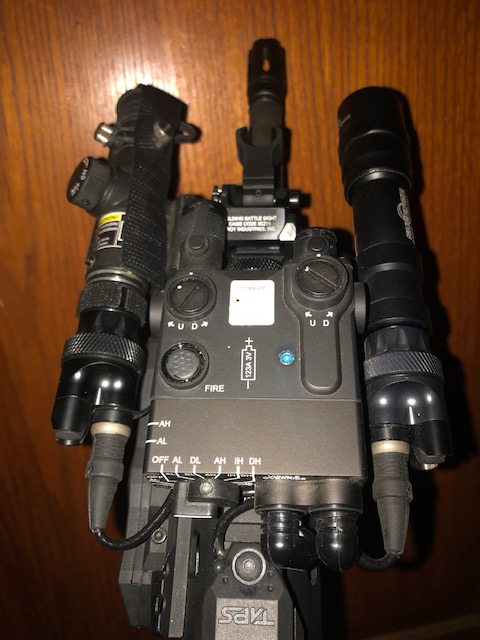

@aslrookie Here is you an option. Civi Dbal A3 married to a Luna ElIR-3 on left. One press of Untiy Taps Pro button lights up Illuminator and IR Point together. This setup mimics pretty much what a PEQ LA5 B will do. All in costs setting this up is about $1,750 ish. Will save you about a $1,000 bucks. It will smoke a Mawl in performance. :LOL:

Yes it does. The Luna will way outdistance the D2 illumintor and focus much tighter. However the D2 is not a bad unit to have. But here is the $64 dollar question. Just how far out is a person realistically gonna use a LAM to shoot.
I personally like the Civi Dbal A3 but its got a denutted Illuminator so I fix that with a Luna. The Dbal A3 is the only MFLAM I am aware of that has an Override Vis Point feature to instantly put you to Vis Point and White Light if that is something you value.

Now the way I set them up. The Luna is slaved as an Illuminator to the Dbal A3 IR Pointer. One press and both come on. I can assure you it is as fast as any system out there. Actually faster in some ways if you really want to tailor your Illuminator beam for site specific distance and ambient lighting conditions.
The Rheostat for power adjustment and the Bezel on the Luna are super easy to adjust due to them being more accessible and slightly larger than most most full power units.
I do wish the Luna ELIR-3's were made out of aluminum. That is the only upgrade I see that would make them better. But Insight/Eotech makes their MFLAM'S out of plastic as well and having to put a plastic tie strap (comes with the PEQ kit) over a MFLAM just don't cut it with me.
