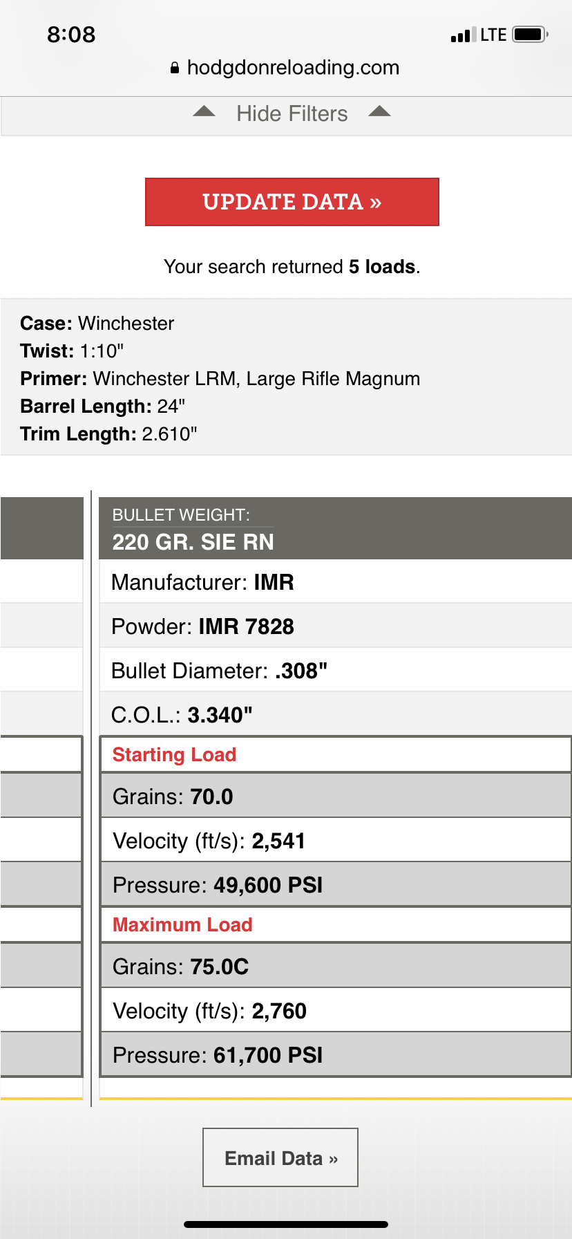

    Was going through some of my notes and founds this:
    .300WM
    Powder: IMR7828-SSC
    Primer: WLRM
    Brass: Nosler
    Bullet: 220gr SMK HPBT
    I have never loaded or shot this combination of components and for the life of me can't remember when or why I wrote this down. Does this load make sense?
    It might have made sense in 1993. Shooting that bullet now would be super retro! I’m talking about the 220 SMK, not in the round nose shown below
