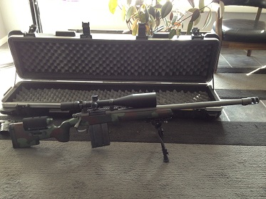

Here's a pic of my .300WM.
Trued up 700 action. Rock 5R 1:10 26" AMU/MTU profile bbl. McM A5 w/ Badger M5. Badger 20 MOA base & NF tall rings. NXS 5.5-22x56. FTE brake or Gemtech Sandstorm. It's a fatty boob-a-latty. Pushing a moly'd 225grn Hornday HPBT at 2880fps with 7828SSC. I shot the cup with a 208 Amax.

That cup rifle weighs 19+ lbs.? My 6 Creed goes 16+ and has similar components, of course you can see them on my signature. Did you add weight to it? Lead?
Yup. 19lbs. Think I weighed it with the bipod and sling, no ammo. It's a tanker. The NF rings are steel. Badger base is too. Didn't add any lead that I know of :-/
