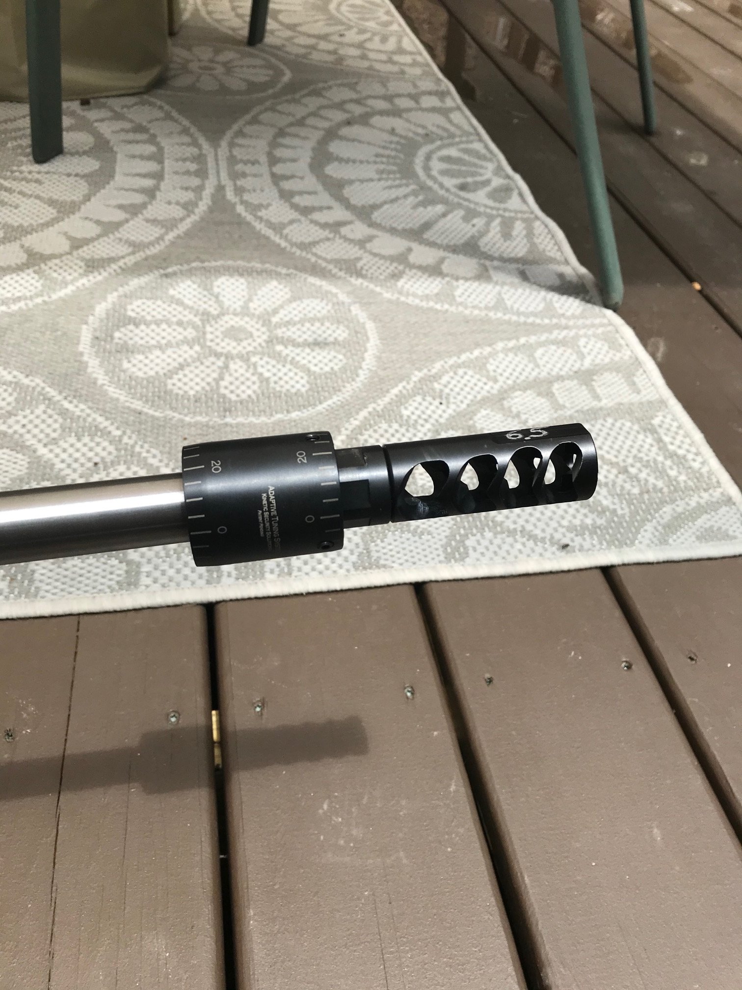

The new tuners like the Kinetic Security Solutions ATS are not like the BOSS. Same basic idea but you can use them on any barrel that is threaded but with your own choice of brake or suppressor. Even Aaron said he didn't come up with anything new but just made it easier to use. Just screw it on and then put your brake or thread protector on over it. Simple. I have one of the ATS tuners and it works as advertised. I put it on my 6.5 Creedmoor and tuned it to factory 140 ELD-M ammo and it shoots. Easy to tune in also. Below is a pic of 5 shots using a 6th bullet hole as the aiming point.

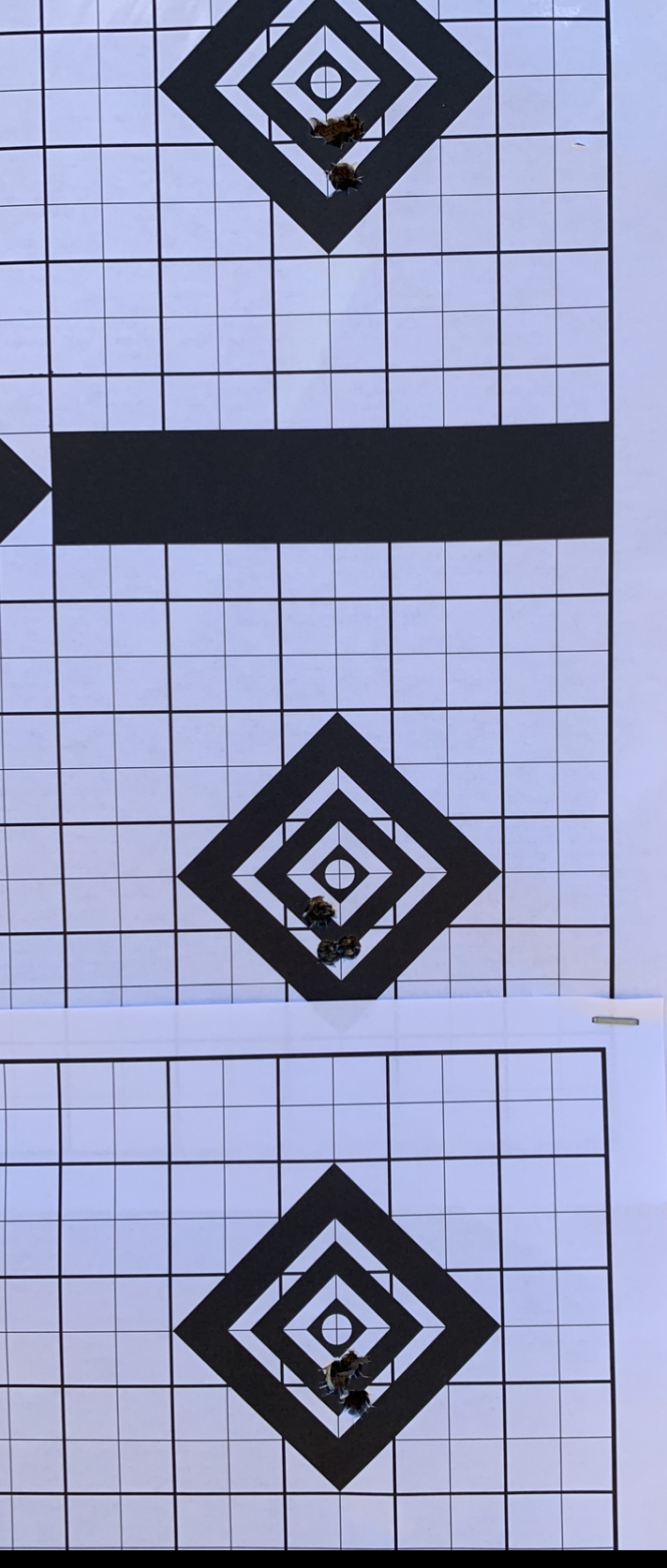

Here is 3 settings on the tuner. Went from .4-.5moa to .3moa.
Doesn't sound like much, but that’s 20-25% better. I’ve seen it do similar things like bring factory ammo from 1 to .5moa.
For prs loaders, the benefit is less range trips and less seating depth shenanigans to get to easily acceptable results for the targets we shoot. If you have 100yds out your back door, might not benefit you. If you have to drive an hour, you’ll benefit greatly. Or if just lazy like me.
