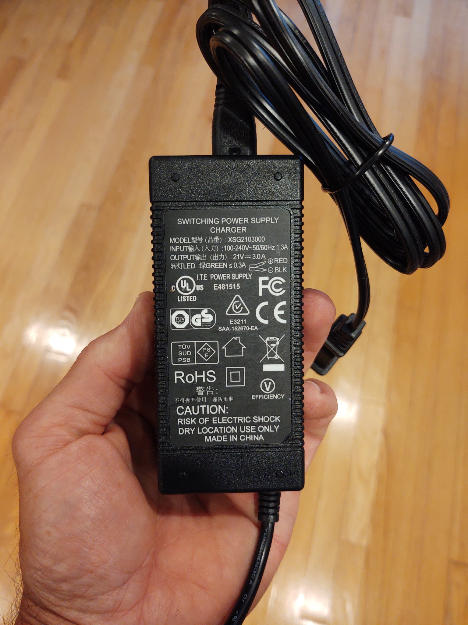

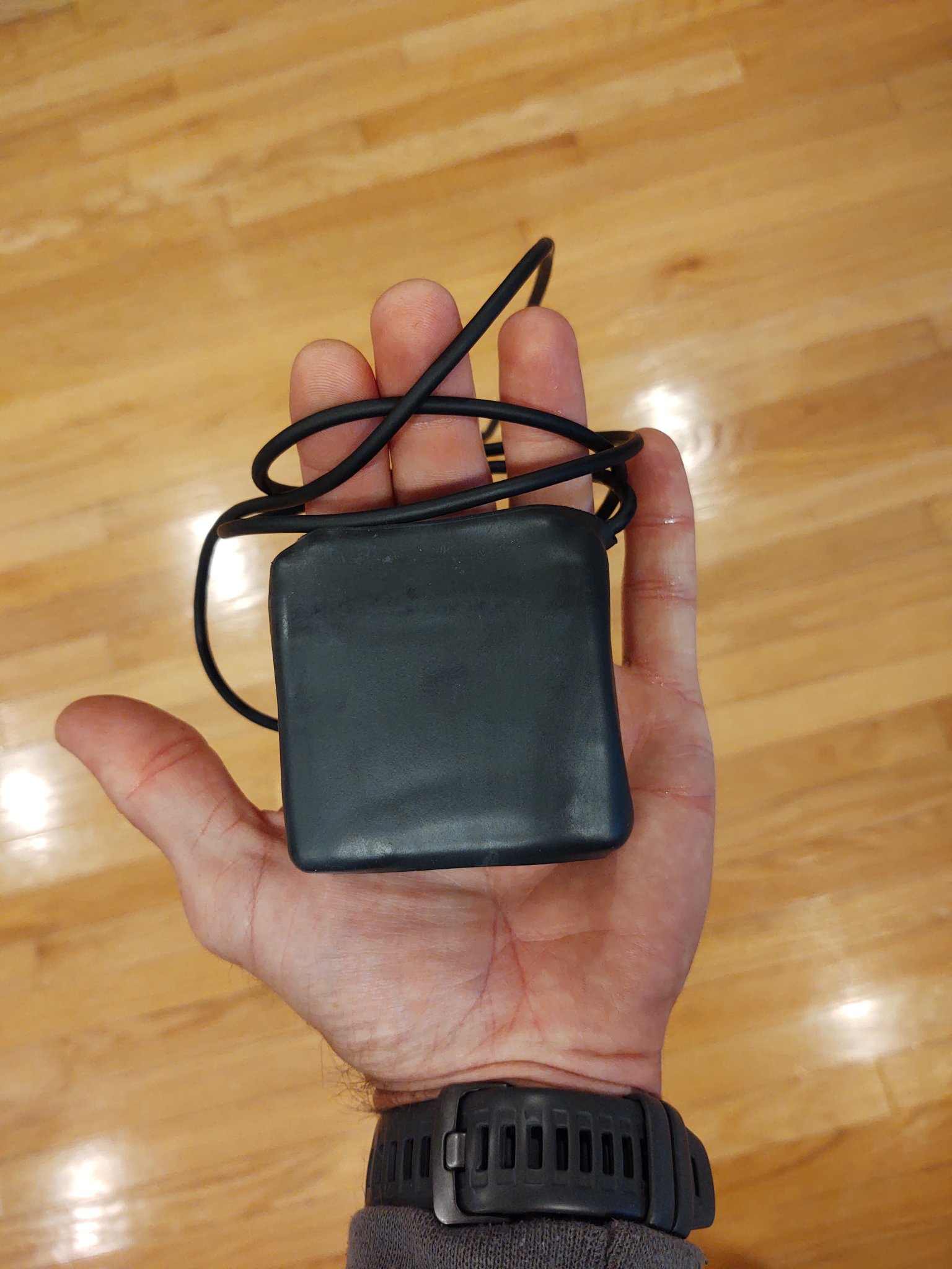

    That is a lot of great info guys. I am trying to make a 2nd battery pack for my light as a spare for the day my original dies and in case I forget to charge a battery pack / have a multi day ride or event. I need to keep the battery pack as small and light as possible as I carry it in my jersey pocket which also makes me want to keep it somewhat soft sided (no hard plastic corners). I will post up a picture o my current one (although it is wrapped up in shrink wrap) and the charger.
    I found the owner of the company who originally made these systems and sent him an email which is where I got the specs. I have since asked him a few follow up questions but I have not heard back from him so I thought I would reach out here. Here is the replay he sent me:
    “Battery packs are 18.5v li-ion 4300mah you can pick up from multiple places. Smaller cells are possible for a smaller pack, but you have to maintain the voltage to work with the safety programing. Unfortunately unless you are local to the DFW area shipping batteries on an individual basis is a real pain so probably not feasible.
    You can buy the connectors from Switchcraft
    Funny enough they started making these after I ordered a ton of custom ones
    Switchcraft : Product Summary
    Those are the two pieces that normally would fail/degrade so should keep you running for a long time.”

    If its just 18650 cells inside that wrapping, it's not likely a true 4200mAh. There's a ton of inflated capacity numbers out there. It is possible that the builder used a larger size cell. These: https://www.batteryjunction.com/sanyo-ncr20700b.html will give you a slightly thicker package, but will get you to your 4200mAh

    We charge with a DC to DC charger the Icharger X6 with a 24V DC power supply (old laptop power supply) Which is nice as you could charge off the 12V DC truck power if need be.
    There are other simpler chargers that are less expensive also. With all LI-PO's you must balance charge.
