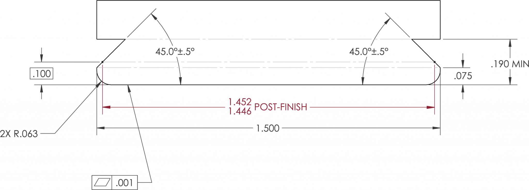

ACRA isn't really standardized so there's going to be variations between manufacturers. RRS has their own specs.

there is the RRS standard
everything else is out of spec as far as im concerned

ARCA Swiss isn't a standard. It's a general form that is roughly a 1.5" dovetail. If everybody made rails to the same standard all clamps would fit all rails. There are other companies that make their rails to the same rail standard.
The problem is that for a long while alot of companies were reverse engineering rails from each other and making up their own tolerances. I believe some were also extruding them. That is fine if tolerances are correct.
Rrs decided to try to get everybody working from the same dimensions. It is still an arca Swiss rail but it is more controlled. They even make it easy to find.
If your rail made by whoever matches these dimensions, it will work.
