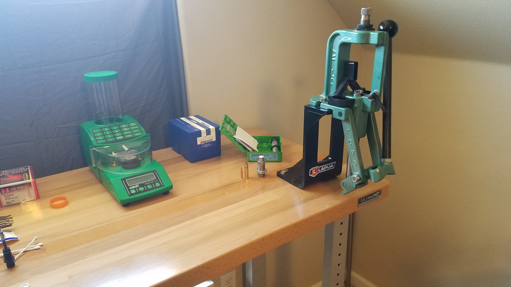

Here is the elevated mount that I built.

Here is the elevated mount that I built.View attachment 6955987
That's what I need for my BFR but I don't have the stuff and it's a 100lb. press.

The inline fab mounts get a lot of praise and are very reasonably priced.
The one pictured that I built didn't cost me anything other than a little time, it is made from 3/8" 516 G70 and gusseted top and bottom with 1/4" A36 plate.
Kind of overkill but the price was right.
