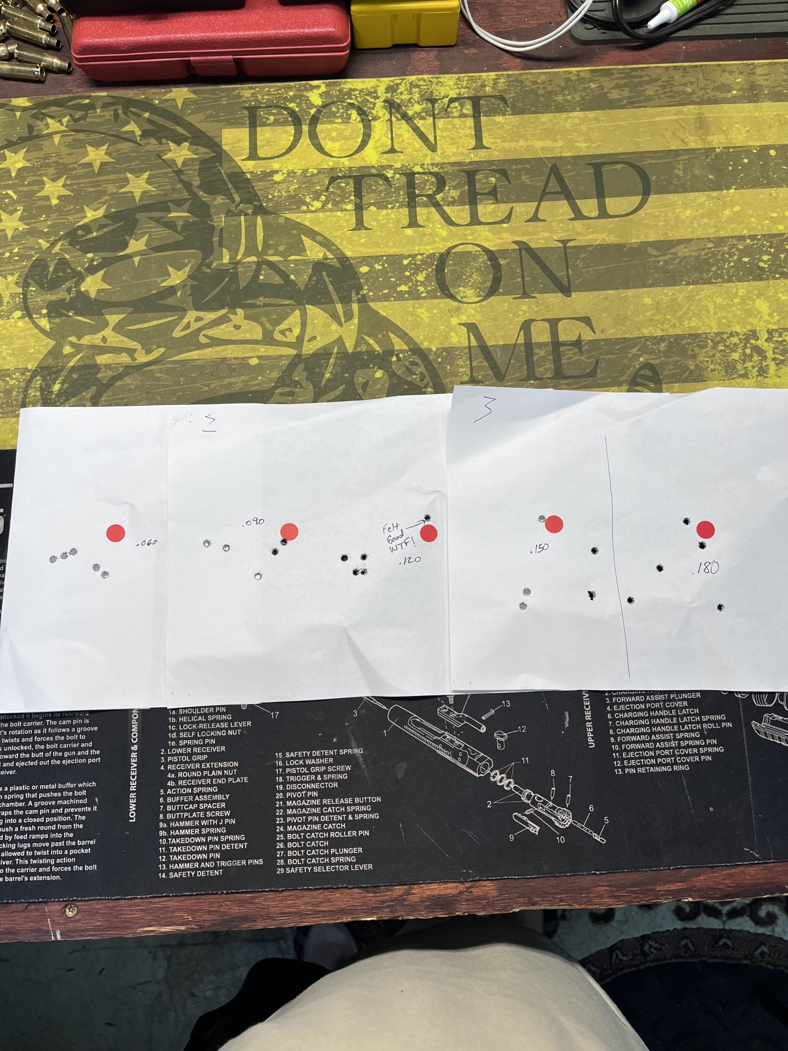

    So I have over 400 rounds on this barrel and I cannot find a load for it. Gave up on the 75 ELD and still not having any luck with Berger 85.5. I’ve found my velocity node and carefully weighed each load of varget to the kernel. I tested a bunch with the base of the bearing surface at the neck shoulder junction and had no luck. So today I tried Berger’s suggestion intervals and groups still look like shit. Pics below of .020, .030, .045, and .060 off the lands.
    This barrel has a .100 freebore and at .020 off the bullet is barely in the case. Never had much trouble before finding a load but this thing is really frustrating me. I don’t know where to go next.
    Also to add. I shot 10 rounds of 77 gr Fed Gold Medal through it. One group was sub .6” the other was sub .5”.

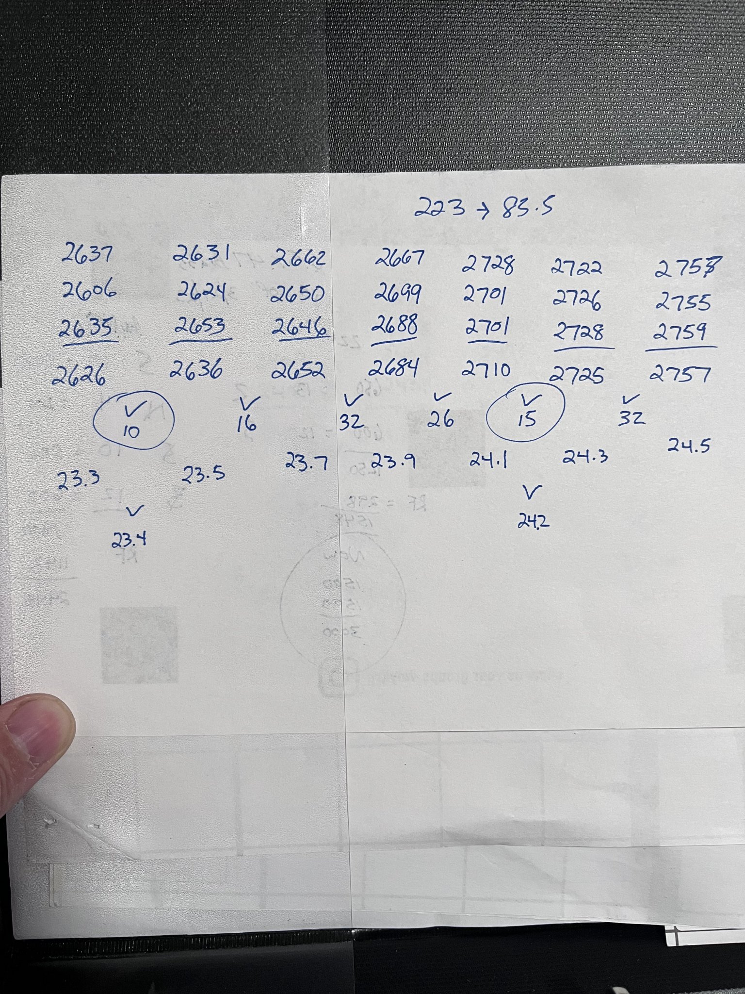

    I start out by shooting 200 rounds of break in. Then load 21 rounds/ 3 each at .2 grain intervals and shoot over magnetospeed to find velocity node. Below is for this barrel. I’m currently loaded with the 24.2 charge to test these seating depths.
    I’ve used this method with the last six barrels I’ve loaded for and never had an issue until now. I can’t remember the seating depths I tested with the 75s but I was a lot. Almost 3 boxes worth of bullets. 85.5s I’ve done .20 off all the way out to .080 off. Almost every group has been 1.0”-2.5” with either bullet for only 3 rounds.
    I start out by shooting 200 rounds of break in. Then load 21 rounds/ 3 each at .2 grain intervals and shoot over magnetospeed to find velocity node. Below is for this barrel. I’m currently loaded with the 24.2 charge to test these seating depths. View attachment 8146421
    Looking at the spread on 24.1 vs 24.3 and 24.5 you might take a look at 24.3 - 24.5 again. Sure the difference between averages might be larger but both of those have small spreads over the 3 rounds you fired, smallest spread of all the loads you tested. Might be worth checking 24.7 as well.

    Use the charge with a velocity you're happy with. If you're happy with what 24.3 - 24.5 of varget did, that shows some promise and a lot of other shooters end up in that area. If you want a different speed, pick a powder charge that will give the desired speed.

    Here is how I load for 223 and it has worked more often than not.
    I start by loading to the lowest SD I can get. If your SDs are excessive you are going to have high/low misses at distance. Once I have a load with single digit SD's I shoot groups. If they dont shoot acceptable I will load a batch a bit long and start reducing OAL until the groups tighten up. I carry a handheld press to the range to make changes there.
    And something else that is AR specific. An adjustable gas block can change your group size and location on the target. On more occassions than I can count just adjusting the gas system resulted in a change in the groups, either size or location. I had one gun that would shoot miserable 50 yard groups, at 100 they were even worse. It was a bit over gassed and when I turned the gas down it was ~moa at 100 yards with handloads. Nothing else was changing between groups other than turning the gas down.

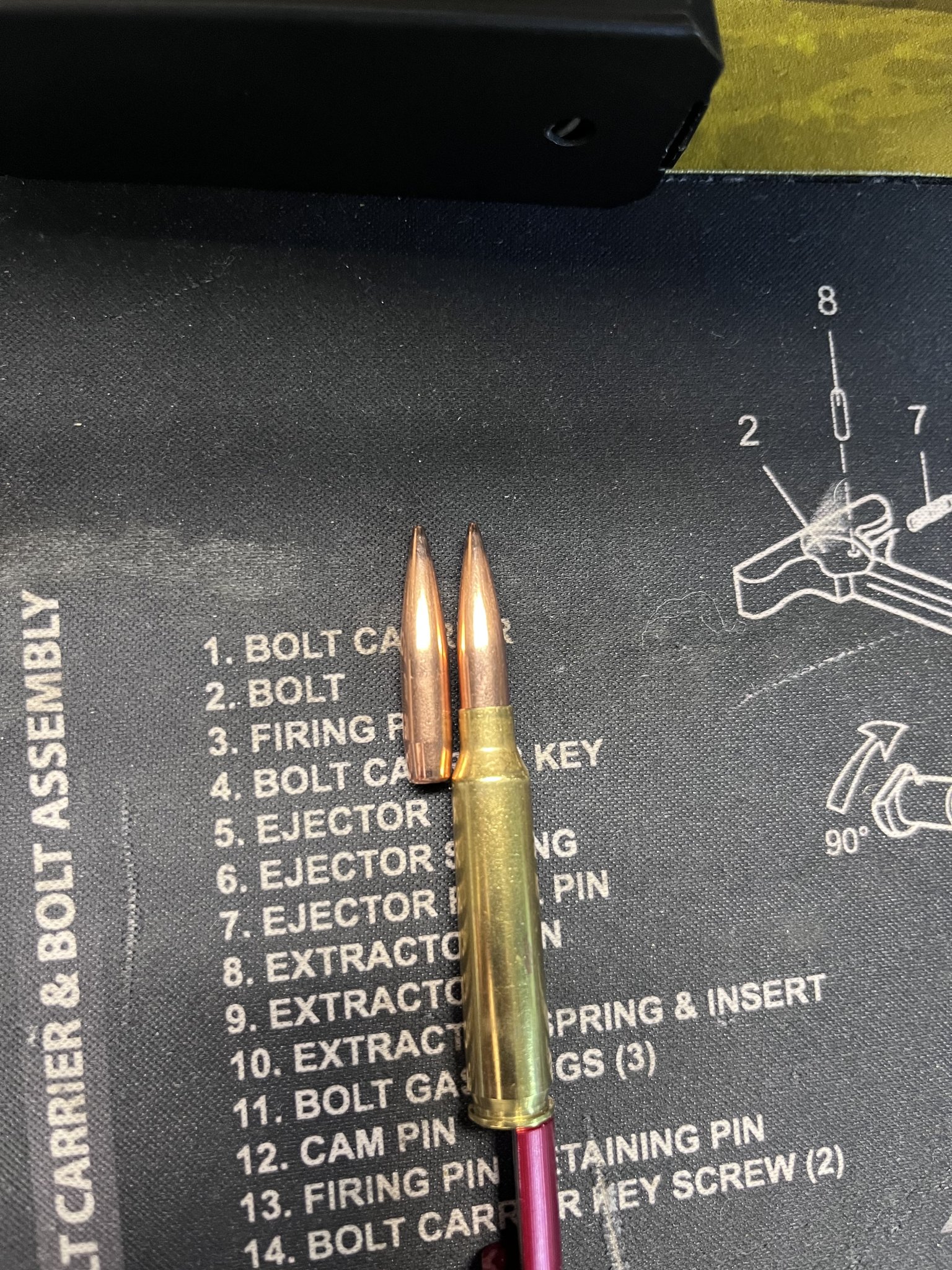

    Does this look right? This is 85.5 Berger to the lands.
    I'd push the bullet in the case at least until the neck was completely within the bullet's bearing surface. I'm not convinced having the base of the bullet below the shoulder junction is the cardinal sin it's often purported to be.
    Whatever amount of jump that ends up being, even if it's more jump than you're used to, I'd at least give it a try... might shoot.
    While I certainly agree that you want as low a deviation as possible I find it reasonable if I'm able to keep my spread at 15 fps or lower. I also find that it is easy enough to achieve this.

    Your throat is pretty short for the 85.5. If you want to shoot the heavy bullets you’ll need to ream your throat to .169 so you can get a long OAL of at least 2.55. This gives you enough room for powder. I started running CFE223 to get my velocity up to 2850.

    I am going to go against the grain here. The majority of your groups exhibit satellite grouping, except for the one labeled 1.220.
    IME, usually pressure or fitment. Doesn't sound like pressure in your case, but I would loosen and retorque the action screws, make sure the barrel is free floating. If I question action to stock fit, I put a pc of paper under rear tang and tighten the front screw, if you can pull the paper, the action is getting torqued, maybe in a non productive way. If so, I would bed the action.
    Your best numbers were 24.3 & 24.5, I would revisit these along with 24.4gr. If all else fails, seat a bunch long and take your press to the range and find a depth.

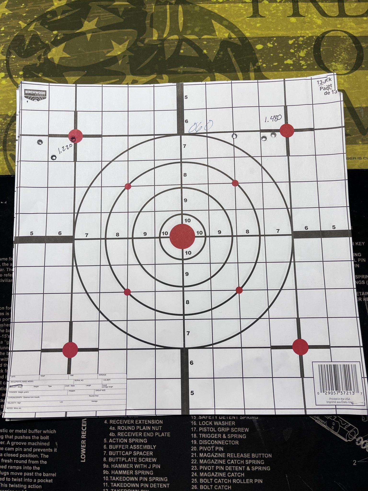

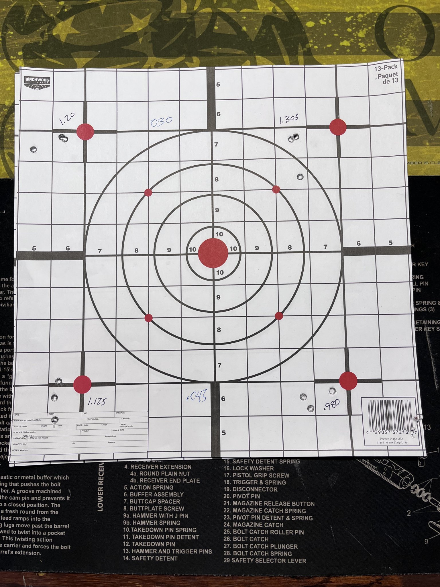

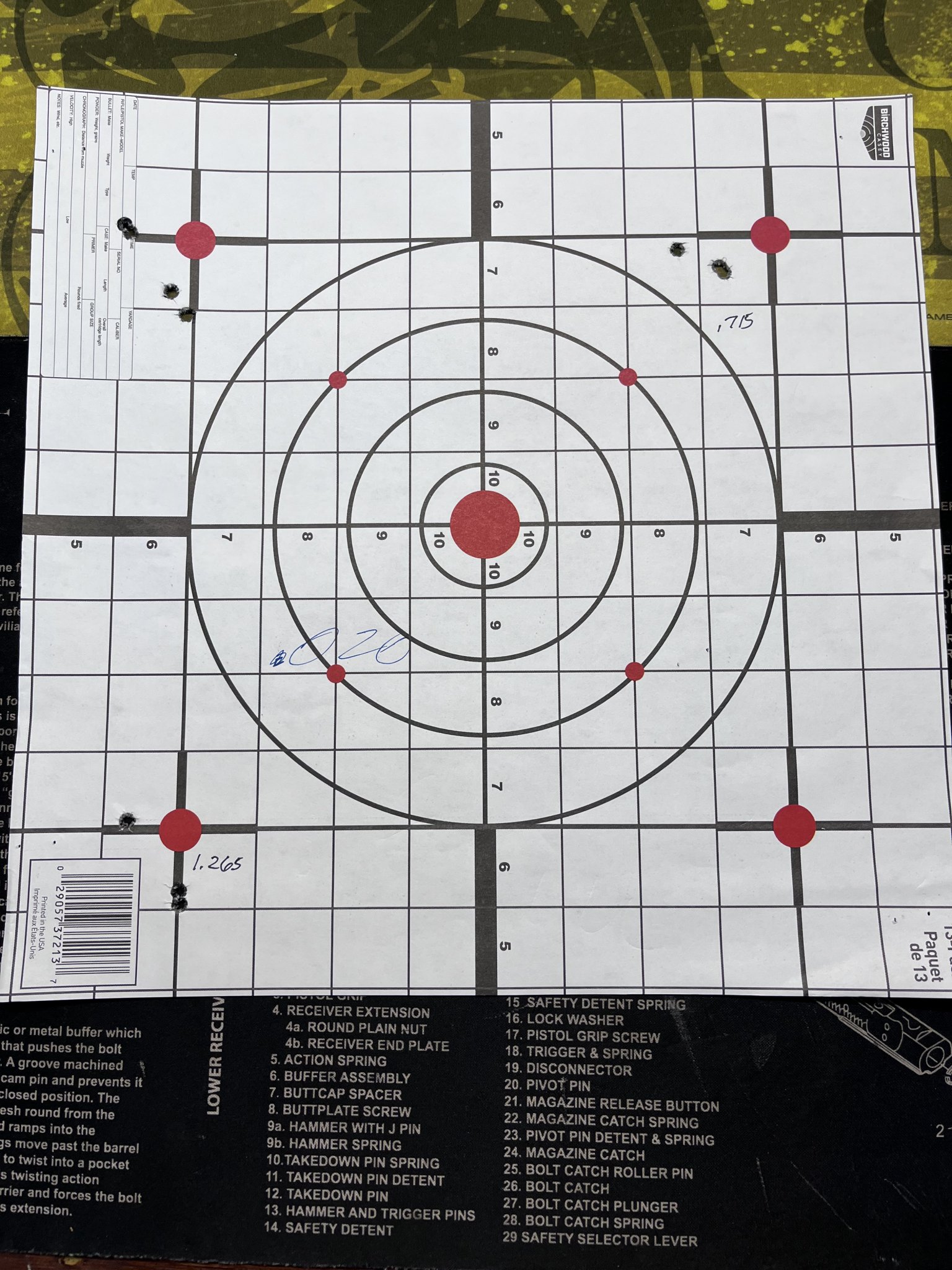

    Threw some more money down range yesterday. Used 24.5 gr and did a seating depth test. .120 off the lands shows some promise other than the flyer so I guess I’ll test more around it. Red dots are 1/2”
    It looks to me like its shooting groups to different POI. I would check the scope and action bedding, or action chassis interface.
    When someone posts a target like that, it's probably not load development. Rings and bases are where I would look first.
    I’ve checked all torque and found nothing. This is the second chassis it’s been in and the second proven scope that’s been on it.
