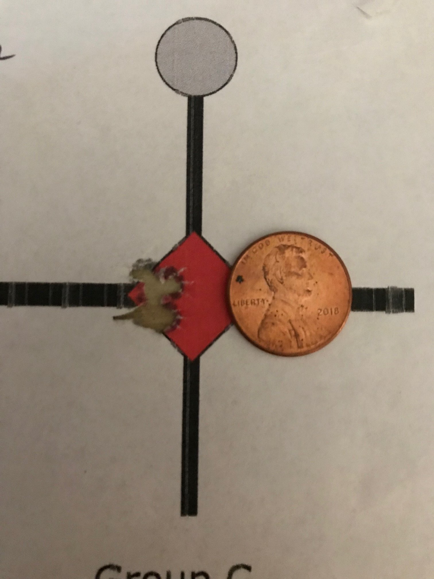

    ETA Here's a 5 shot group at 100 with 75 ELD-Ms in the .223 Wylde chambered barrel he did for me for my match rifle. I have shot this rifle to 1150 yards in matches.

    @bohem Josh down at Patriot Valley Arms could easily put one of his barrels on there for you. They are right down in eastern PA also. I would go with a 26" barrel myself. Plenty long enough to get velocities with the heavier bullets but not overly long. As mentioned you can send in the barreled action to get trued and the barrel installed or do a Remage, which will require some more parts and tools. Which were you thinking?
    You need one click right. Work on your breathing and those groups will tighten right up.
