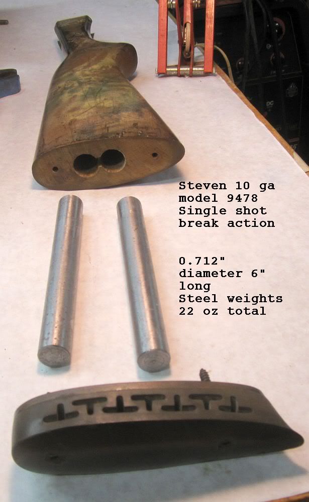

The Stevens factory put these two weights in the stock of my 10 gauge.
Why .712" diameter?
I might guess it is that they had those rods for knocking dents out of 12 gauge bores.
When I buy round steel, it comes at .75".

Similar weights in the old Ithaca MAG10 semi auto 10 gauge.
Something like that would work in sprayed foam as well inside a hollow stock. This job calls for some creativity and ingenuity.
Myself would save the steel rod for lathe turned projects
