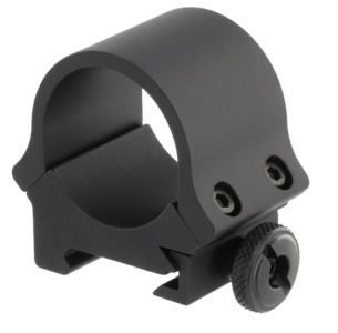

Gentlemen, after searching for a good hour, I can't find any torque values for mounting an Aimpoint ML2 in the factory Aimpoint steel ring,(part#12224), including the value for the cap screws and the value for the base screw.
Any help would be much appreciated. Thank you.

This is more than close enough: https://www.badgerordnance.com/media/bo_media/Mounting_rings_and_bases_2017.pdf
It's actually how I tighten all my scope mounts. Never have had an issue and I know how to tell if I have an issue.
Part 12224 is a flip cap. Is this what you have?
It's 12244, easy mistake. Looks like a basic Weaver style ring. I'd use 15-18 in/lbs on the cap screws and 30 in/lbs on the crossbolt. I'd be weary of putting 65 in/lbs on that thumbscrew, it could probably take it but I wouldnt want to test it.
Oops! Typo on my end. That is the ring, alright.
Thanks for the input. Aimpoint just says tighten them.
Good point. If Aimpoint isn't too concerned, why should I be?
