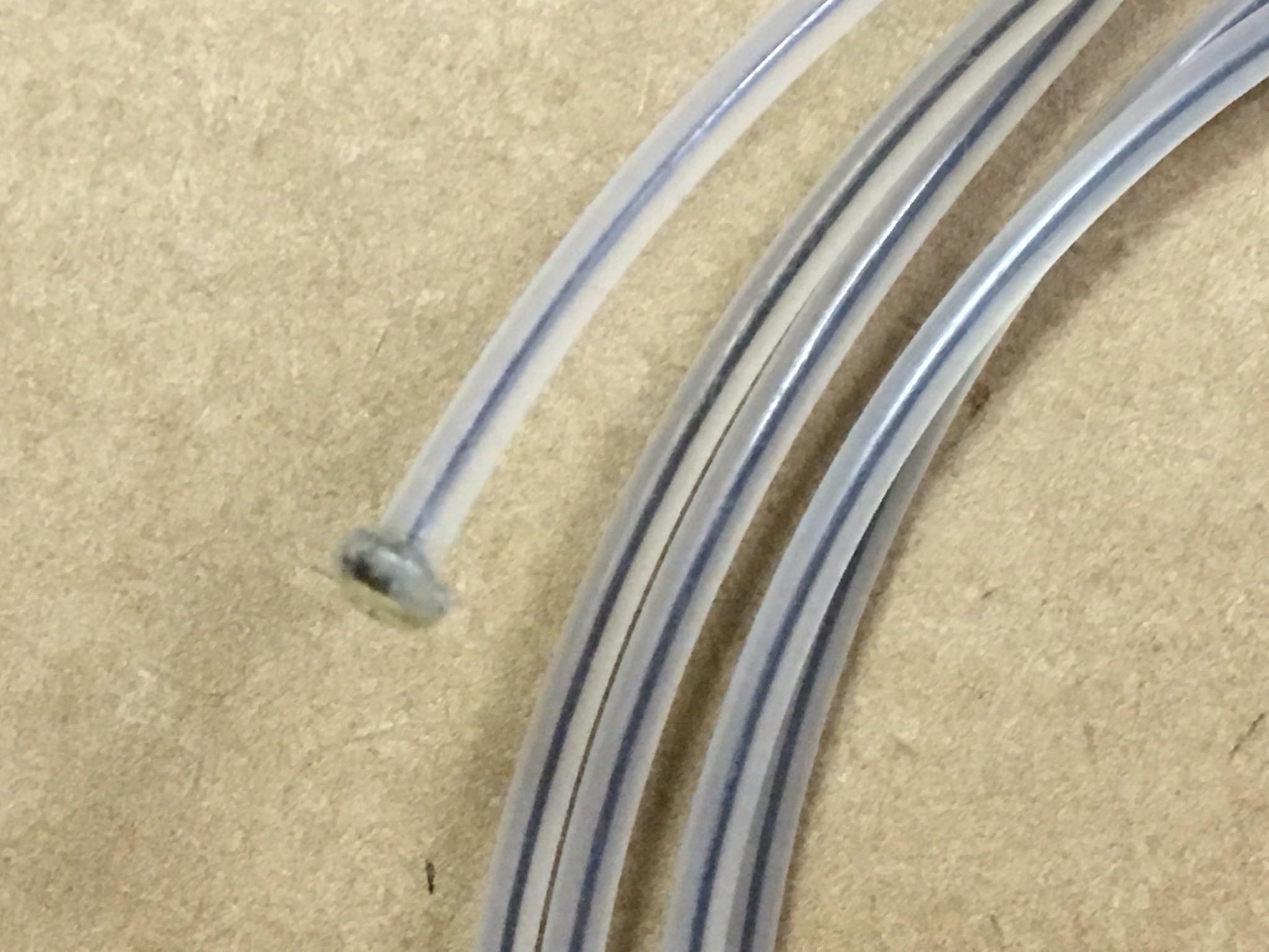

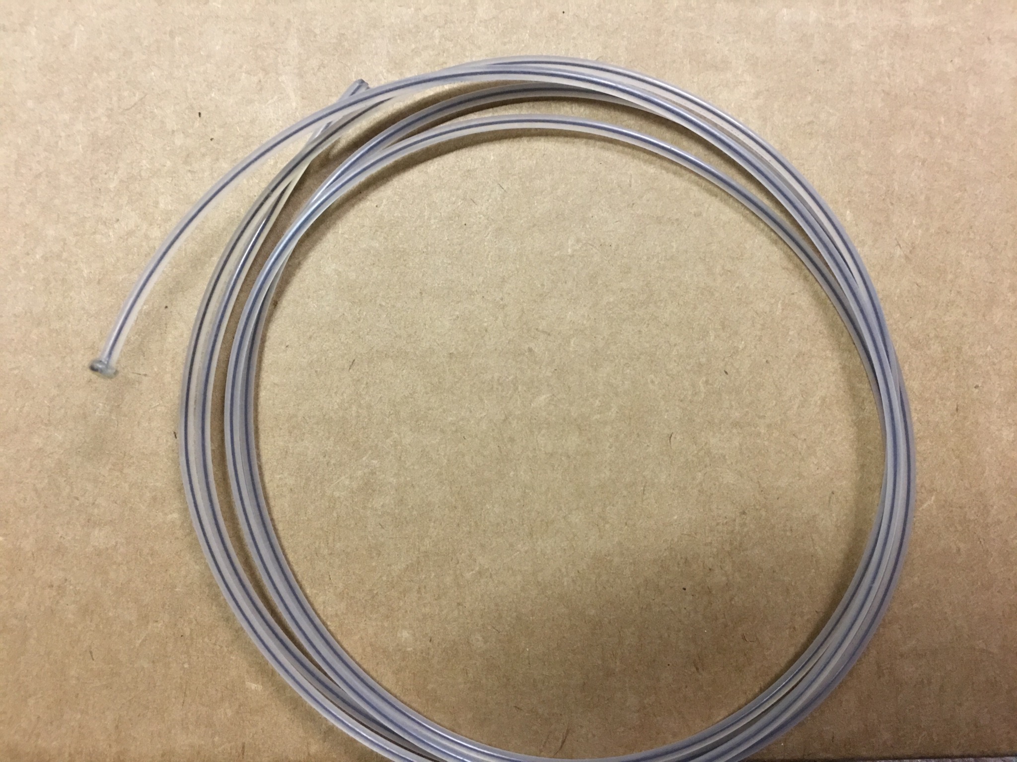

    I knew someone would ask this. I use a piece of weed eater line that I’ve melted one end to hold the patch. I just poke a hole in the patch and slide it on, wet it and pull it through from the chamber to the muzzle. No brass or copper in involved. It works real well, and cost nothing.
    I do something similar. To add to this, using some wire cutters, just clip the end you thread a patch on at an angle. This will allow it to poke through the patch more easily. The weedeater method of cleaning barrels came about from the rimfire guys 15-20 years ago (since 10/22's had no breech hole in the receiver for using a standard rod). They're also an easy thing to add to the pack for a quick clean (especially if the bore gets fouled with dirt or mud).
    I didn’t know this about the 10/22 guys, but it certainly makes sense. I use it on all my rifles.
    I tried using a fingernail file to get a point on it, with no luck. Never crossed my mind to use the old side cutters. Thanks Marine. .

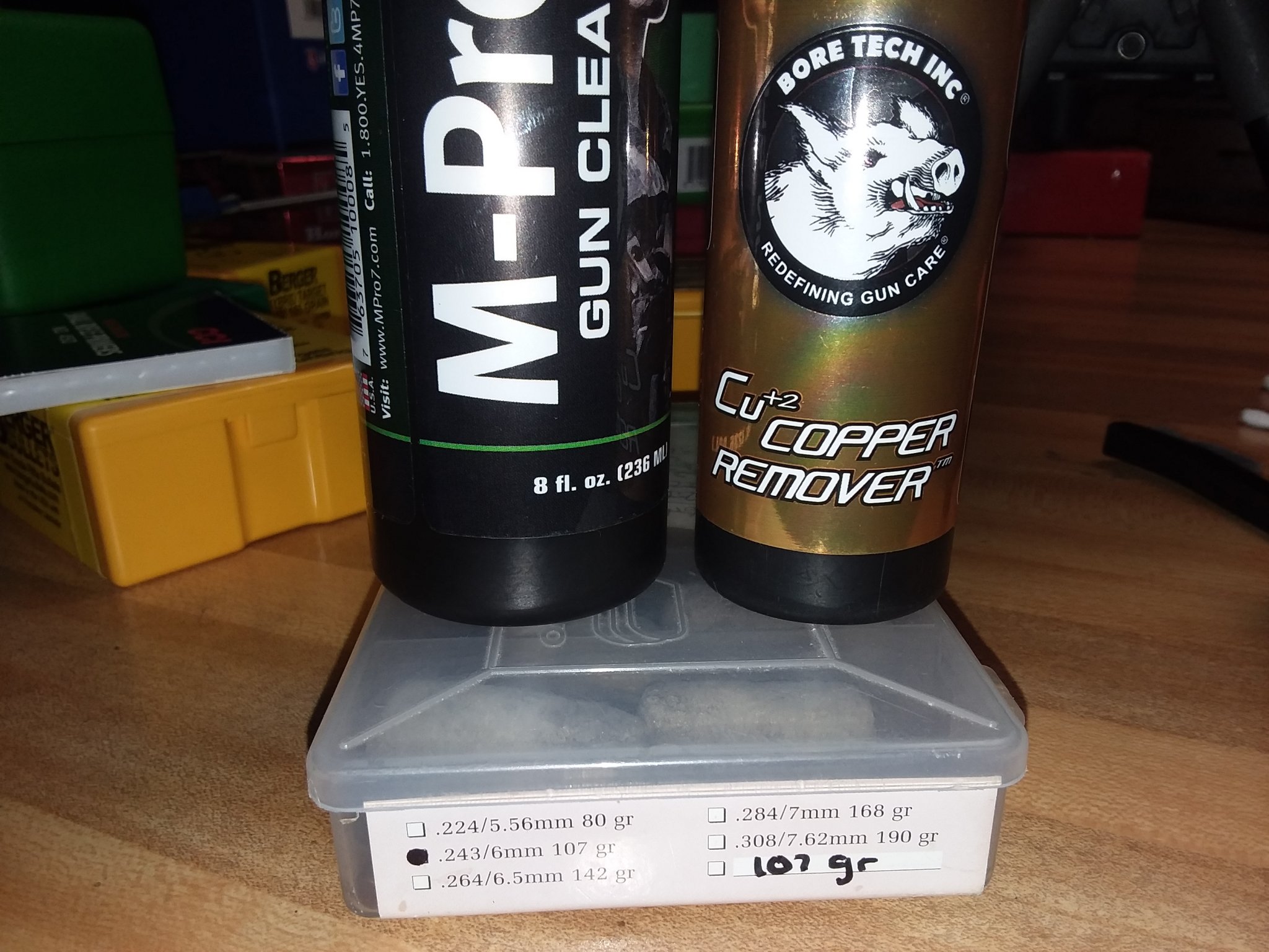

    I found Montana extreme copper killer to be the best.

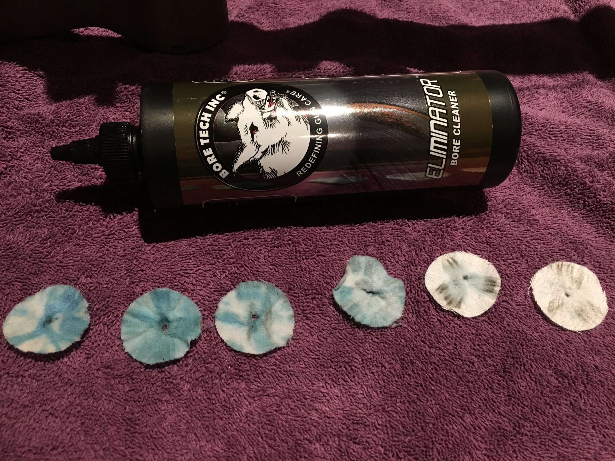

    1-2 wet
    wet bronze brush for 10-15 strokes
    Let sit while I do something else
    2/3 dry to push the crap out, patches come out blue
    One wet patch short stroke
    2/3 dry
    1 90% alcohol
    1/2 dry
    15 min tops.
    Down to bare steel
    My cleanining agents...actually went thru the regimen last eve on the 6L.
