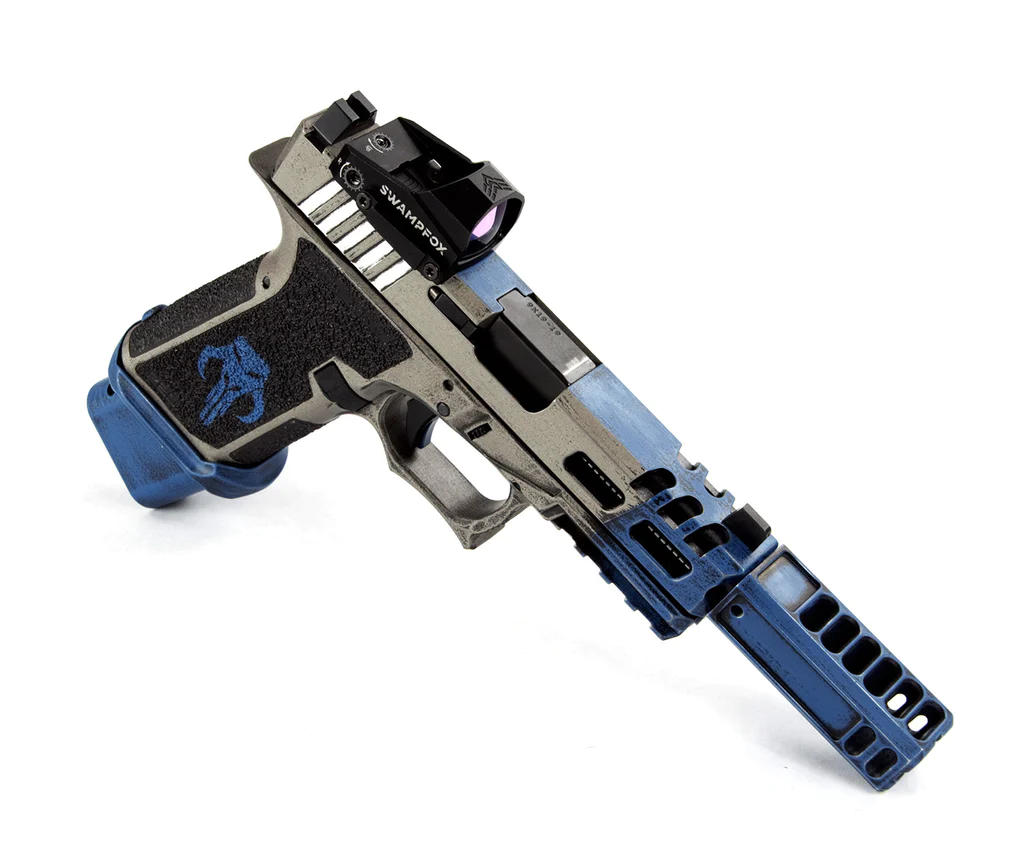

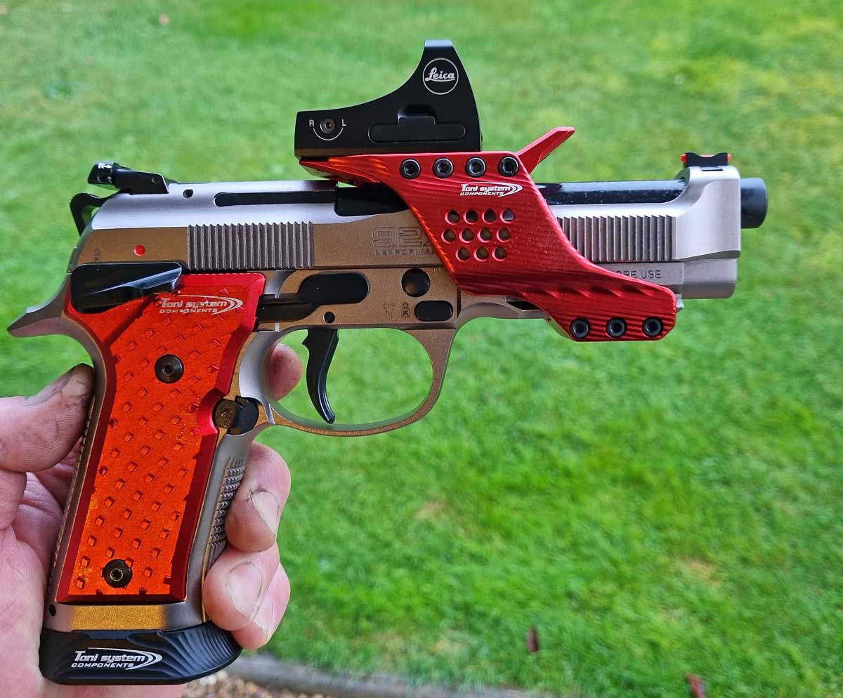

So I put together a P80 and I'm thinking about putting a red dot on it. Problem is I don't know much about them and what makes one better than the other. I have a super cheap one on my AR9 that my dad gave me because he had a couple extras. I think I would like to run this gun in carry optics or limited optics in the small local USPSA match. I'll probably hogs with it too. Basically I saw this picture and I really like how this looks. Looks to be a Swampfox King slayer. Says it is a 3moa dot. I read in the new firearms news that the larger the dot the better... But better why? I don't know what my budget should be, I've seen super cheap amazon dots for less than $40, but lately I've grown fond of my scopes that cost a little more. The Swampfox ones run from $189 to $350. I don't think I want one of the enclosed cube looking ones.
Also.... Any one of you ever cut your own slide for an optic?

PS, I know you said that pic is not of your gun, but comps are not allowed in Carry Optics or Limited Optics division. Open division is the only division you can run a comp on a pistol.

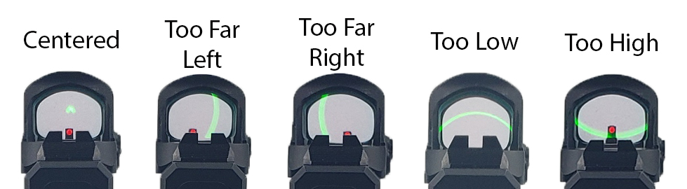

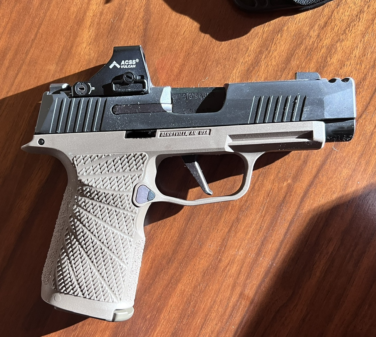

I have a holosun 509 with the ACSS Vulcan reticle. Seriously look at this reticle before buying anything else.
It has a huge circle that, when you’re fully pressed out, isn’t visible in the optic. But if you cant the gun in any direction, just as the aiming point disappears out of the viewing window the edge of the red circle comes in on the opposite side. Finding the dot is instant and intuitive no matter where the gun is pointing during the press-out. Honestly I can’t imagine having a combat pistol optic without it, it’s that big of a deal.

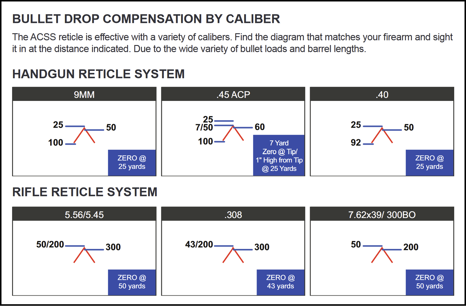

The chevron aiming point really works great too. If you sight a 9mm in at the tip of the Chevron, the base of the chevron is the aiming point for 100 yards. Ringing 12” plates reliably at 100 with a 9mm will definitely get peoples attention lol.

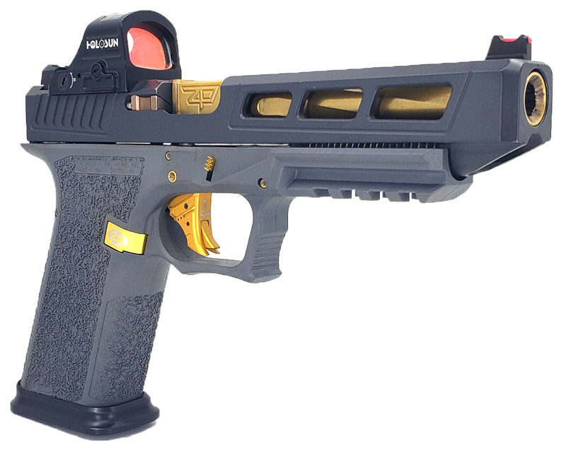

Thank you all for your input. After looking a little more I think I like the circle with the dot in the center, should work fast up close on multiple targets, but still have a small dot for more precision. I like the SIG because it has a rear sight built in, Crimson Trace has a couple with rear sight built in.
Looks like most red dots are mounted in front of the rear sight, but then the rear sight may block some of the window? So then I see some mount the sight to the rear and cut a new groove for the rear sight in font of the optic, looks a little silly, but does it work? I think I like the rear sight built into the optic, and I'll just do away with the rear sight.
The more expensive ones only have one reticle. I see some that have a dot and a circle dot that you can switch between, but they are cheaper.

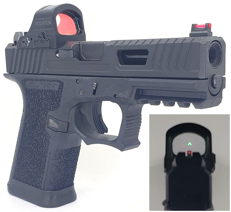

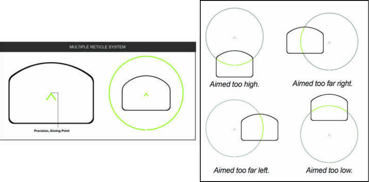

For my PFC9 (serialized P80 frame) EDC pistol, I got the Holosun 507C (green) with the ACSS Vulcan reticle that @Namekagon mentioned.
The ACSS Vulcan reticle is the bee's knees, IMO. Especially good for learning and training for consistent presentation from a draw and quick acquisition of the "dot."
Holosun's infographic on how it works:​
Then I made my own infographic:​
(getting the reticle in sharp focus is difficult with a camera, but it's very sharp to the human eye).
Once you've dialed in your presentation, you won't ever see that outer circle.
For defensive shooting, I really REALLY like the chevron. If it's bullseye shooting, then the small dot reticle is better, of course.

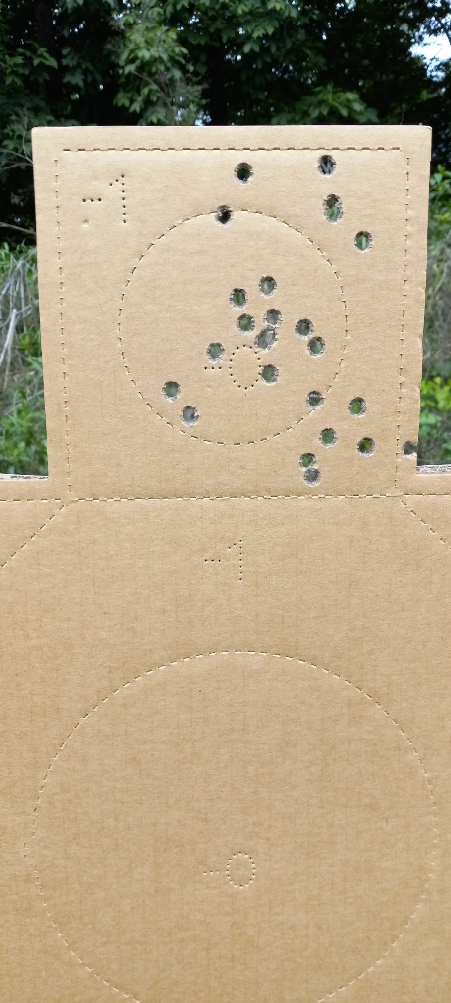

This was done with a C-More RTS2 10 moa dot at 25 yards at a pace of .7 to .8 seconds per shot. Not fast but also not taking my own sweet time when confirming zero. The first few shots were low and left after zeroing at 10 yards. The head is 6" x 6" and the circle in the head is 4" diameter. As I said before a 10 moa dot covers 2.5" at that distance.

The ACSS Vulcan chevron is 10-MOA vertically. It can be used as a "bullet drop compensator," too.

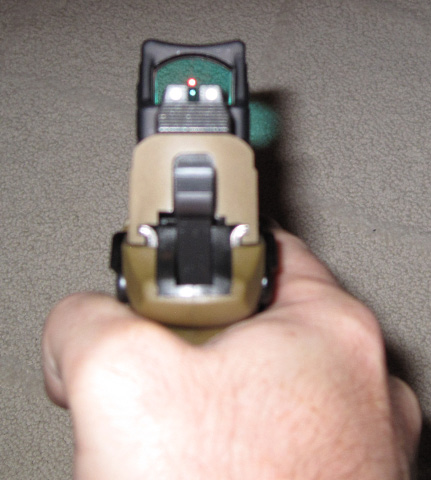

The Trijicon on my FNP-45T: Not much window "real estate" there.

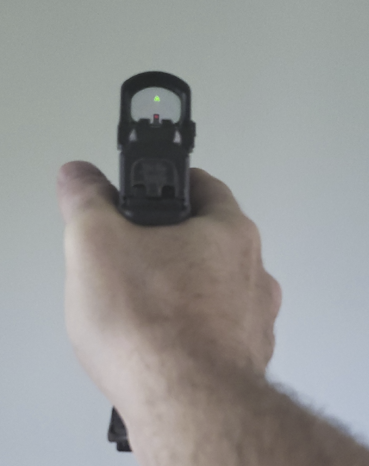

Holosun 507C on my PFC9:

The size of the window is almost irrelevant once the dot is in your fov. The picture above with the RMR is a perfect explanation why the rear sight in front of the optic is better if you're going to use sights that can be used throught the optic. .
The blue tint is also irrelevant because you're supposed to see past the optic and not through it. It's not s rifle scope.

I have co witnessed irons on one pistol only. All my others including my other two carry guns just have the low oem sights. Don't need cowitnessed sights to find the dot and as far as I'm concerned my choice (Trijicon) is reliable enough for me to go all in.
Your first sentence description describes me to a T. I have not yet made the transition to red dot, but when I do, I realize that it is going to take some major work on my part.
with many new shooters these days that don't already have experience with irons, i understand why holosun has added that outer circle.
It's like "training wheels" for pistol dot optics. I'm not a new shooter by any means. But I found it to be a clever addition. Most of the time you don't see the outer circle. But if for some reason your presentation is off, the circle intuitively (and quickly) gets you back on track.
I'll push back & say these reticles actually suck.
I've been carrying a 365 w/ the HS-507K-X2 w/ ACSS dot for the last ~8 months. It has a 2MOA center dot (not the chevron) & the 230MOA outside circle that's supposed to provide faster sight acquisition. I'll be the first to tell you it's not faster & might actually be slower. You should train to find your sight picture through proper presentation... adding an additional visual element in is superfluous at best & a distraction that may increase cognitive load at worst. I'm also pretty sure it kills the battery much faster. I think it's a neat idea that doesn't solve the problem it aims to fix & therefore is a waste of money. I'm either pulling it off entirely or turning the outer "orientation circle" off to just use the 2MOA center dot.
The shake awake instant on is worthless during your daily activity because you'll never stay still long enough for it to shut off.
I disagree, I think Holosun's shake to wake is great. It's basically on while your wearing a gun & off at night, which is my preference.
Also, I have hit the 507K's +/- buttons enough that I feel the need to check my brightness level every now and then. That might be a "me" issue, however.
Edit
Just noticed mine still says “Vulcan” despite being the 2MOA center dot.

Holosun makes decent stuff, but IMO your best budget option is probably the Sig Romeo Zero Pro. It’s a good low/mid-tier optic with proven durability under recoil (not for duty-use, but good enough for a fun gun) and at a great price point.
Reactions: Racer88
It's there because it's needed to extend the life of the small 1634 battery that holosun uses to match that of the much bigger 2032 used by trijicon.
The RMR on my carry gun is on 24/7/365 on auto adjust. When it's in my nightstand it dims to the darkness conserving battery and when I take it out I don't have to fuck with adjusting brightness.
I can understand not wanting to buy a top-tier MRDS just to test the waters. That said, avoid the crap optics by unknown companies like you’ve posted above.
I think you may have found me a red dot. 6 moa and rear sight built in for under $140. With a recognizable name.
Thank you.
And add on this mount and I don't have to cut my slide yet. This may be the way to go.
