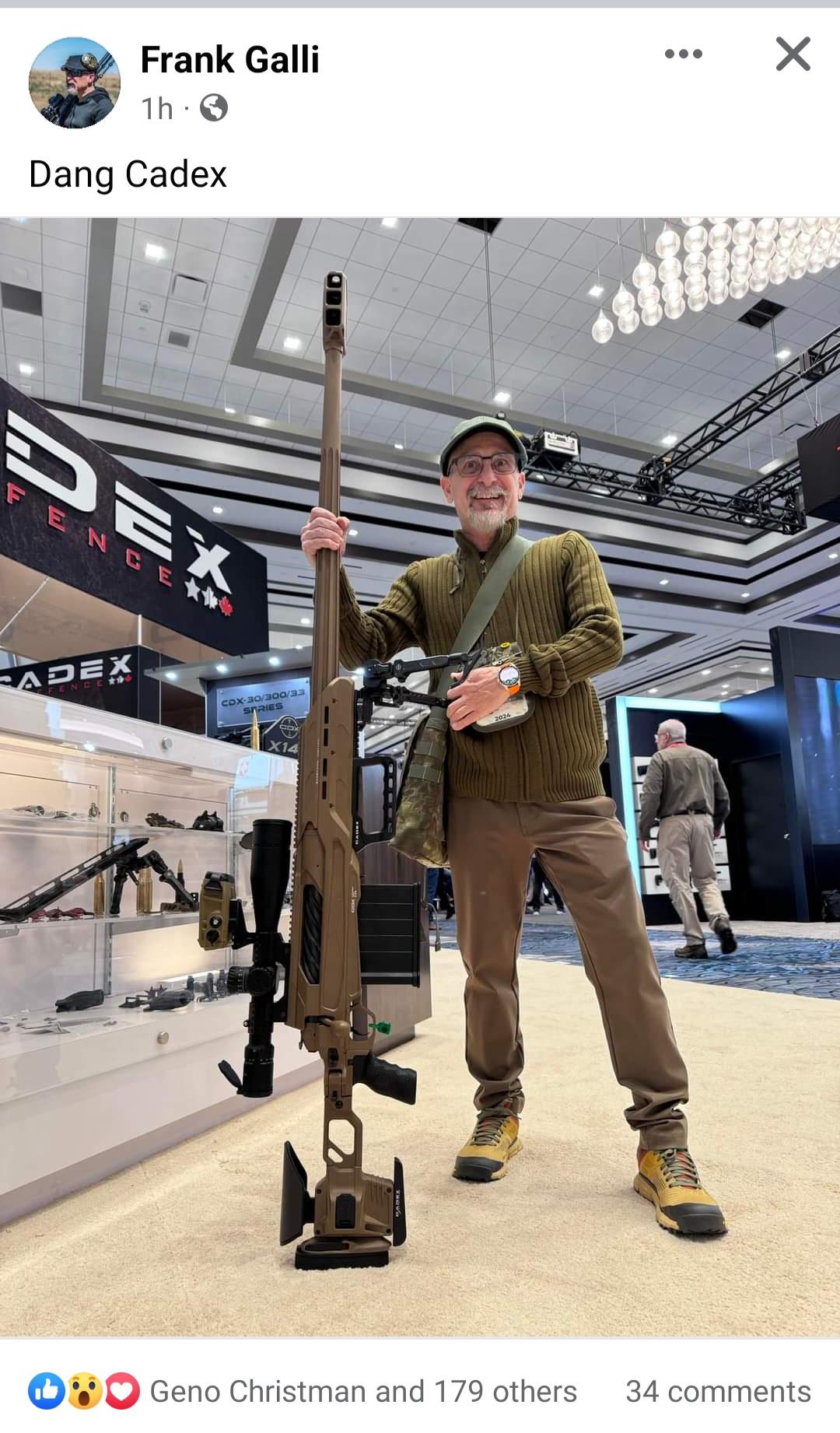

I think @Lowlight needs one of these! Not trying to steal any of LL thunder here. It's just a cool pic!
