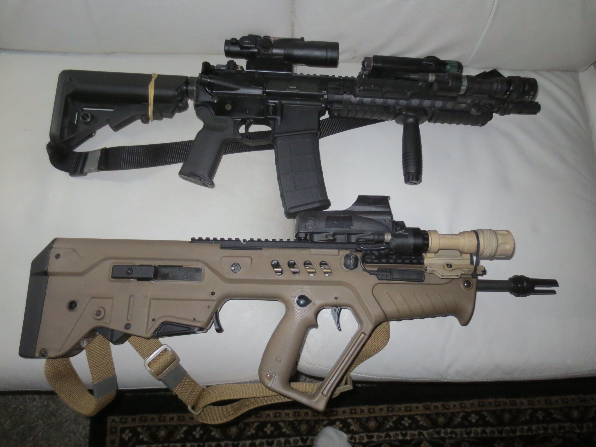

Probably my most handy/useful overall rifle:
I used the picture of it alongside a 9mm Tavor. That's another possible option (9mm, 5.56 or .300BLK, not as accurate as the AR though) and won't have to be SBR'd, get to keep the 16"bbl. and all it's good for. Tavor is a bad motherfucker provided you don't need tack driving performance.
