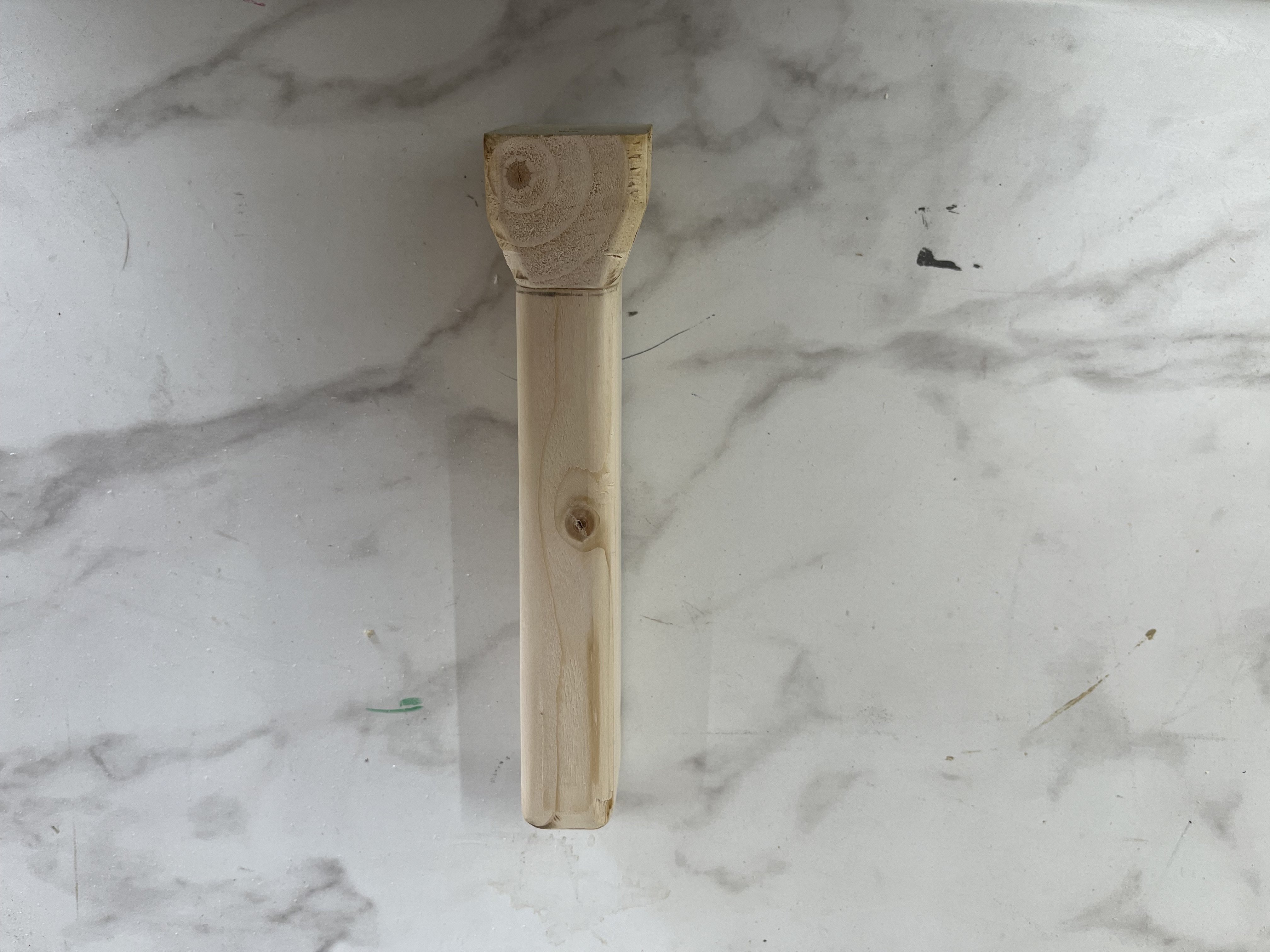

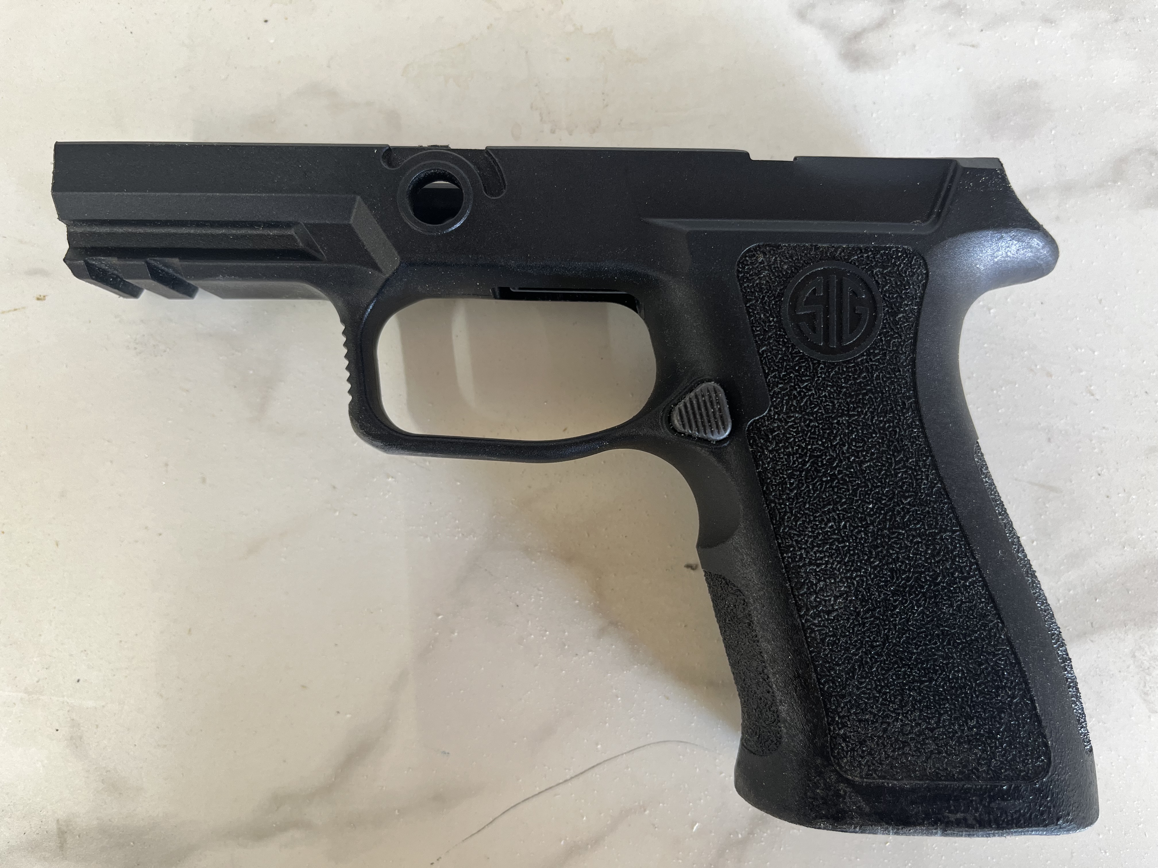

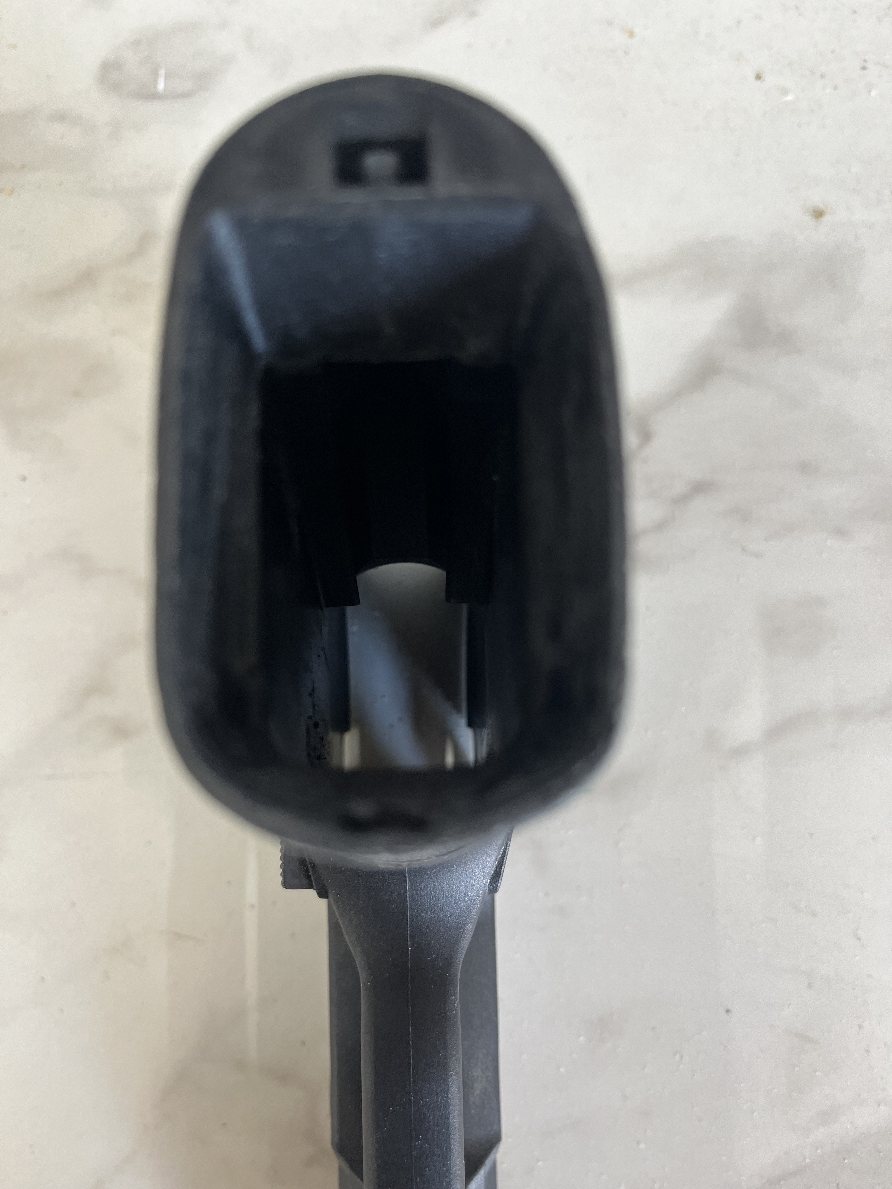

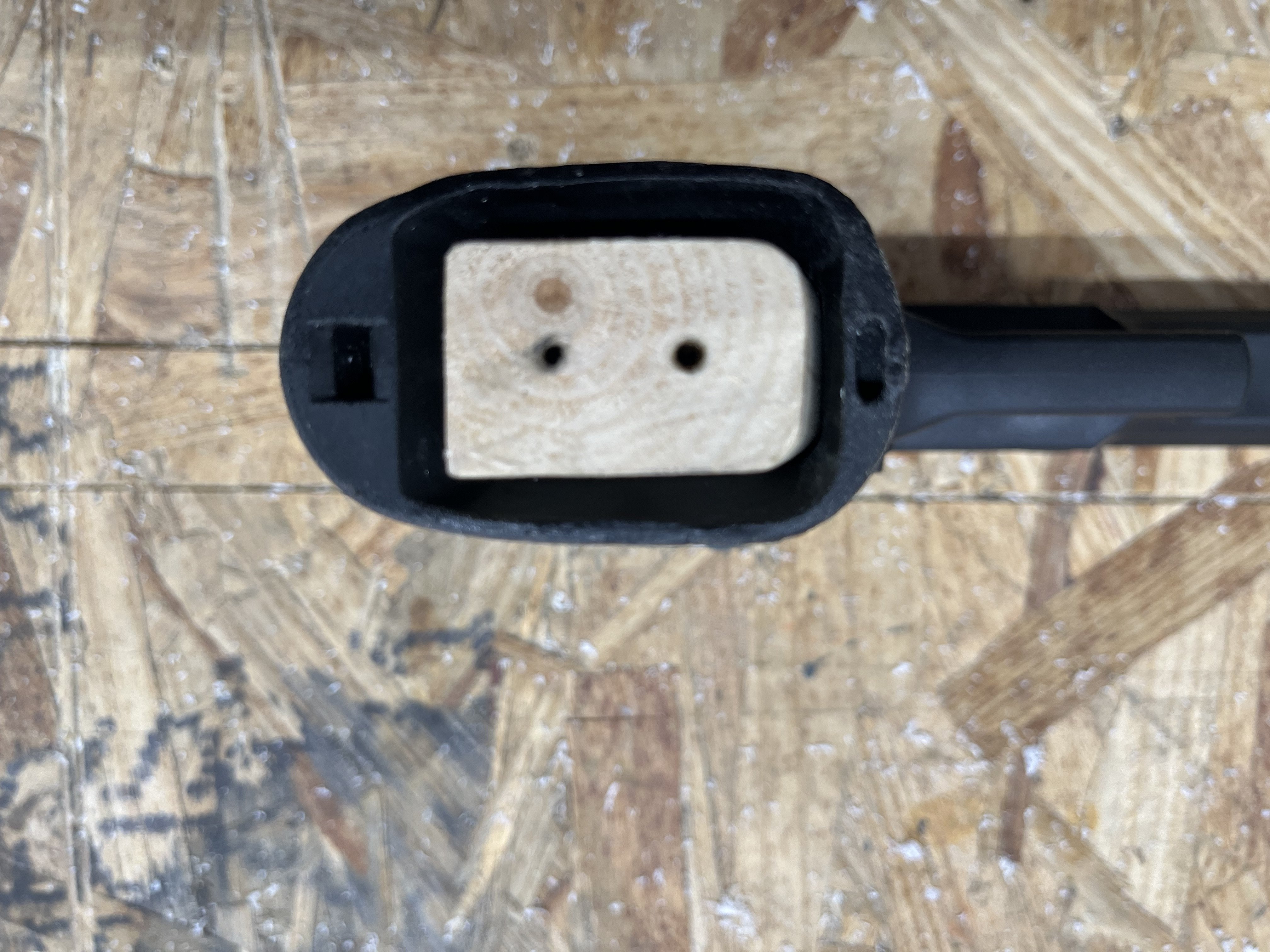

I decided to try to flare a polymer grip and create an integral magwell. I wanted it to be slimmer, smoother and smaller than adding a add on well.

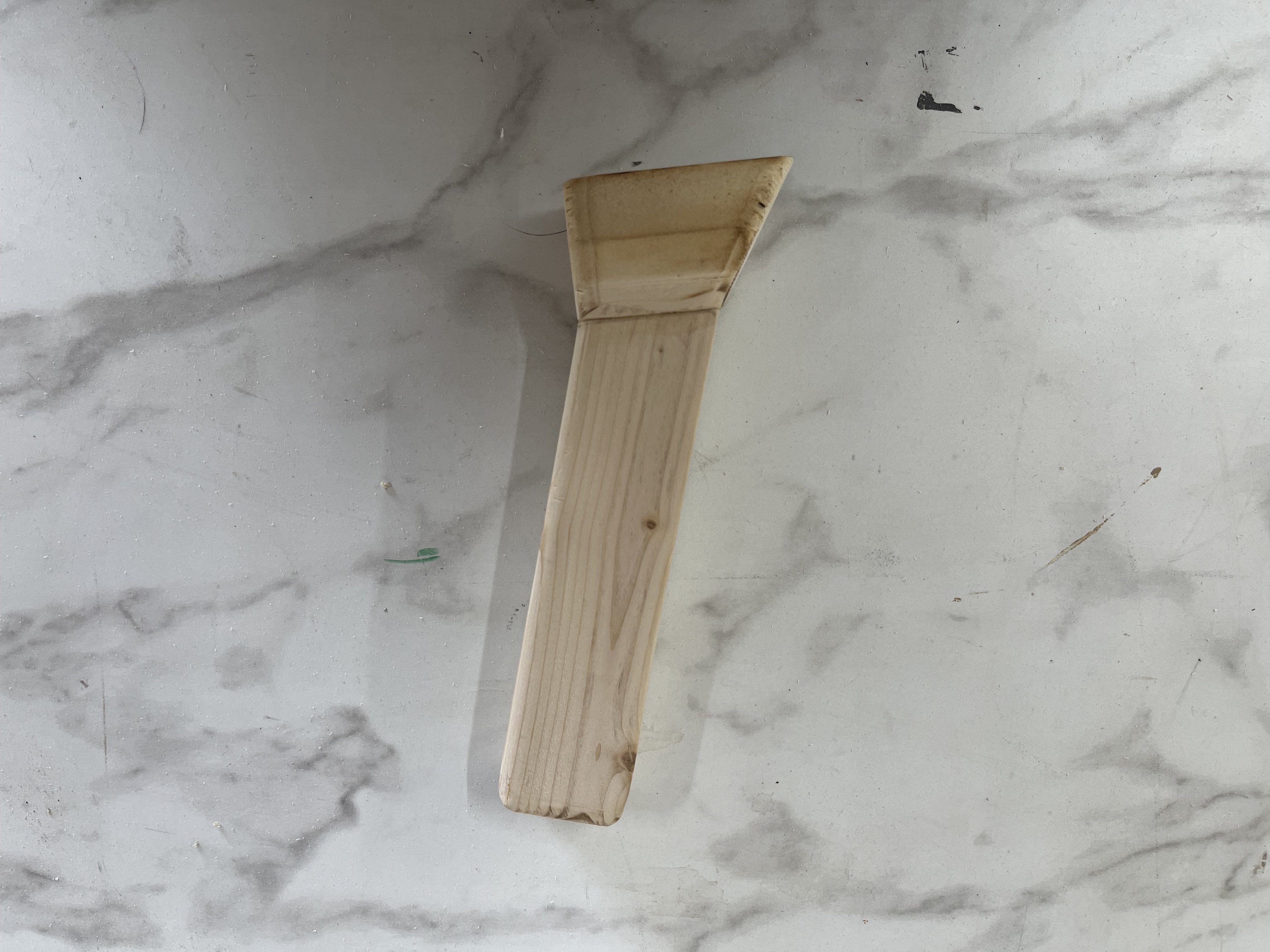

So what I did was make a magazine with the flare added, I then clamped it in a vise, added pressure and heat, it worked out pretty well I think. Needs some final touches but I think it worked out.

On a serious note, thats actually a good effort. well done. How is the rattle / mag fitment ? How much shorter is it now ? Can you over insert or does the stopper at the top still work perfectly ?

Feels the same as stock, probably a 1/16", appears to function normally

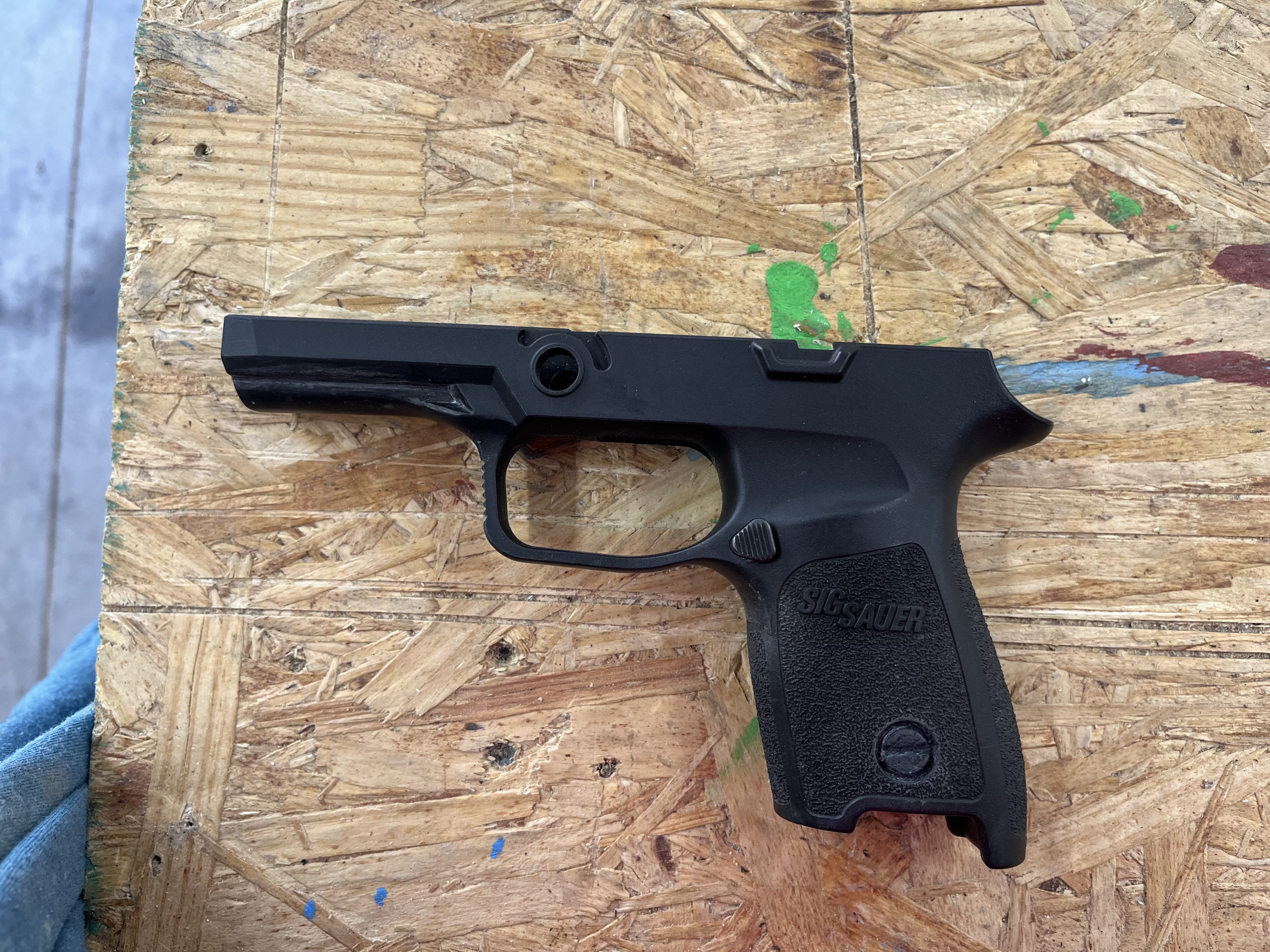

Luckily used stock ones are fairly cheap now. I have done a few different ones. This other one I removed the rail, trimmed the trigger guard, enhanced the grooving and added a screw to look like a grip panel. Looks old school.

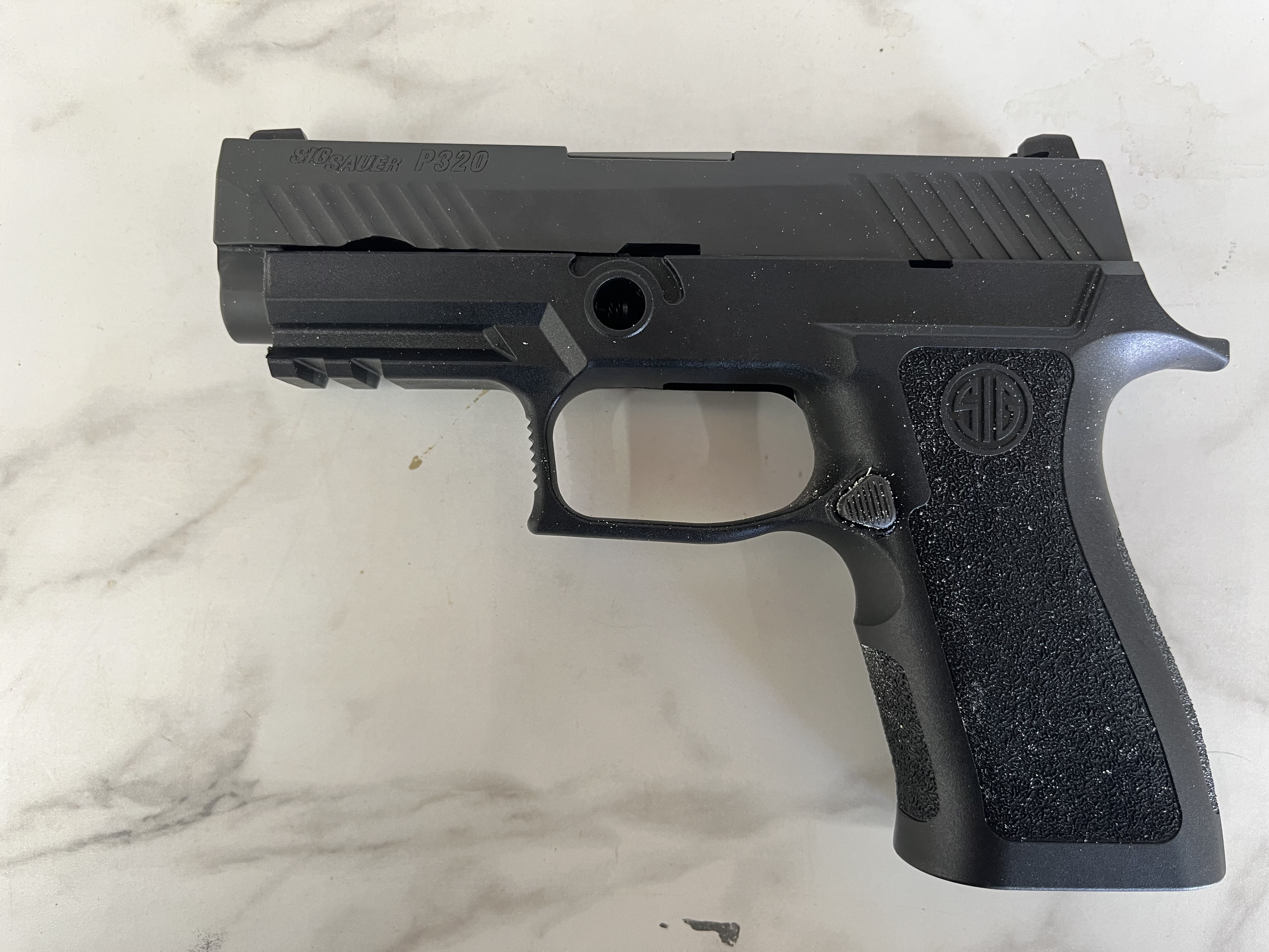

So I cleaned it up some this morning, did an extreme reduction on the beavertail and rounded the trigger guard. I am trying to decide what to do with the rail, leave it, round it off or something else.

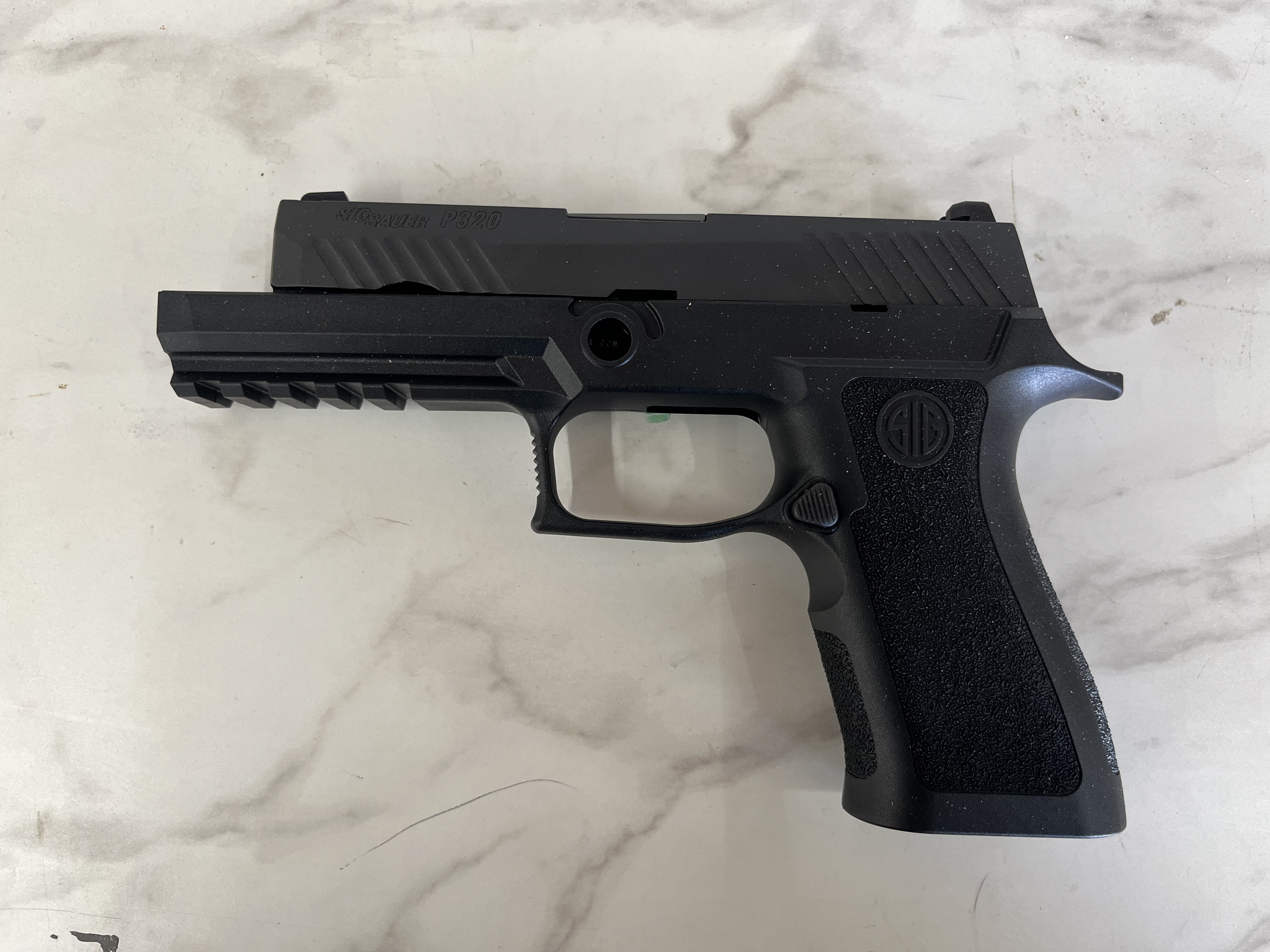

I am amazed how good this gun feels because of the location of the flare on the front of the grip. I think O might of accidentally created the perfect carry gun
The other thing I did was when I cut the module down I cut it shorter than the barrel so the barrel sticks out like a full size but this is a compact that got compacted. Normally the frame matches the slide.
That shorter slide and beaver tail do make it look way cleaner. Leave pic rail. Looks stock / factory.
Big fan of full-time grip and commander size slide.
