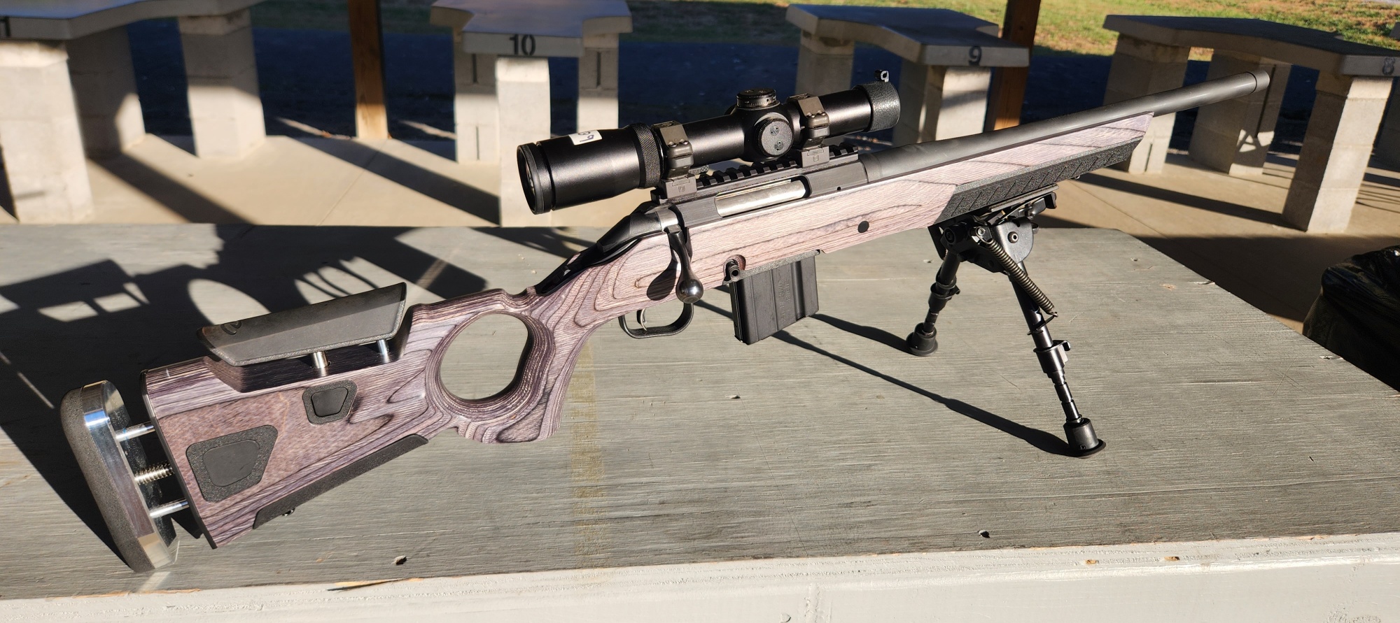

I'm mainly a milsurp guy but have put together a couple of new/commercial bolt action rifles, supressed, and thinking about going further.
My RPR in .308 is astonishing (to me) for the money. Just landed a 1" group @ 300yds wi 175gr FGMM.
An RAR in x39 in a nice Boyd's stock has delivered 1.5" @ 100yds wi 1970s Romy milsurp.
Have a sh_t ton of various 55gr backed up and three nice ARs in .223 but am bored with em.
Sooo, thinkin about a bolt action in .233. All cursory web scanning a steers my towards another RAR. It really appeals to me to use standard 10-20rd mags that I already have .
Thoughts, ideas?

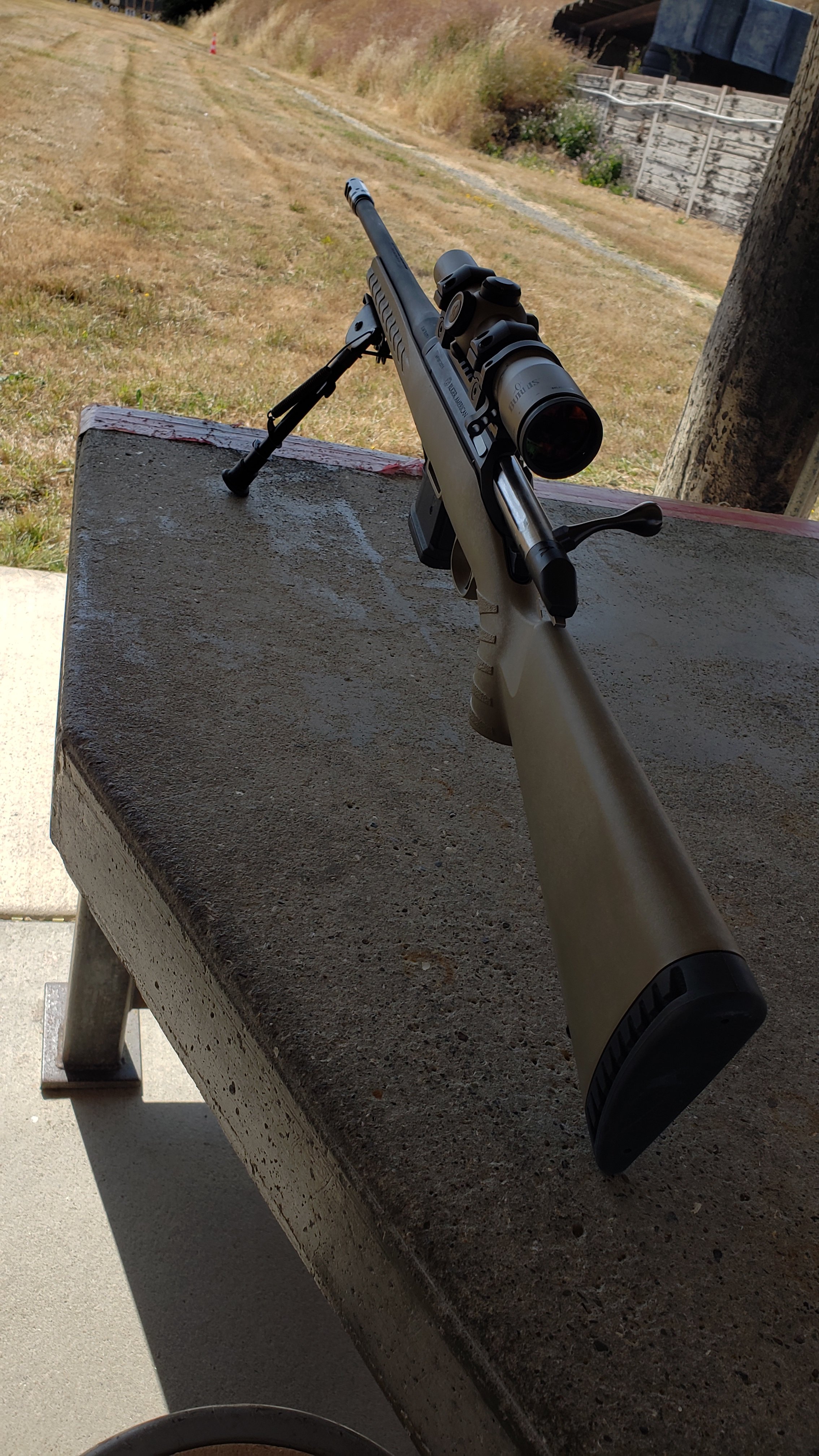

My Gen 1, RAR in x39 is a great little rifle. I paid $425 a couple years ago from an outfit called Family Firearms down in Alabama. I dunno if it was on blow-out, cuz the Gen 2 came out 6 months or so later. They’re outta business now. some kerfuffle with the ATF or something.
I cycled the zipper bolt hundreds of times with some bore past and lapping compound. Smooth as glass now. The Gen 1 “Rubbermaid” stock was okay. Put it in a Boyds stock and eventually a better bolt handle, is all I’ve done to it. Mags are a skootch loose fitting and nose dive from time to time with that Boyds “bottom metal” adaptation. Aside from that frustration I’m extraordinarily pleased with it. Pulled off the groups below with it just today. So much for the vaunted Yugo M67. Doesn’t like it. But regularly pull of 1” groups with Barnaul, Golden Tiger and surprisingly, 1970s Rommy green tin milsurp. Trigger has a nice clean break that I was able to adjust down to 3lb, 10oz.
A Tikka’s gonna be near a couple grand, no? I looked into the CZ 527 in x39. Wonderful, but they are long disco’d. Some PITA issue for scope mounting as I recall (???) and mags are unobtainium, no ? Rem 700 ?
I’m leaning towards another RAR (Gen1 if I can find one) and an aftermarket stock again. Not sure I’d wanna spend the money on the Gen2 just to change out the stock as well. And I plan to fire suppressed so no need for the brake they now give you. What else might be special about the Gen2 that’s worth a couple hundred more $ ?
