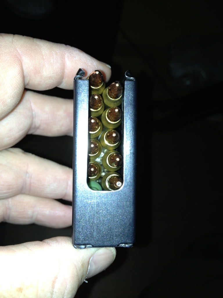

You can shop magazines for more length, or borrow another trick from the service rifle types and slot the front of the magazine.
