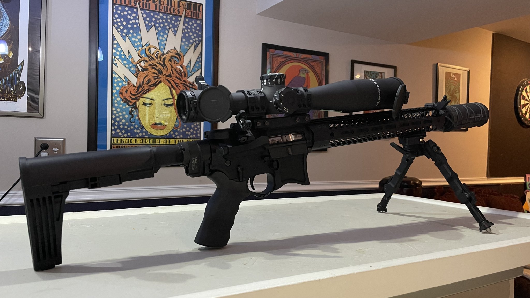

Here’s what I recently did:
BCM upper receiver (thermal fit)
Geissele Mk16 15” handguard.
Bartlein 5R .875 under handguard and .750 gas block (similar to typical SPR barrel). 16” Mid gas.
Pinned SLR (non adjustable).
JP full mass bcg.
Badger G3 charging handle.
PSR bipod and SLR handstop / barricade stop.
Atacr 1-8 in Scalarworks mount plus offset T2 on an Arisaka mount.
May be hard to source parts for top tier build but this receiver and hand guard (or they make a receiver similar but compatible with a round hand guard) and then pick your personal barrel, matched bolt, gas block. Get a Seekins billet lower with your preference on trigger, grip, stock and have it built professionally or yourself if you know what you’re doing. It’s near monolithic.

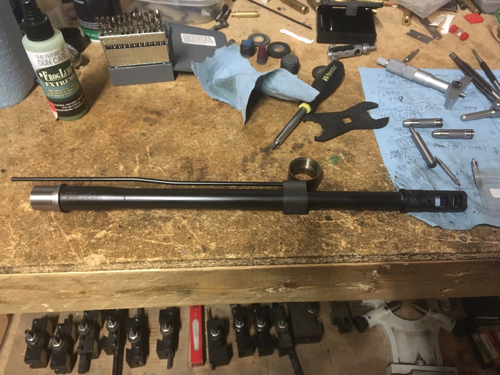

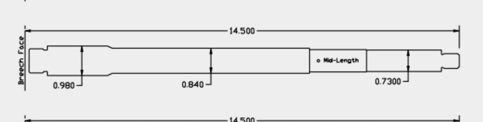

Well, I'm actually doing one right now:
-Custom medium profile Bartlein 14.5, 1:7 twist, mid-gas, 0.076" gas port, pin/weld Surefire SOCOM muzzle device, cerakote graphite black. Optimized to run with a H1. Made by @flyfisherman246 Misery Custom Rifles
Definitely not cheap, but he's a former USMC Scout/Sniper who knows his shit. Full disclosure: we did some overseas work together, so he is giving me a slight discount. He's running a business, not a charity.
Here's the profile he's cut for me.
Here it is after he test-fit everything together. Notice no shims for the brake because he cut the threads to time the brake correctly for my Surefire RC2 suppressor.
