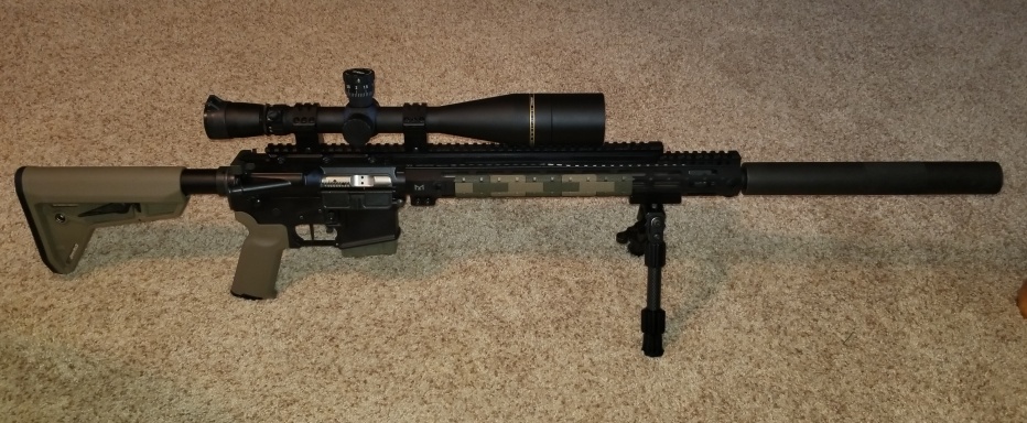

Maybe a picture to spur ideas....
1:8 WOA 18" bbl
SPR rail
Magpu furniture
SPR barrel overmount suppressor
7086660

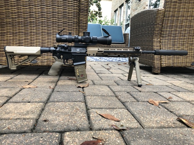

I've got a Seekins 3G2 upper I've been super happy with. Federal Gold Medal Berger 73gr was ~.5MOA at 100 and consistent out to 800 yards, despite the low velocity. The fact that the handguard attaches directly to the upper (not the barrel nut or a collar) was a nice feature, too, especially for shooting off barricades or loading a bipod.

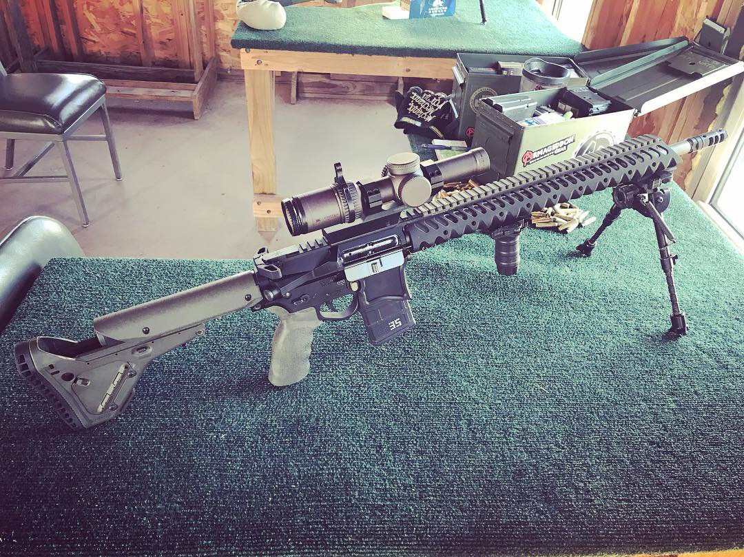

This is my current build. Should be complete tomorrow.
Aero ambi lower and no forward assist upper
Giessele SSA-E, MK-18 rail, charge handle, and buffer system
BHW 18’ Rifle SPR
XLR stock
Picture of the mock-up with SWFA donor scope before assembly.
7087032

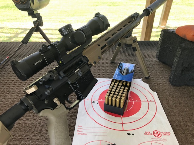

That is essentially what i did.
CLE Bartlein 17.9 1:7.7. 556. CLE Chamber. Matching bolt.
Vltor Upper
Noveske lower

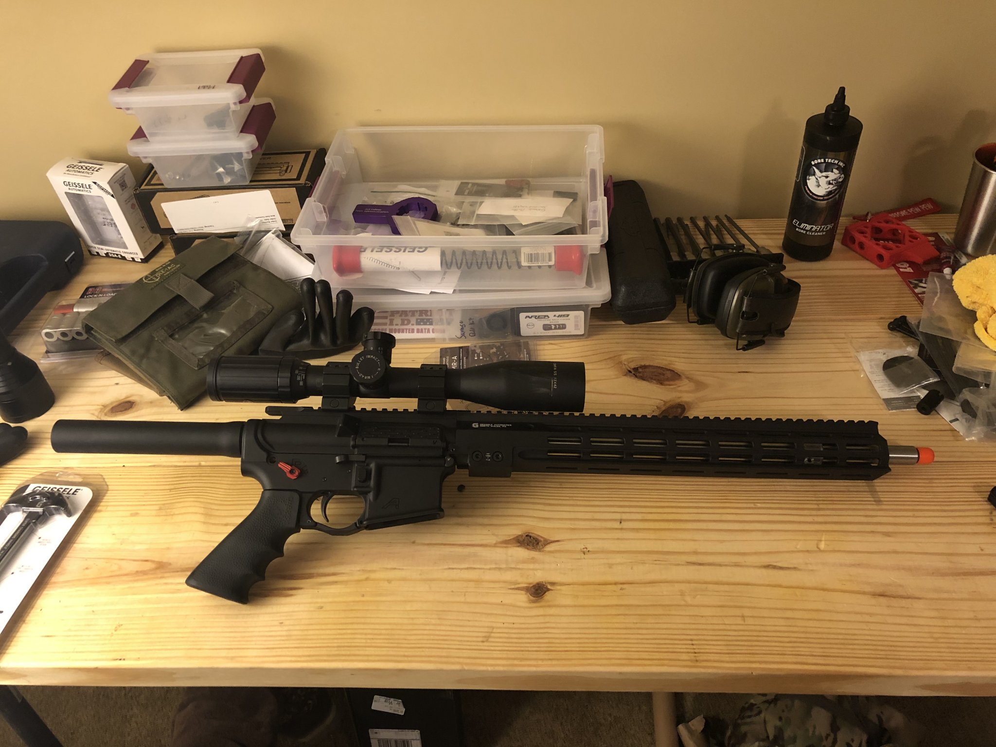

90 rounds down the pipe as of this morning. She is starting to round into form. This is the most accurate barrel I've ever owned. I'm not used to one hole groups and always yank a shot bc I get too excited. Both dropped shots were called...no internet bullshit. 5-shot groups at 100 yards.

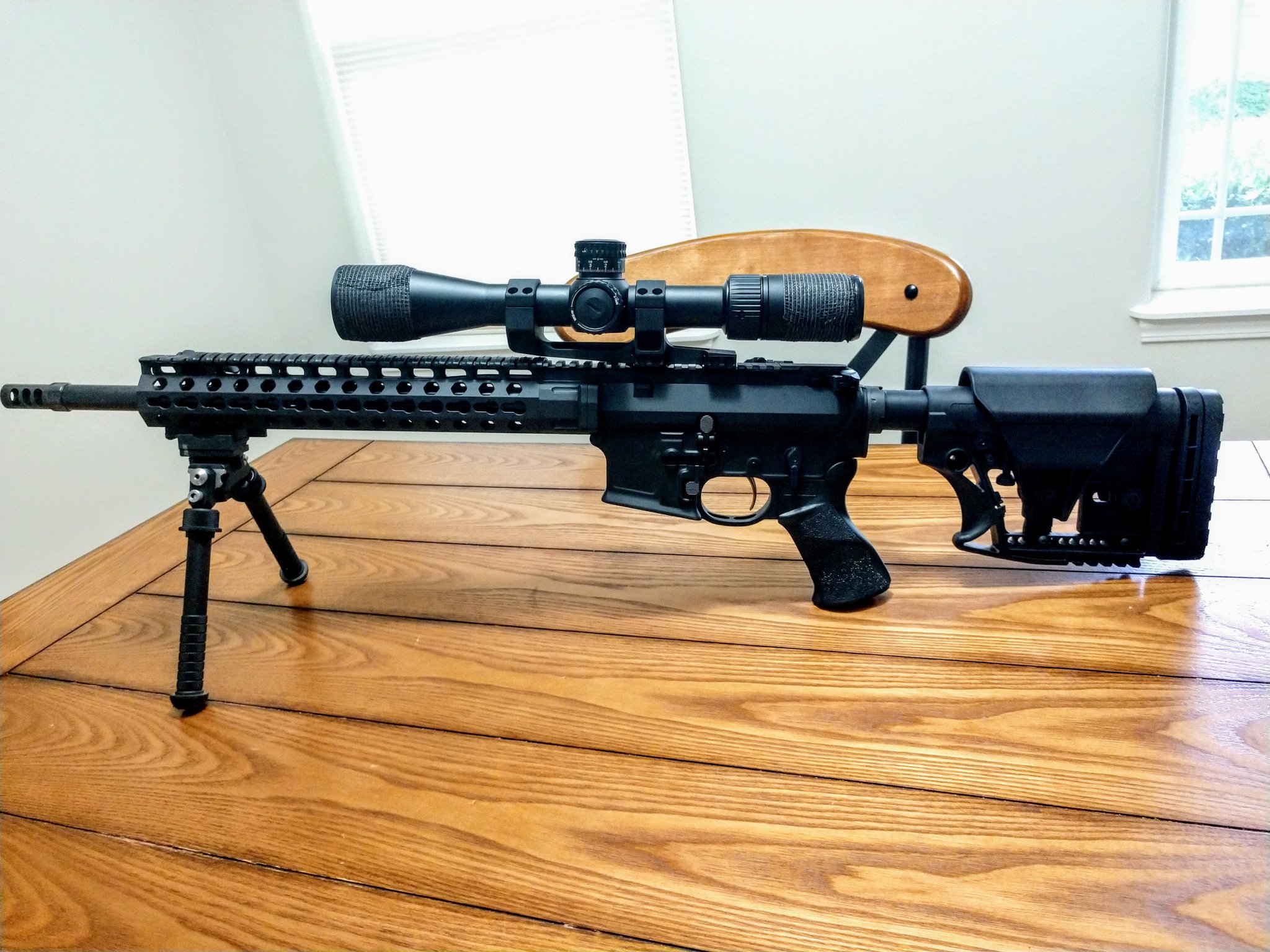

So I ended up with a functional rifle last weekend with this parts list so far, but not done yet:
  • 18" White Oak Armament 1:7 Stainless Steel Wylde Barrel, Rifle length gas. - On sale for $239 at Brownells.
  • Aero Precision Upper, Lower, 15" S-One Handguard - Got the upper and lower for $89 on sale at local Gander, handguard was $125 from somewhere.
  • Luth-AR MBA1 Stock - Got this one on sale for $99 shipped.
  • Seekins Adj. Gas Block
  • M16 Nitrided BCG/C158 Bolt - On sale, $49 PSA
  • Ambi Charging Handle (Raptor Clone) - $29 Breek Arms
  • Armaspec Stealth Recoil Spring with plug from another build's JP-SCS to fit A2 buffer - $56
  • Rise Armament RA-535 Trigger - pulled from a carbine I don't use much. carbine has std trigger now.
  • Ergo Grip with the palm swells.
  • Crappy 3-9x32 scope for function testing.
Planned for later as budget allows, late June, waiting for July 4 sales, etc:
  • Vortex 4-16x44 FFP Scope, Viper or Diamondback. (Might be able to use a friend's discount.)
  • Aero Precision Scope Mount - $75
  • Geissele HiSpeed National Match Trigger. (Have one in my 6.5 Creedmoor AR-10. Love it.)
  • MagPul MBUS Set - $49 from PSA
  • Griffin Paladin Taper Mount Brake (for can STILL in ATF jail....)
I put some cheap PPU factory M855 through it and clocked it at just over 3000fps as expected from NATO ammo.
I then tried my own 62 grain Hornady M855 handloads with BL-C(2) at 25 grains (a safe guess) and got about 2700fps.
Accuracy was okay, just over an MOA at 100 yards which is probably better than to be expected from M855.
I'm going to get some 75 or 77 grain bullets and see what the 1:7 barrel is really capable of.
Gotta love holiday sales combined with https://gun.deals, reddit/r/gundeals, OpticsPlanet %10 discount, ActiveJunky %4 cashback etc...

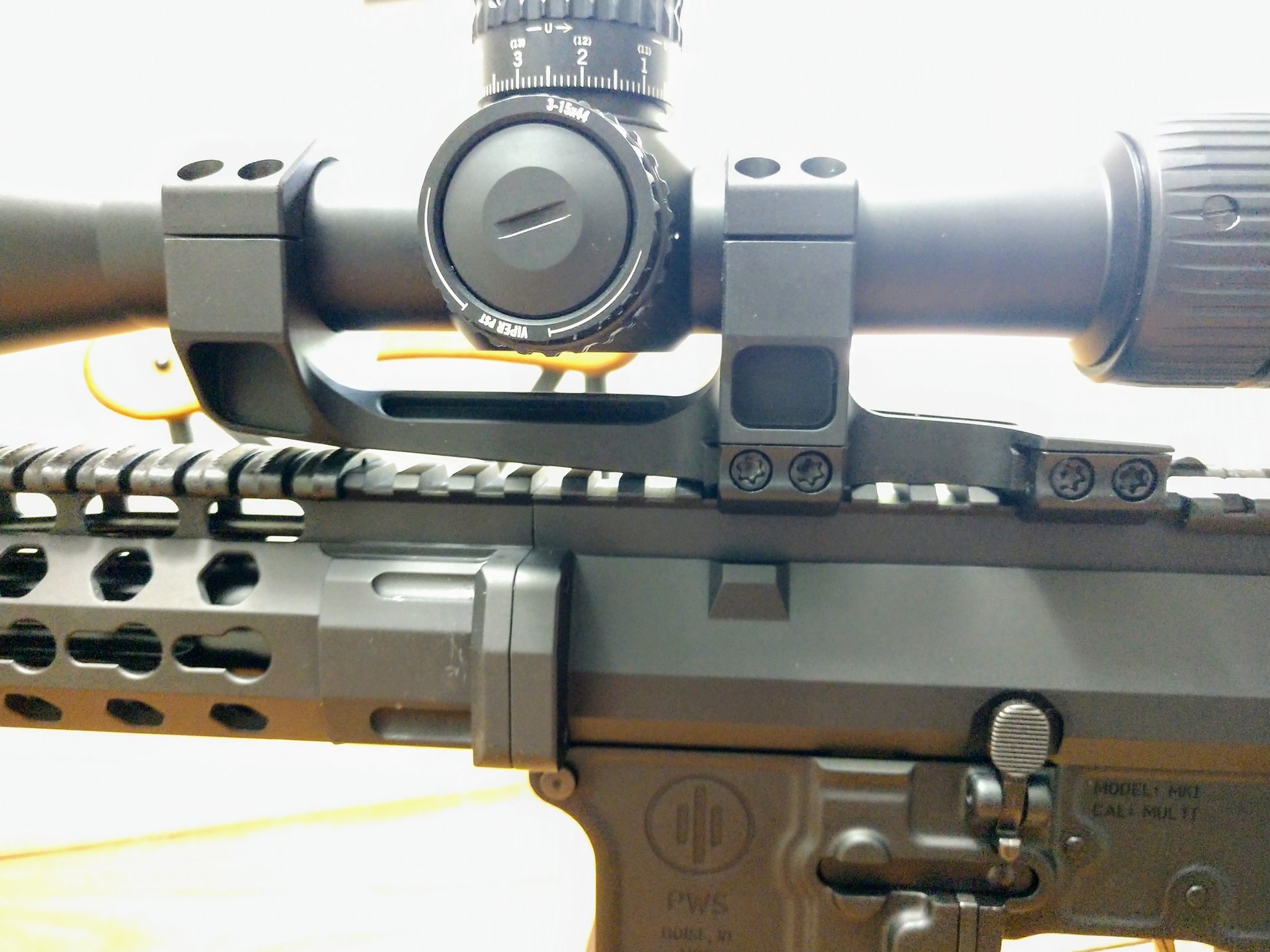

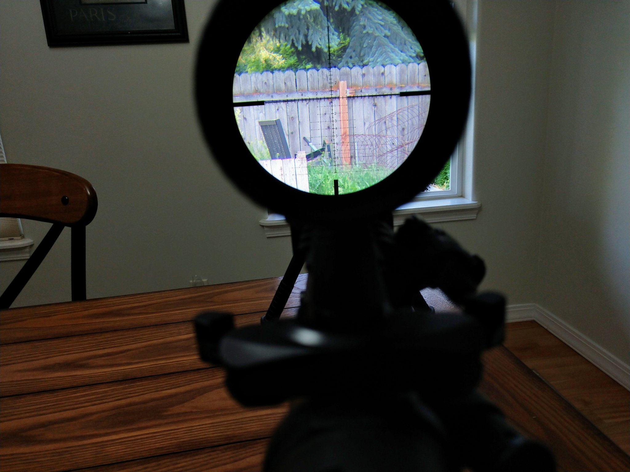

Here is an update on my recce rifle I got the Vortex PST Gen 2 3-15x44 FFP in today. it's a little longer and a little bit heavier than I would have liked but it's actually a very nice piece of glass I was pleasantly surprised for the price range. my neighbors fence is exactly 109 yards away and I can see the nails in his fence clearly at that distance at 15X, so it'll be more than adequate for shooting groups and taking it out to extended ranges. I'm going to have to send the vortex precision mount back, it's just too far extended to run my 45° BUIS, and make up for my 14.5" length of pull. My Luth mba-3 stock will be in tomorrow.
The extended cantilever mount has a good 3" extension which is a bit too much. Even with the scope set all the way back in the rings I'm still rubbernecking it to get proper eye relief, on top of that it makes reading my parallax adjustments impossible.
But I can't say enough about how pleased I am with the clarity and the quality of the Gen 2 PS2 3-15x44.

Very nice! I have the same mount and had to switch to another one due to the excessive extension also.

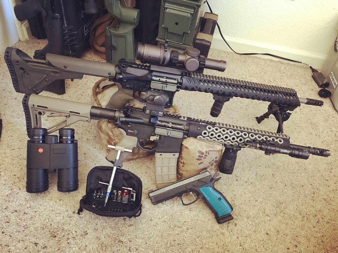

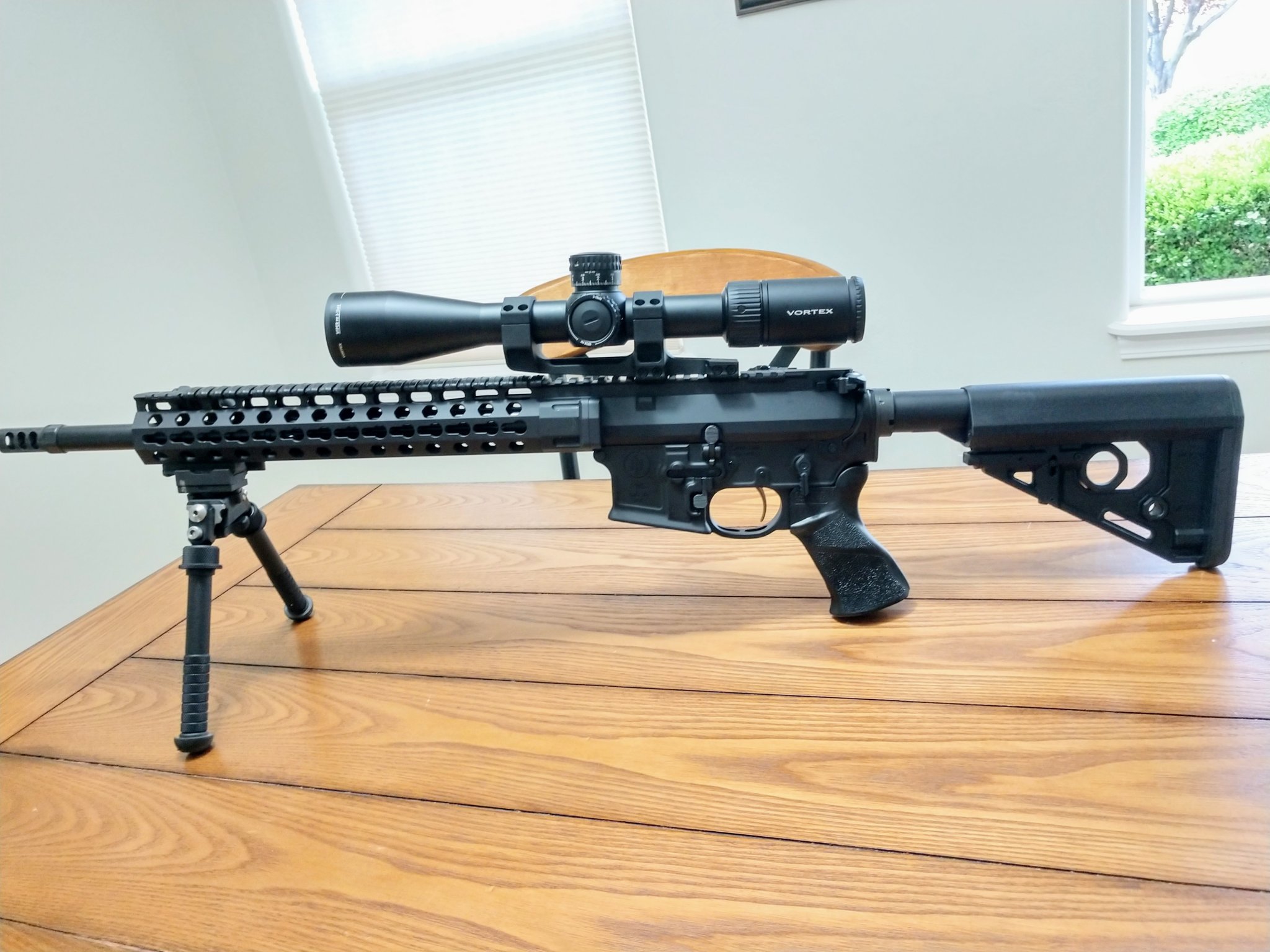

I put together a Recce rifle after reading the Navy's report on the Mk12. They wanted something more accurate and lighter and shorter if possible. They came up with the Recce rifle and I guess the basics are milspec BCG, forged upper and lower (Noveske makes a damn fine forged receiver set) I think they use the SSF Geissele trigger, you don't want the Hi-Speed, so I'd suggest the SSA-E. It's close to the Hi-Speed without any adj. and it's a little cheaper, especially if you're patient and catch 'em on sale at Brownell's. Then they have the Lilja 16" Navy Recce barrel. Contour is solid but not heavy, 1-8 Wylde chamber and it's one of the most accurate button rifled barrels you can buy. The grip, buttstock, rail system, optics and other shit were left completely up to the user, with KAC FF rails being most common from what I've seen. Most common stocks are either SOPMOD or A1 fixed, but it could have anything, UBR, A2, PRS, whatever. Optics range from Acog to S&B 5-25x and everything in between. It's also known as the "sniper M4" FWIW.
I put it together the same way, but I prefer the JP Ent. FMOS BCG or carrier at least. It's a lot slicker and more reliable, can actually run it dry in a pinch and it won't jam up. I use the Geissele DIY single set screw/single pin gas block. Super easy to install and the pin keeps it from coming loose. Lot cheaper than paying to have a pin on gas block unless you can DIY that yourself. Buffer and spring are just the basic milspec parts. I don't have problems with ejection or reliability. Mine has a Saker can but that's just a personal choice. The SOPMOD stock provides a nice cheek weld IMO, and it's turning up on more than just carbines these days. KAC uses 'em on full size SR25's now. Scope is MR/T in a 10MOA Larue QD mount (I typically use Badger but had this one laying around).
7091591
So there she is. It'd be hard to put together a better one, maybe a nice cut rifle barrel, but I went with the "specs" on this one since they seemed to have put a lot of work into coming up with this rifle. Leaving all the ergonomic features and optics up to the user really makes it shine as a military rifle IMO, so if you're into keeping the rifle "true to form", well, you can do that with this one and still use whatever parts you want for the most part.

I appreciate it. I’m going to note all of this for future use. I have a Sandman s in jail and would eventually like to build a nice SPR 18” upper. It seems like a fun rig to shoot suppressed.
When it comes to a precision upper, I would rather have someone skilled build it, vs me in my garage with some basic tools. I have no issues working on my carbines, though.
My pics above appear to have been corrupted, so please forgive the reposting. Sandman L on my CLE turned SPR. I sent CLE my Vltor MUR and Mk16 barrel nut. They turned the Barlein barrel, installed it with the barrel nut., and then sent it back to me. I installed the rail, FH, scope and built up the lower. The barrel and barrel fit to the upper is the most important part.
If I can do this, you can do this.
7091879
7091880
I appreciate the vote of confidence. Seems like one heck of a shooter. I agree with the barrel fitment sentiment, which is why I would prefer that be done like yours. I agree, I could handle the rest from there.

You will want more than 10x on the optic. 3-15x Razors are a good deal, but there are many others.

So an update, I've been researching loads for this rifle (1:7 18" WOA Wylde barrel) and I think the bullet for this build is going to be the 77gr Sierra Match King. Been watching Johnny's Reloading Bench on Youtube and he's got the same barrel and had excellent results with Accurate 2520 and Varminter Pro powders, so will just try to start low and duplicate his ladders.
Goal is to replicate whatever the Black Hills 77gr Mk262 ammo does out of this barrel.
(Ideally less than MOA groups, 2750+ fps, and not destroy brass doing it.)
Unfortunately, my range has been closed the last month, and other stuff, so I haven't gotten around to upgrading this rifle or making ammo for it.
I'm also going to get a LaRue MBT-2S trigger to replace the single stage. This build is designed to be a "Gucci minus one" build with components, so not top of the line premium but as close as possible without breaking the bank.
It already functions adequately with 55gr and 62gr standard NATO loads but that's not utilizing the full potential of this barrel.
Waiting for July 4 sales to pull the trigger on a decent scope too.
