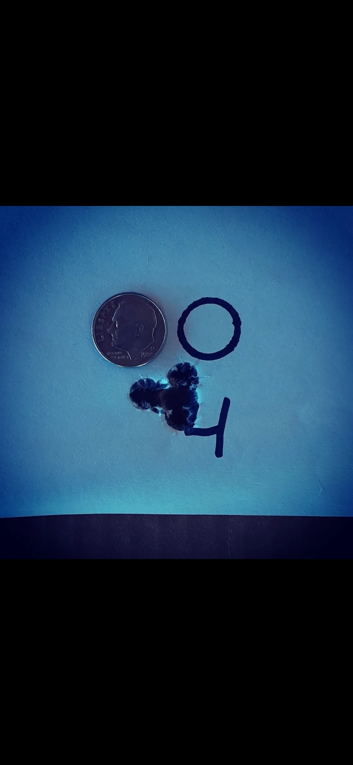

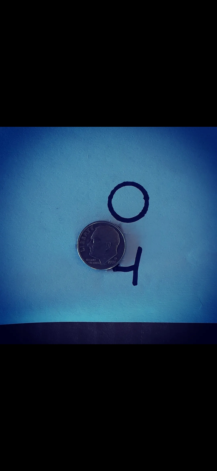

I recently bought myself a Tikka Tac A1 in .308 Win. Lots of affordable ammo showing up for plinking. I'll end up rebarreling it but I'm going to enjoy it for awhile. I worked through the Satterlee 2.0 load development with 168 ELDMs and found a winner. Screenshot_20220318-182045_Gallery.jpgScreenshot_20220318-182037_Gallery.jpg
Reactions: Furtaker2506
