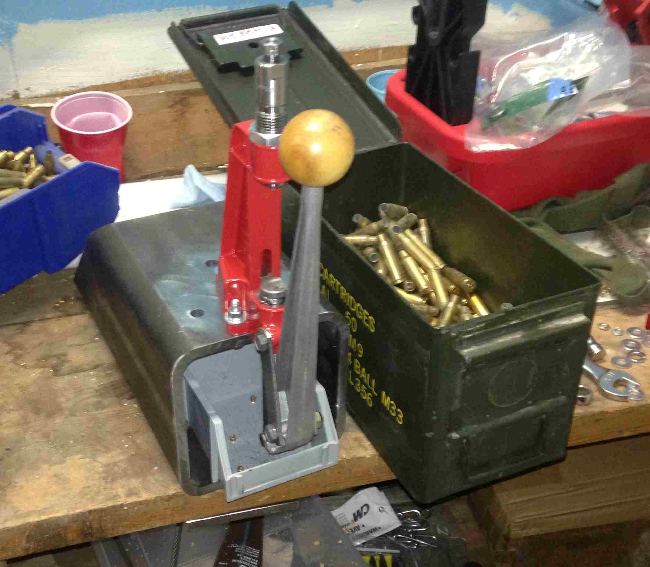

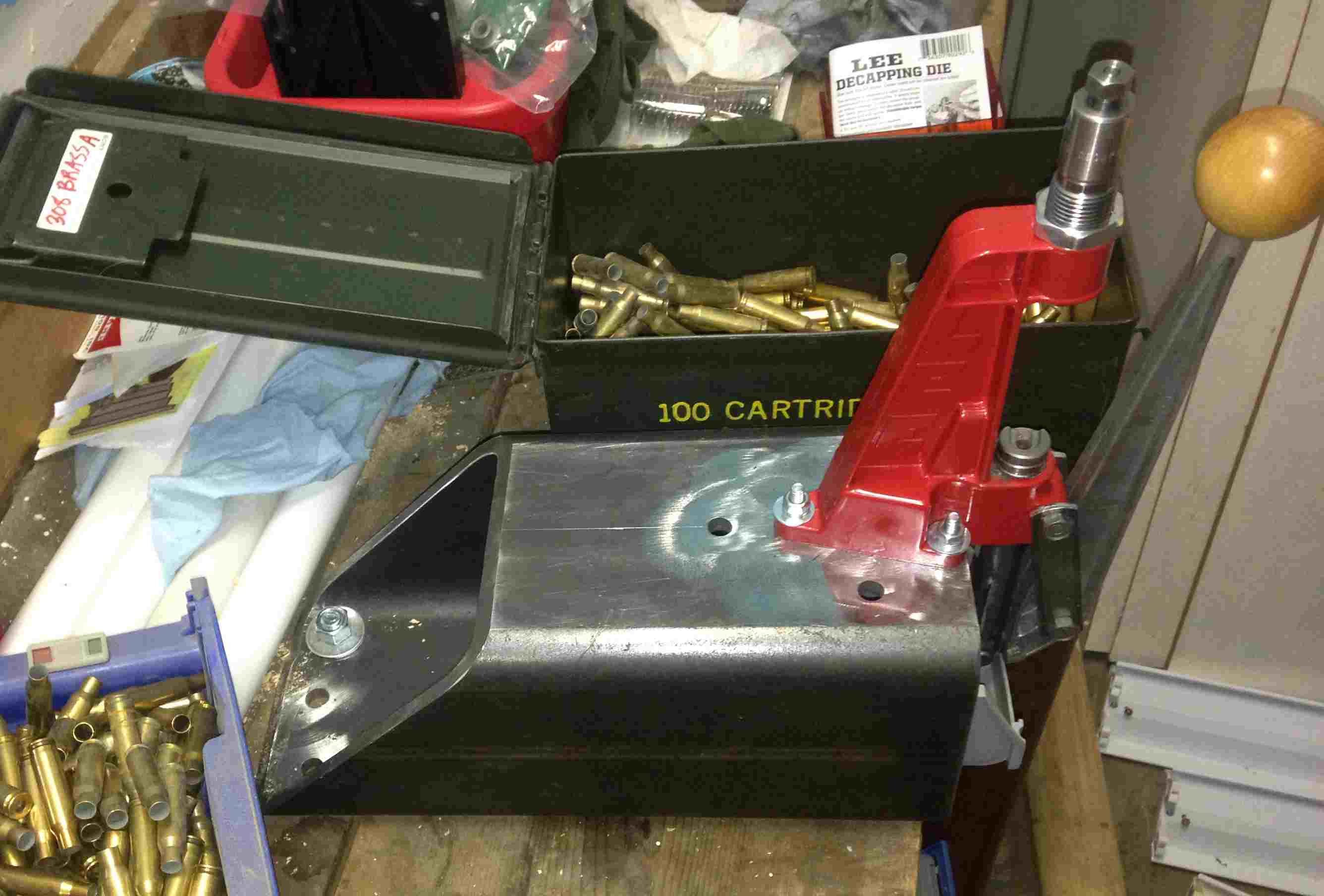

Photos of the $27.00 Lee press I use for depriming and running a mandrel in case mouths. Primers fall through into the catch box inside the tube.
