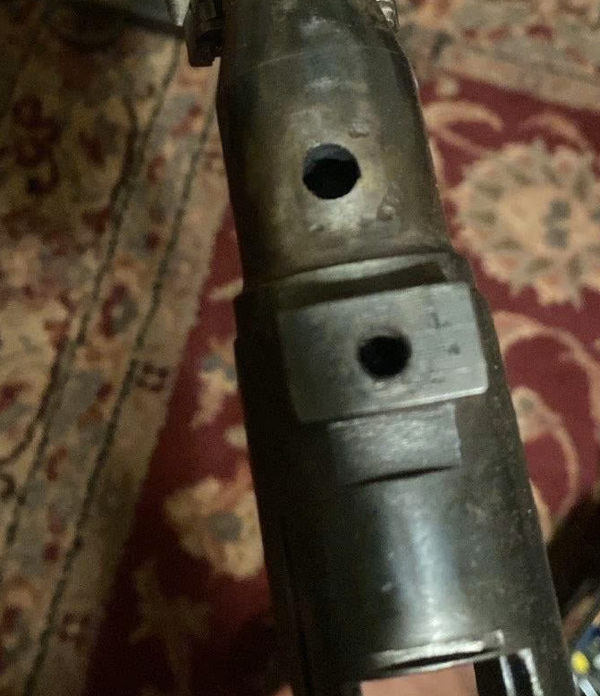

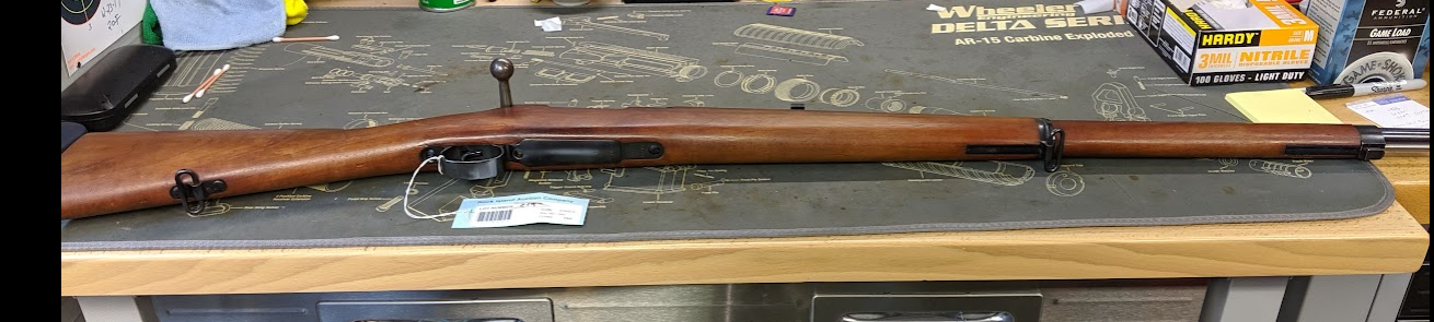

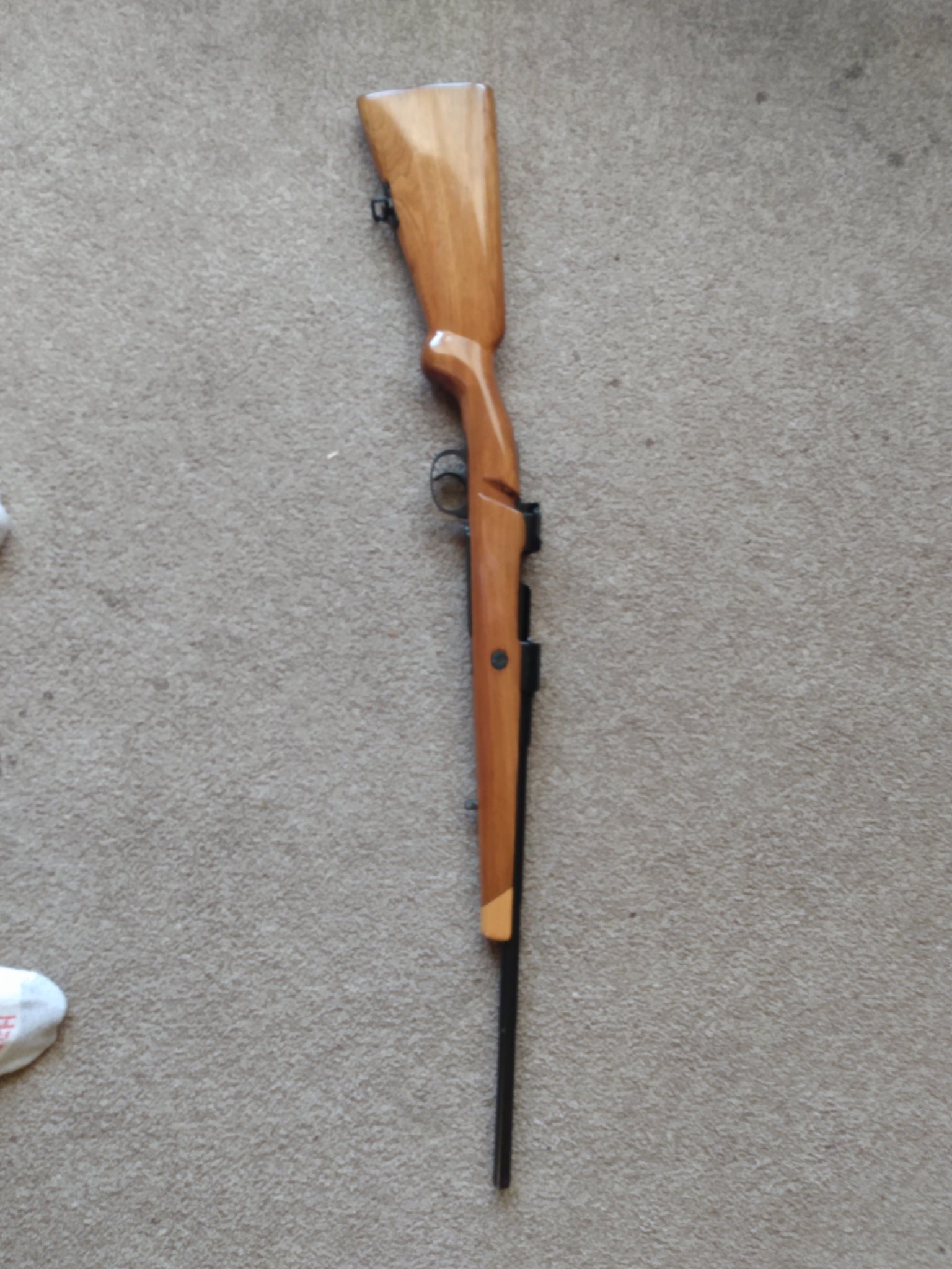

Help I need a bolt for this Mauser. Nobody can tell me what cal or model.
I wish I knew. I've taken it a couple places and gunsmiths acted like I was waisting their time. I just bought a bolt for it. It fit but 1/4 inch or so short. No caliber stamped anywhere. Just Bulgarian made for Venezuela is all I'm gathering. It was great grandpa's gun. And come h*** or high water I want to hunt with it. Any information you can find is awesome.

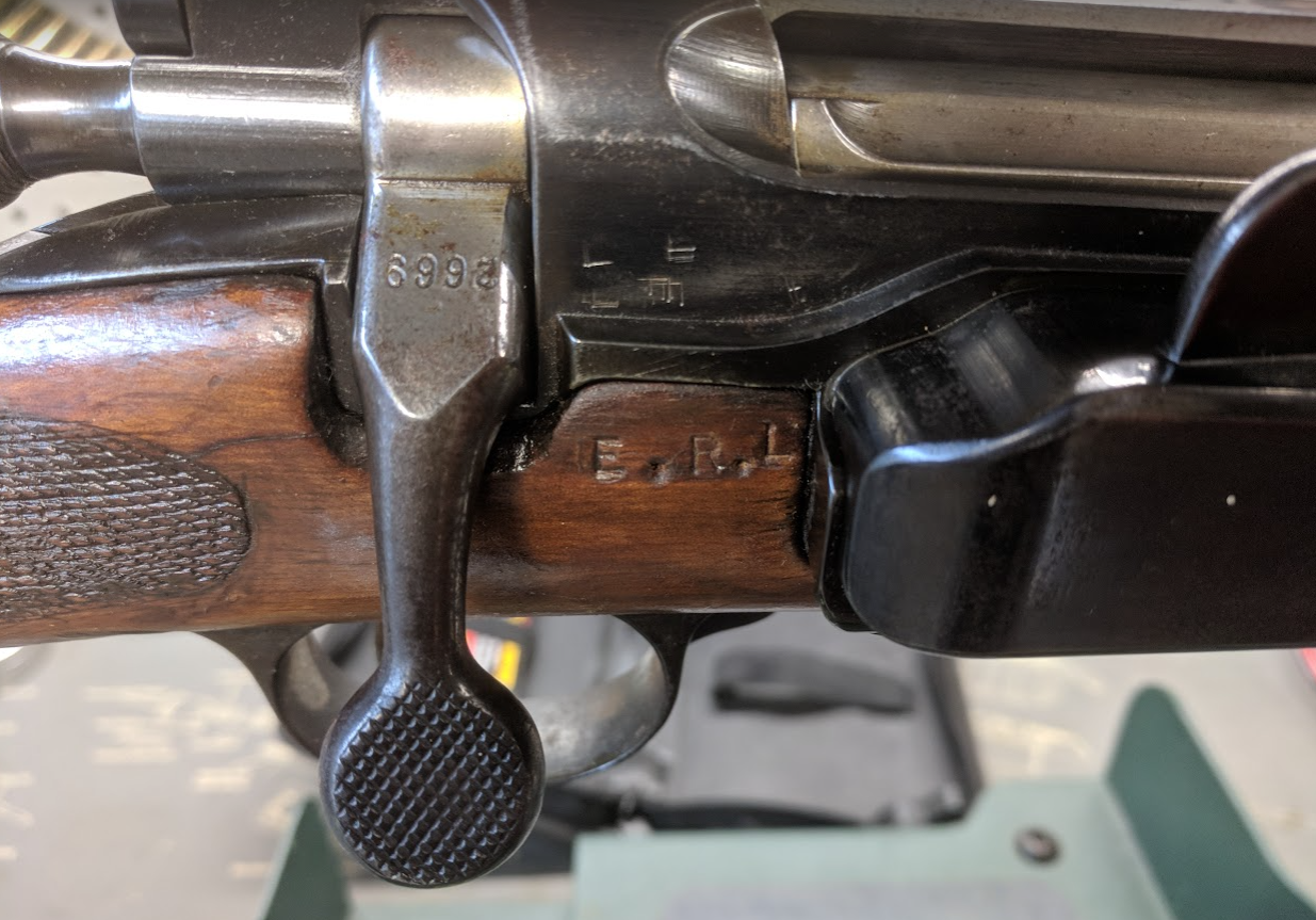

If anybody has any ideas I'm open to listen. Advice is free. Experience takes money. Think it's 7.62x39 but don't know. Just rebuilding it because of who's it was. Like to hunt with it maybe. Sights my next hurdle.

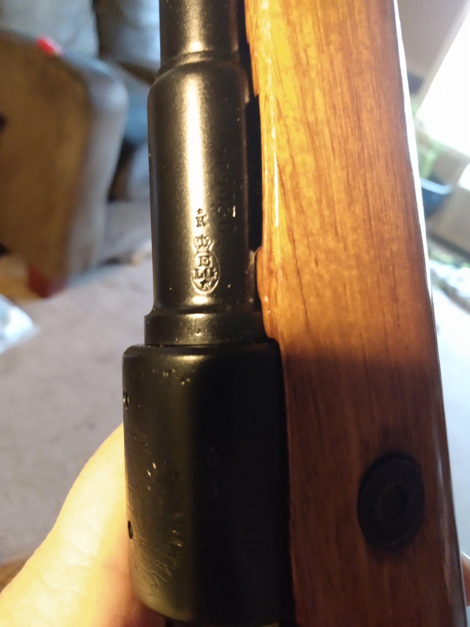

I take it back, it has the Belgian proof marks on the barrel so PROBABLY still 8mm Mauser, but doesn't have to be.
Reactions: Bibskid

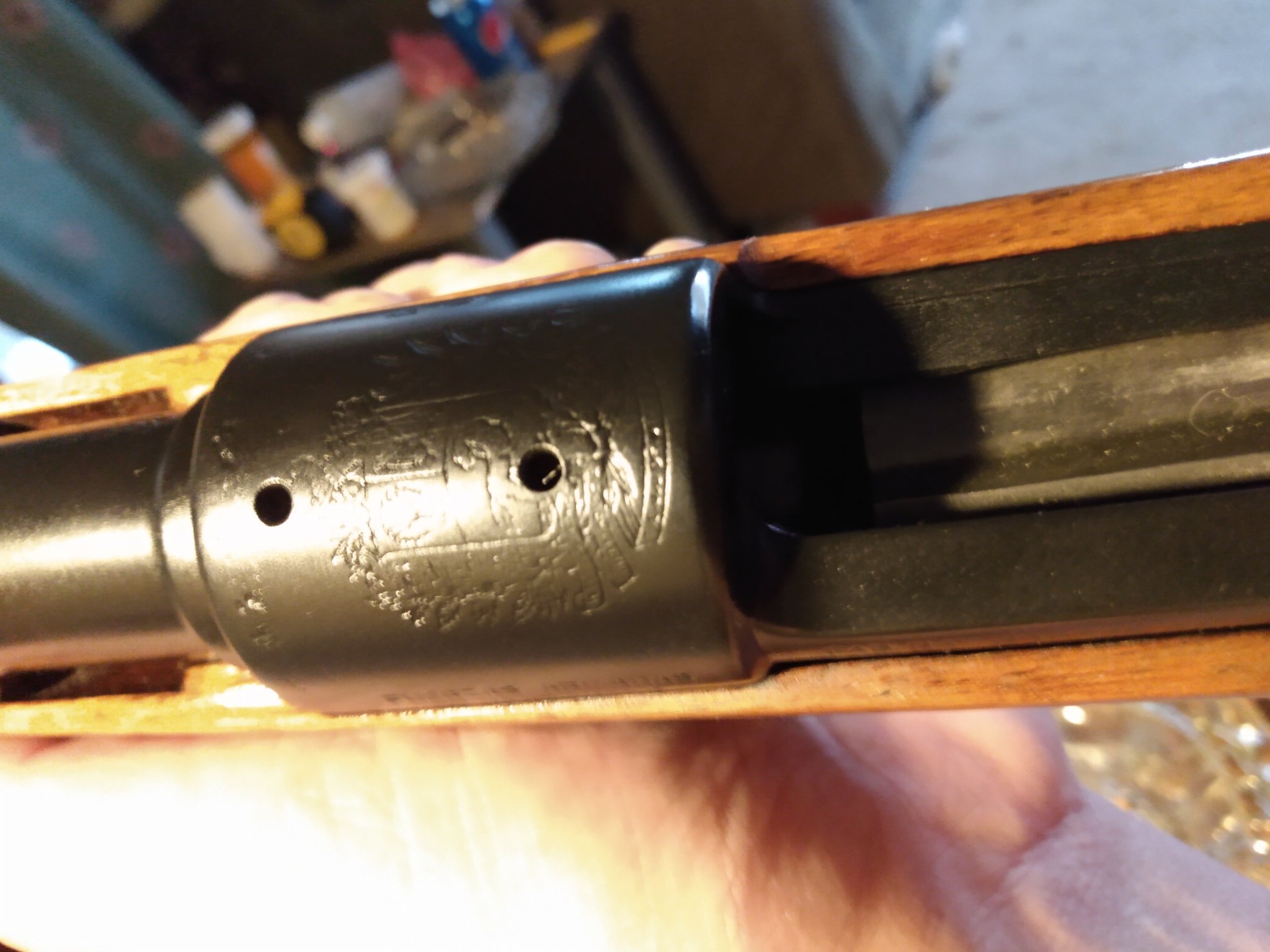

FUERZAB ARMADAS
DE VENEZUELA is one stamp on receiver and
FAB. D'ARMES DE BELGIQUE BOTH ON LEFT SIDE OF GUN....THEN A CROWN WITH E above LG. The bolt under ring has a C stamped in it. The only other stamped number is ser. number both barrel n receiver numbers match.

That is a FN made Belgian mauser for the Venezuelan contract.
Almost certainly still in 7x57 Mauser as the barrel appears to have the original Liege proof marks on it.
It appears to have been reblued and drilled and tapped for a scope, which is a shame as they are pretty scarce mausers.

If there's no stampings on the barrel, and without better pictures to tell if it's the original barrel, there's no way to know without a chamber casting. Unlikely it's 7.62x39

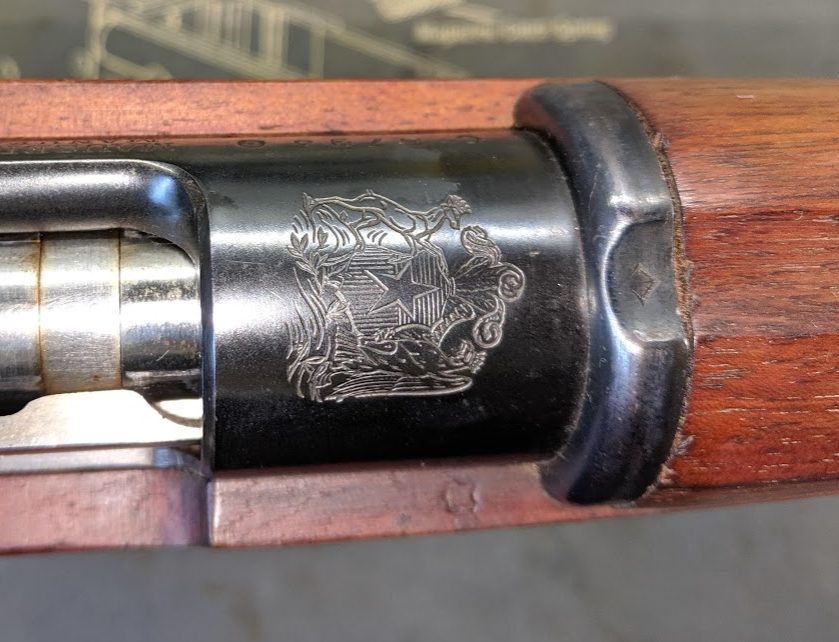

That's the crest. Barrel has same number as receiver

Thank You so much. Numbers on barrel and receiver match. Yes it is a shame. Wasn't done as good as could been. All I need is a bolt. Handle snapped off this one. You don't know how long I've been fishing for this information. I had to reblue the gun before rust got worse. With holes drilled in it. Makes it ugly. Thank you again so much.

If you have the parts from the original bolt it might be repairable. Guessing whoever turned it down when sporterizing it did something wrong.
I have old bolt. No handle for it. I can weld but gun parts are different from stock cars. Have a wire feed welder.

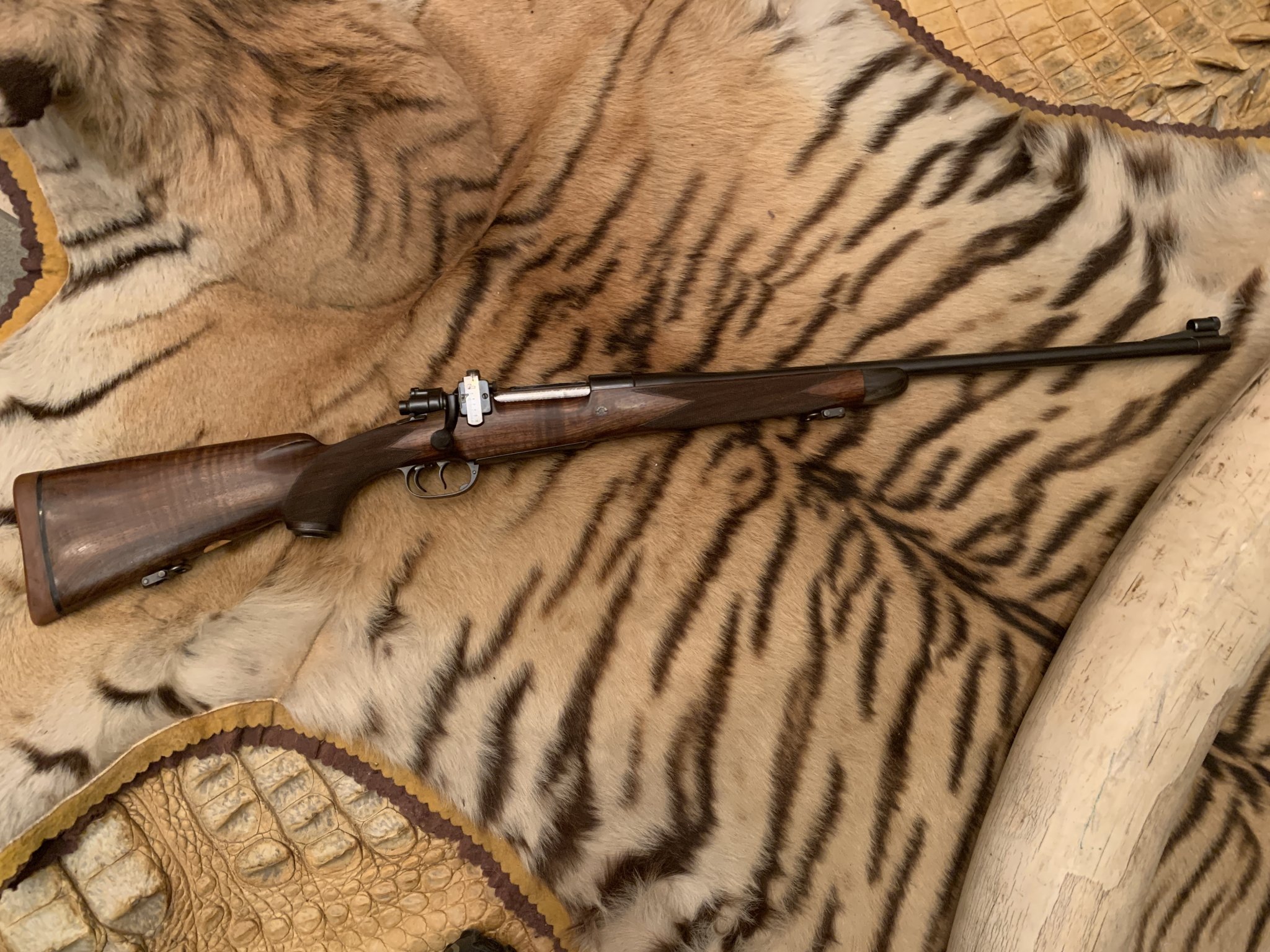

I hate the term "as issued" but I do think my Chilean is about as close as you can get. Over 100 years old and she still looks this good, she turns heads where ever she goes.
It could have just as easy been used like this one. This one belonged to my father in law and his brother. The story he tells is the usual 1950's bought it out of a barrel at the hardware store, and they bought the krag because they could not afford the $25 for the springfield.
These people back then are typical old country boys from Tenn. A family of like 8 kids, and they used this rifle to poach deer, yup, poach. Had to feed the family and this is how they did it.
They did make that krag pretty however......but I guess really eye of the beholder kind of thing.
Point of all this is....well aside from showing off pics of a pretty and not so pretty rifle....is to say there is a great deal that could have happened in its life, you really want to be as sure as you can as to the safety of shooting that rifle.
