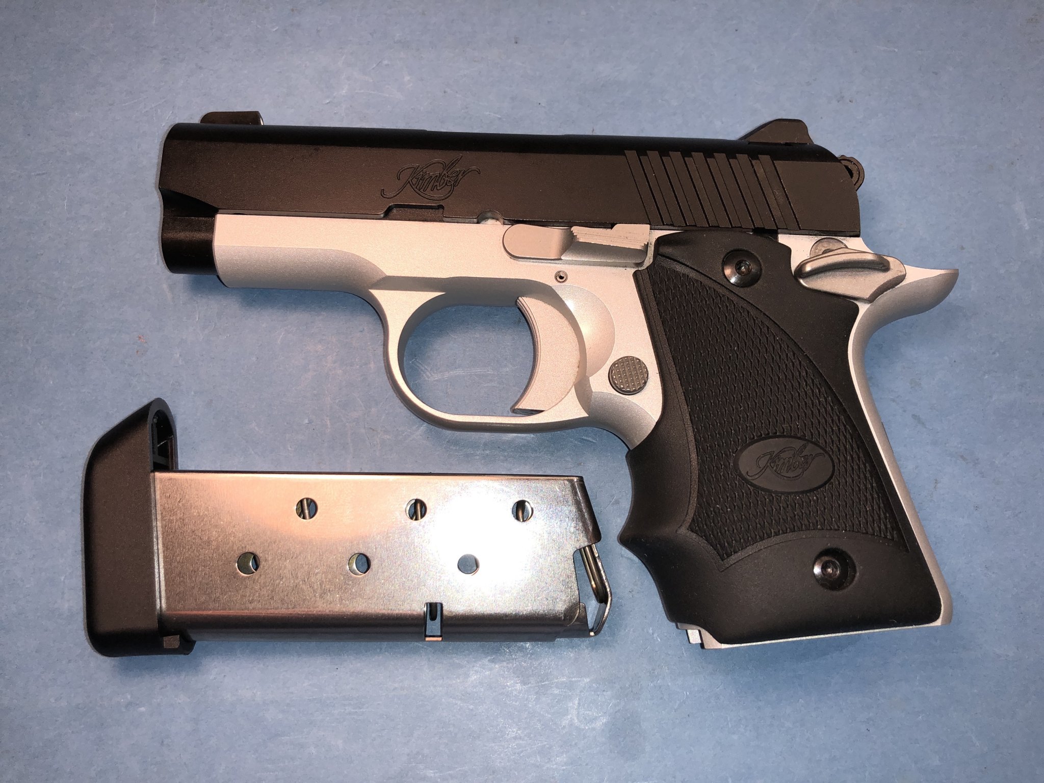

    I only have 2 Kimbers, a Micro-9 and Kimber .45 Ultra CDP II. Need to be careful with slide

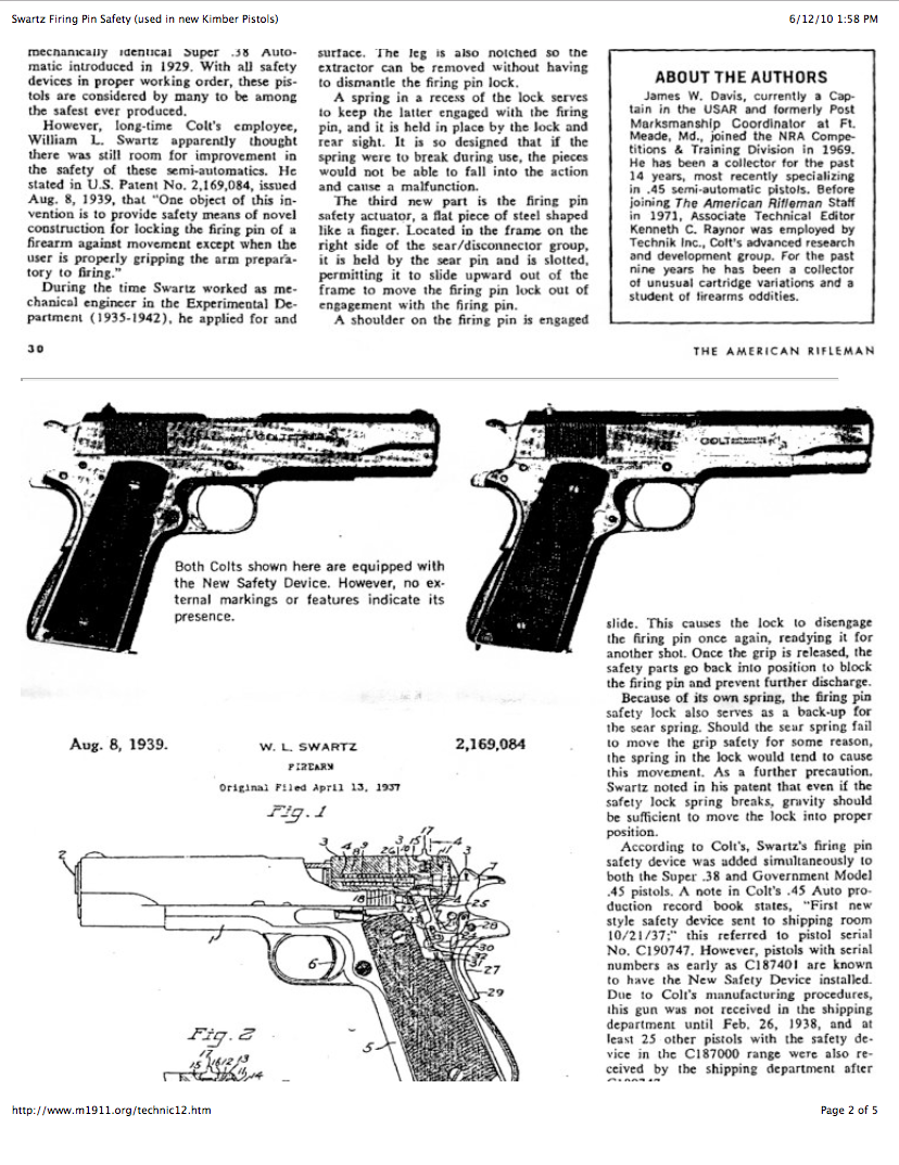

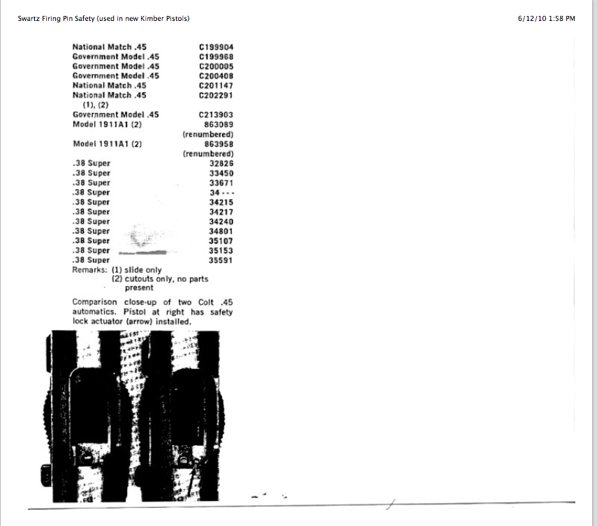

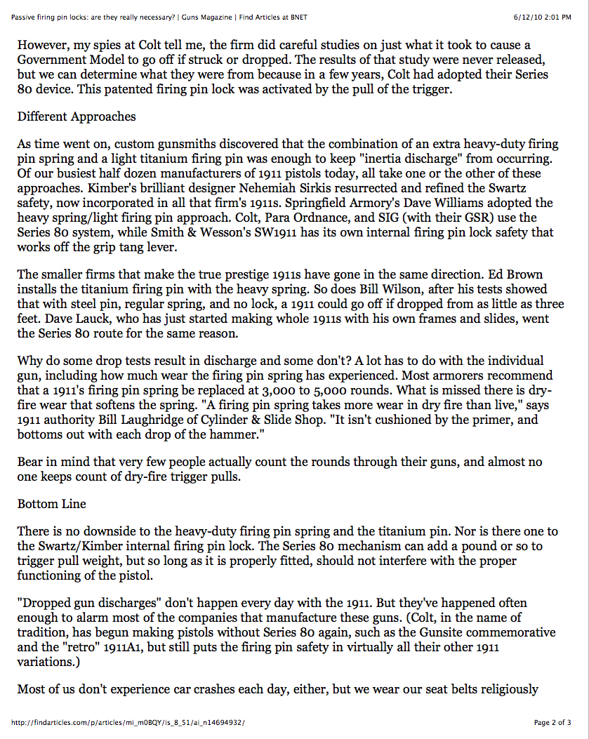

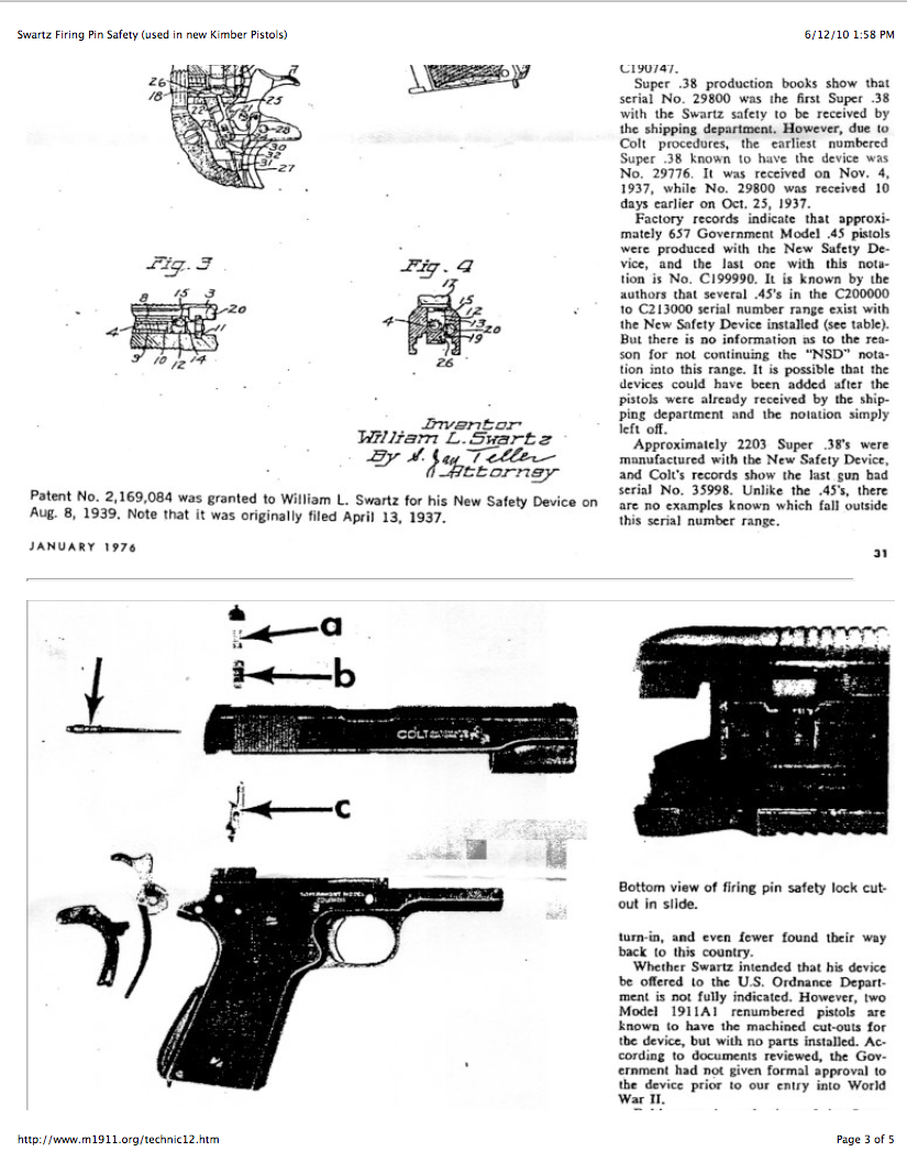

    Some background information on the Schwartz safety mechanism.

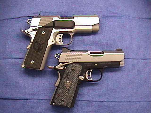

    Kimber CDP size compared with Colt Officer .45 ACP

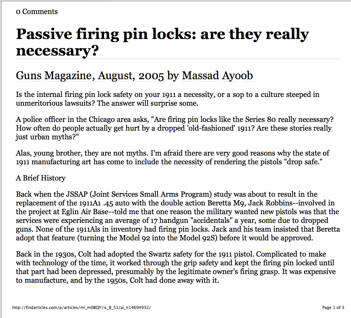

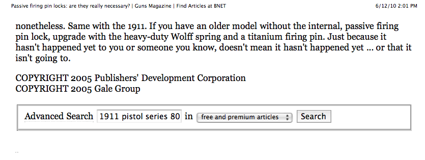

    In lieu of 1911 style pistols with no firing pin block (series 70) or those with firing pin block (series 80, belt & suspenders philosophy) conventional modern 1911 mfg.'s employ a heavy firing pin spring combined with a titanium firing pin, which almost reduces the chance of a dropped pistol discharge to 0.1% or less, which doesn't interfere with the trigger pull mechanics / minor added trigger pull weight. Bill Wilson studies demonstrated 1911's employing standard firing pin spring weights, steel firing pin and no block could discharge with a 3 foot drop test.
