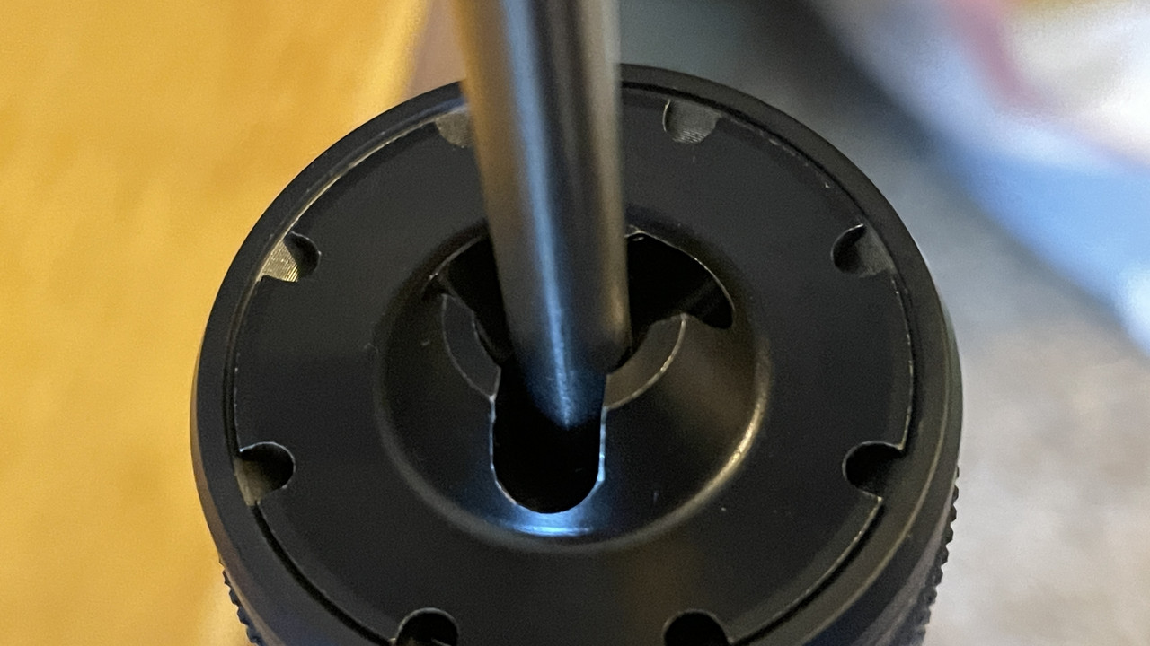

Small update. I reached out to Dead Air. Got a response quite quickly and they requested photos which I promptly sent in. They said it needs to be sent back and not to shoot through it. Got another response from another representative higher up about some of my other concerns. I did appreciate the quick response. I did not get a time estimate and I did ask. If it's going to be a year, I might as well buy another can although the new Huxwrx Flow 762 did really well on a 5.56 SBR and I have one of those in jail currently. I'd rather not buy another can at this point TBH.
I also reached out to the shop I purchased the suppressor to let them know along with a suggestion to inspect suppressors visually right after purchase along with available stock on hand. We'll see if they respond.

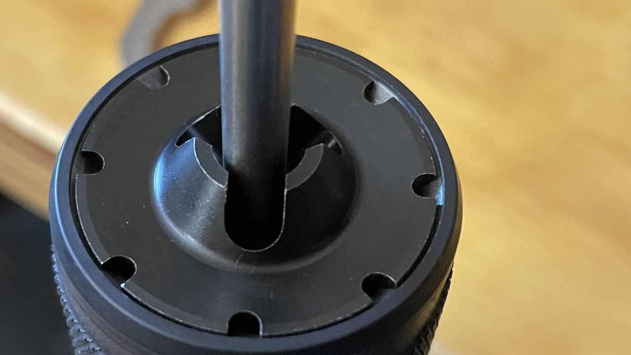

I also checked for alignment and it appears it's off by a hair to one side. The HUB mount also sticks a bit after 1/3 of travel. I think it's the HUB adapter and not the suppressor as the suppressor threads look very clean. It'll thread in but you continuously encounter resistance every 1/3 turn until it's tight. Maybe the HUB adapter itself is ever so slightly off.
I've used a 7.62 suppressor on my SBR and it's definitely centered. So I know it's something to do with the DA can, HUB mount or muzzle device/mount (flash hider).
Bad side. It's visibly closer to one of the tongs. A bit hard to see as the rod is long and almost impossible to do a dead center shot so a bit of parallax error. But definitely there as when I rotate the rod, it stays the same.
Good side.
