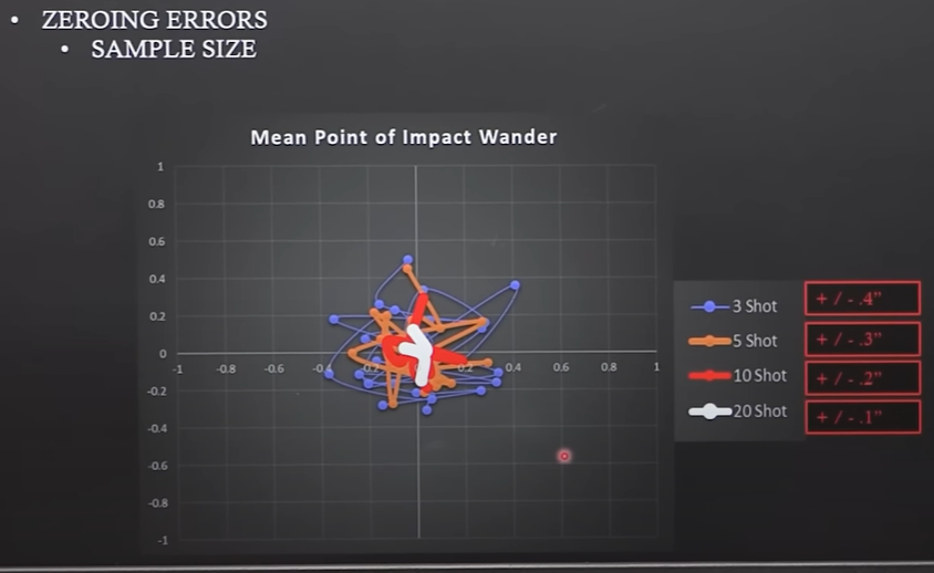

In a nutshell, the first 38 minutes shows what happens between two different rigs as the number of shots in a group increases and the total number of shots sampled increases.

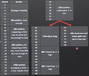

At 51 mins, they discussed the number of shots used to establish boresight zero.
At 1:00:00 they walk through the cost of making the mistake of only using 5 shots to check a zero, then walk though the stack of errors that creates as the number of shots are wasted at longer distances.
In the above example, the shots were going low at distance, so the ballistic dope was incorrectly adjusted and caused 49 shots to be wasted. The arrows are a decision path that shows what would have been discovered if the 100 yard zero was re-checked... only to discover that the real error was caused by an undersampled zero that was actually lower.
At 1:12, they mention mean radius is applying the weight of all your shots, versus group size being similar to just using the ES.
