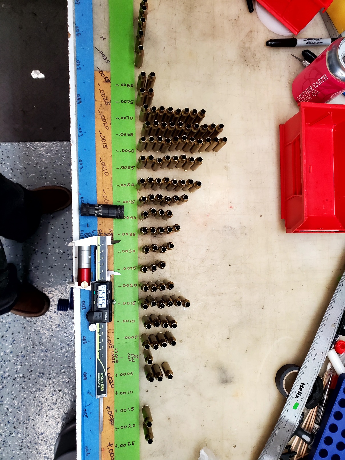

I just did a test this weekend with random headspaced brass from +.0025 forced close to -.010. and didn't have any pressure issues.

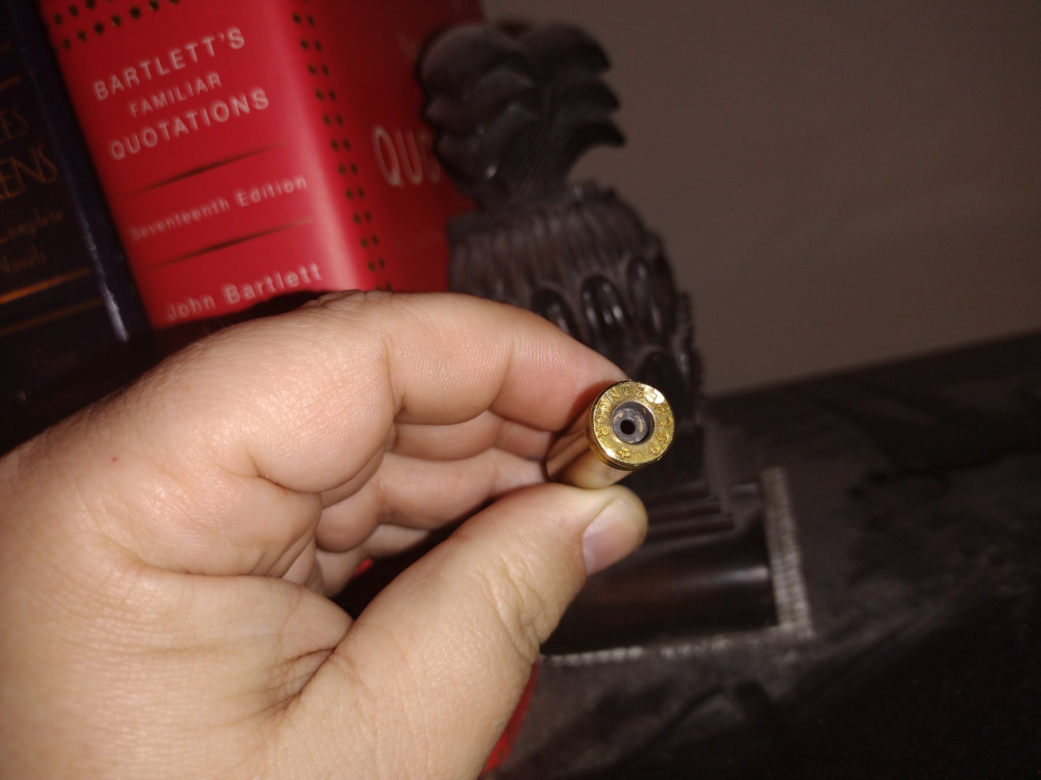

I understand the skepticism. Measured brass is actually oversized and shows drag marks on a markered case at the top of the case body. Headspace would have been super tight (0.006 over virgin brass of same type), and OD was 0.005 over the same at various points on the case body. Point being it was not chambering correctly and thus not formed properly (thats on me) Ejector Swipes are not consistent, only 4 primers came out and no brass was dirty. I didn;t notice the missing primers as I put my brass in "primer down" and there was no heavy bolt lift at all.

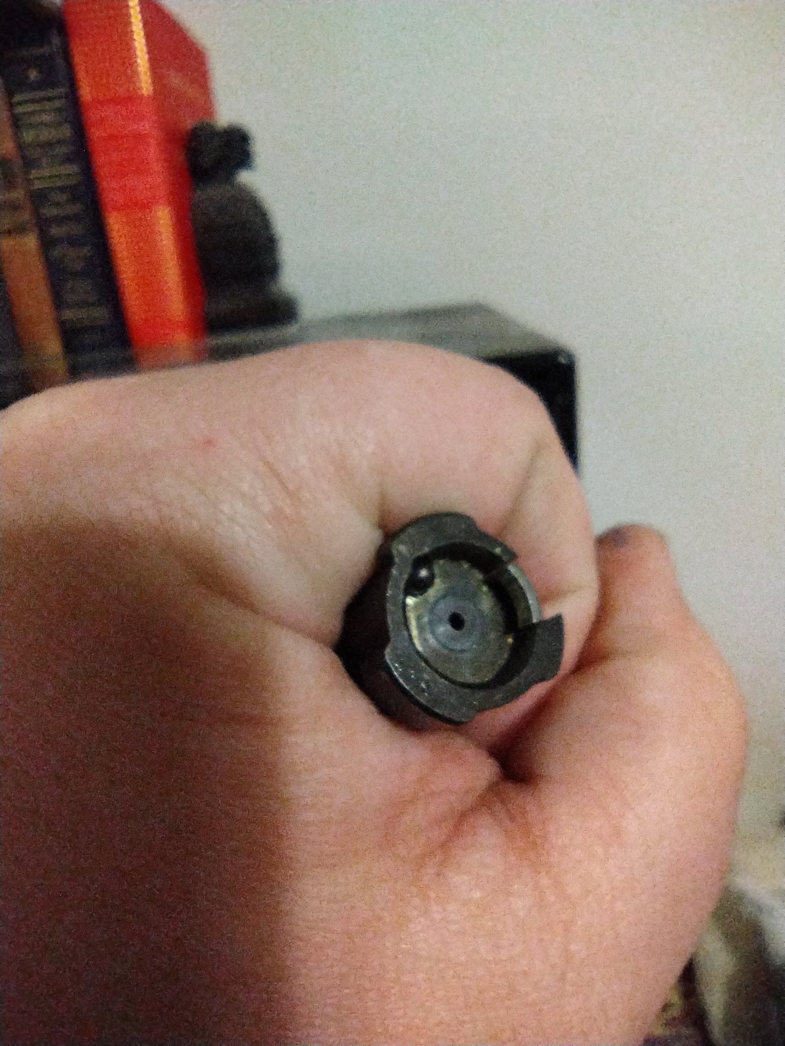

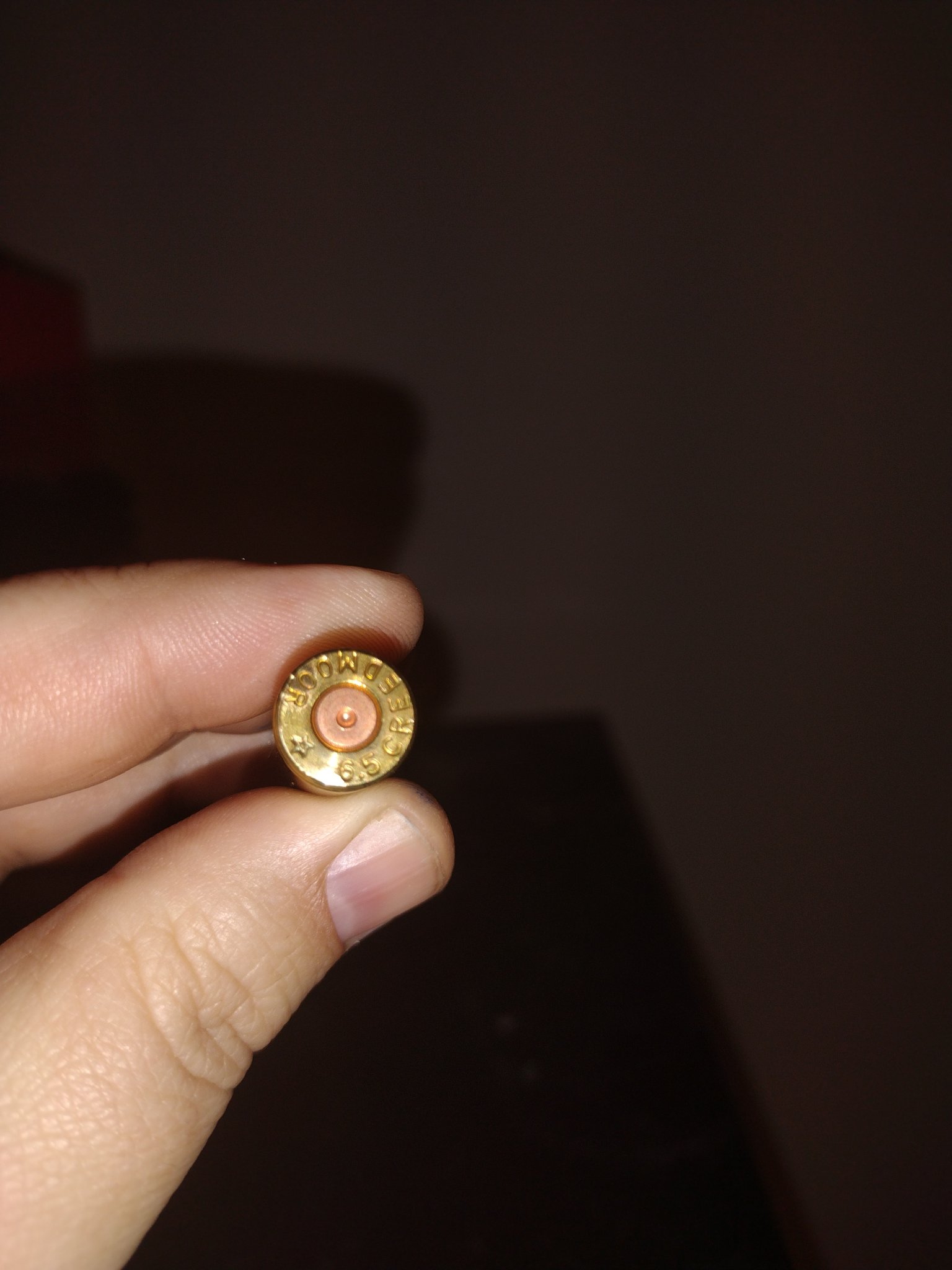

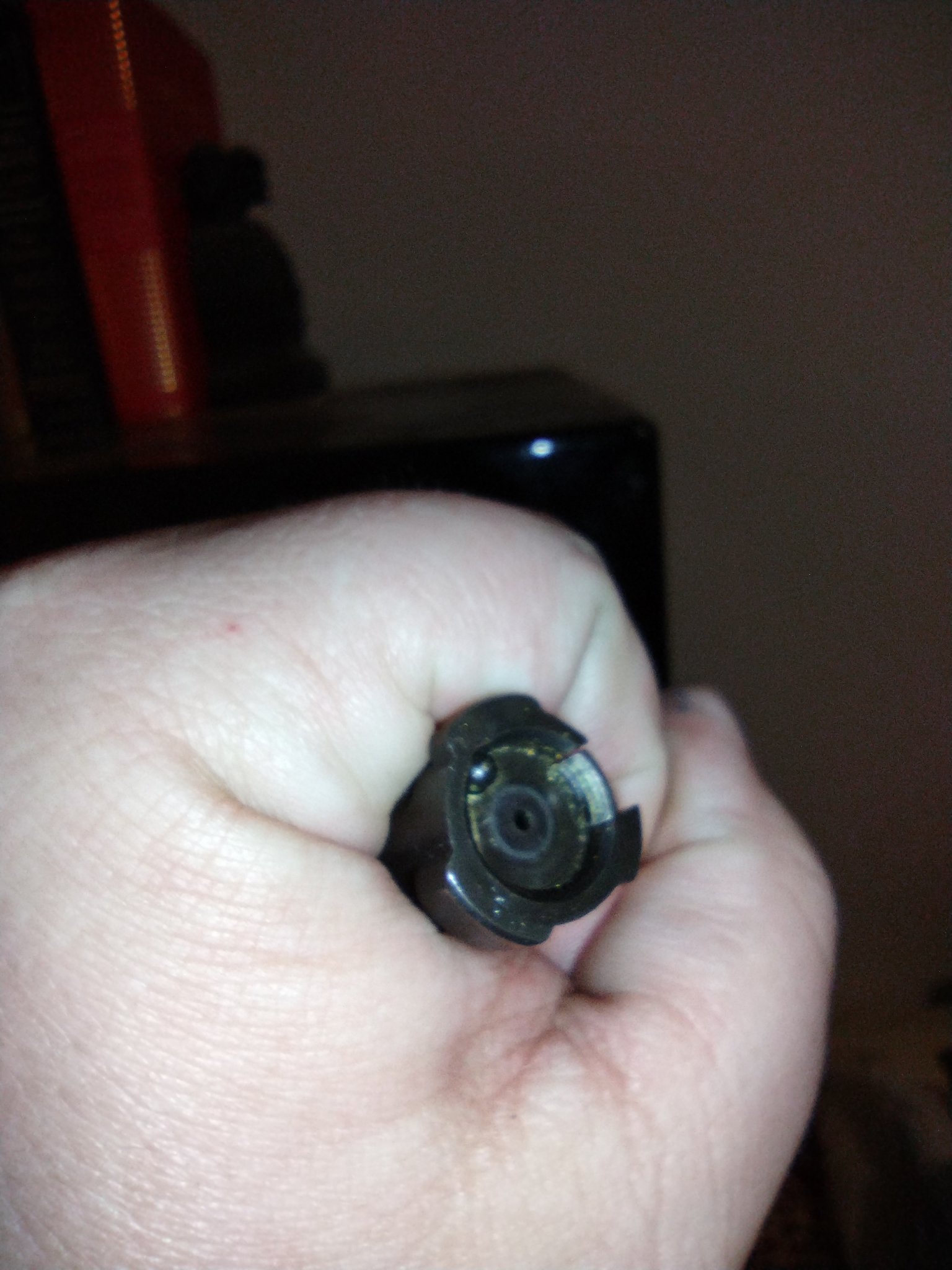

Brass were primer came out looks the same as normal deprimed brass. Maybe primer pockets are just loose. Either way, its enough to restart my load process from square 1.
we're the primers that fell out flat? severe swipe? brass pushed into the ejector?
Nope. No brass into the ejector. It was a light swipe on a few cases. No cratering (i know not the most reliable sign) and no heavy bolt lift. I would be surprised at the loose primer pockets as this is only round 2 (starline brass), but it could be. Ejector swipes are a little more "shiny" than the rest of the brass. (uploading some pics in a bit)
You can see the swipe marks in the top--its pretty evident here, but you definitly have to hit the light right to see it. Present on maybe 1/3. Also this is one with the primer coming out. Then we have one that fired fine and pictures of my bolt trying to get the light into it. You really have to look for the ejector swipes unless the light hits it just right.

I looked up what a donut was, and tbh i don't think that's it as the bullet wont even go in the the top of the brass. Only the boat tail sits there.
Which means I might have super tight brass. I measured the ID and its still at 0.260 on a fired case
I’m not sure how you are measuring the ID, it’s tough without specific tools, but the dead giveaway is a bullet. If your bullet won’t slide into a fired piece of brass which hasn’t been resized, you’ve got a clearance problem. Like @Taylorbok said, you might have a neck turn chamber. I’m a little confused how your loaded ammo is .290”, but your bullet won’t slide into a .295/6” fired case. Could you confirm those figures?
If a bullet won’t fall freely into a fired case, then there’s a donut forming in your brass, that’s your culprit.
Not necessarily. A case mouth curled inward will prevent a bullet from falling freely into the case.
That’s because the case mouth is curled inward.
