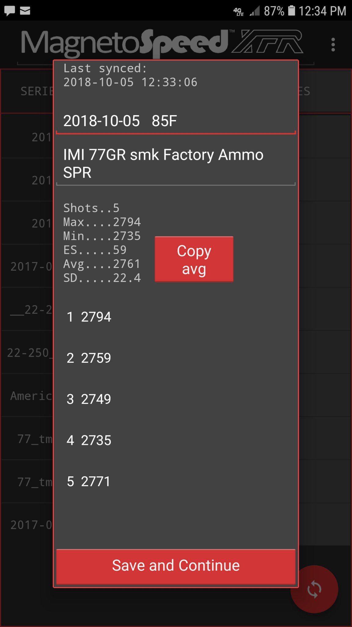

I ran some out of my 1:7 WOA 18 in SPR barrel yesterday and a 5 shot group over a magneetospeed was as follows

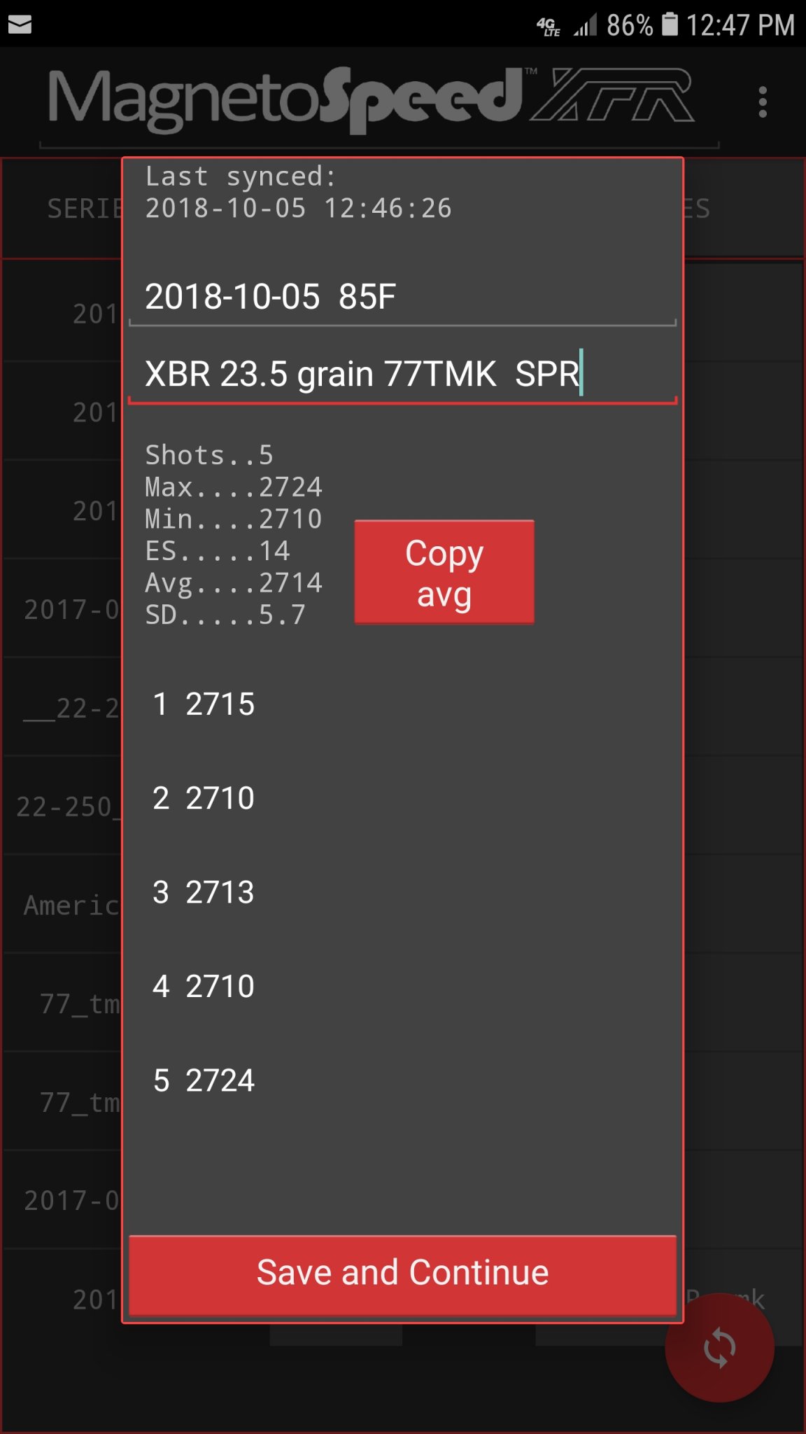

And testing my XBR 8208 77gr TMK Load yielded this
