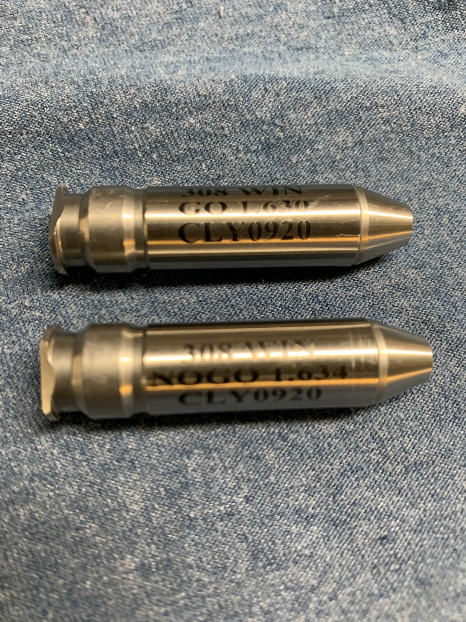

    I finally got a benchmark 308 barrel on my Impact 737 action at 75 ft lbs.I checked it with Clymers Go and No go gauges.the problem is the bolt closes with very little if any resistance on the No- Go gauge.Is this normal?Can the rifle be fired?should I send the barrel back?

    I'd put one layer of scotch tape on the no-go gauge. If it won't close on that then I'd go shoot and be happy. This is just to verify that the headspace is at least very close to your no-go and not way too long.
    This is likely just an issue caused by a difference in headspace gauges. The gunsmiths gauge could easily be off by .002" from your gauge. As long as you resize your brass correctly this shouldn't cause you an issue for the life of the barrel.
    If the scotch tape on the no-go still allows the bolt to close then I would contact the gunsmith that made the pre-fit and give them a chance to fix it.
    Also, if you don't like the scotch tape method then order a field gauge. If it won't close on the field gauge you are good to go. If it will close on a field gauge the barrel needs to be fixed by the gunsmith.
    On another note. I have never seen headspace being a little on the long end of the spectrum affect precision negatively.

    Yep check with scotch tape. If it doesnt close your g2g. If it does, Id be sending it back. Ive seen gauges different in the same caliber from one maker to the next....
