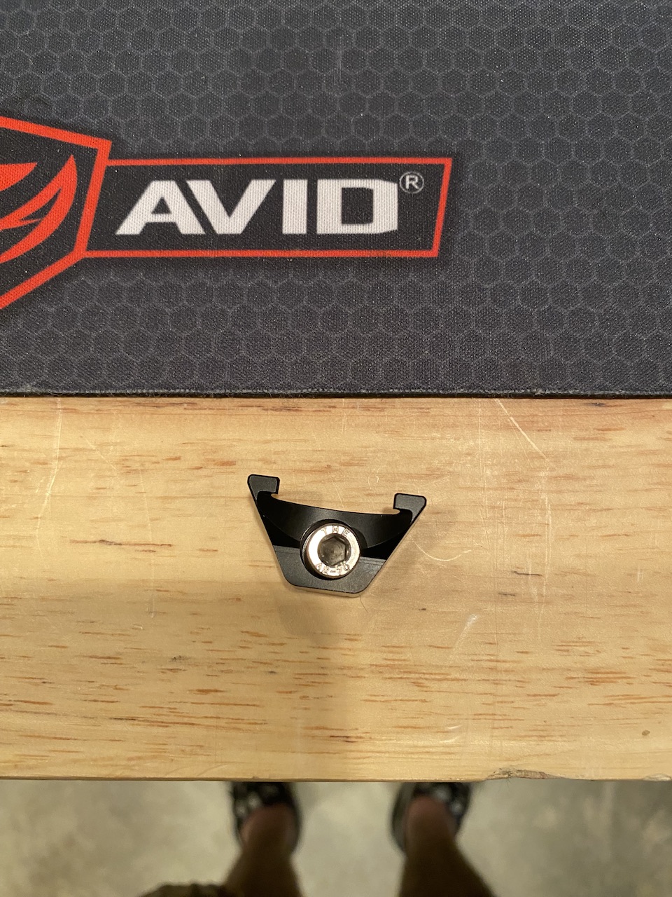

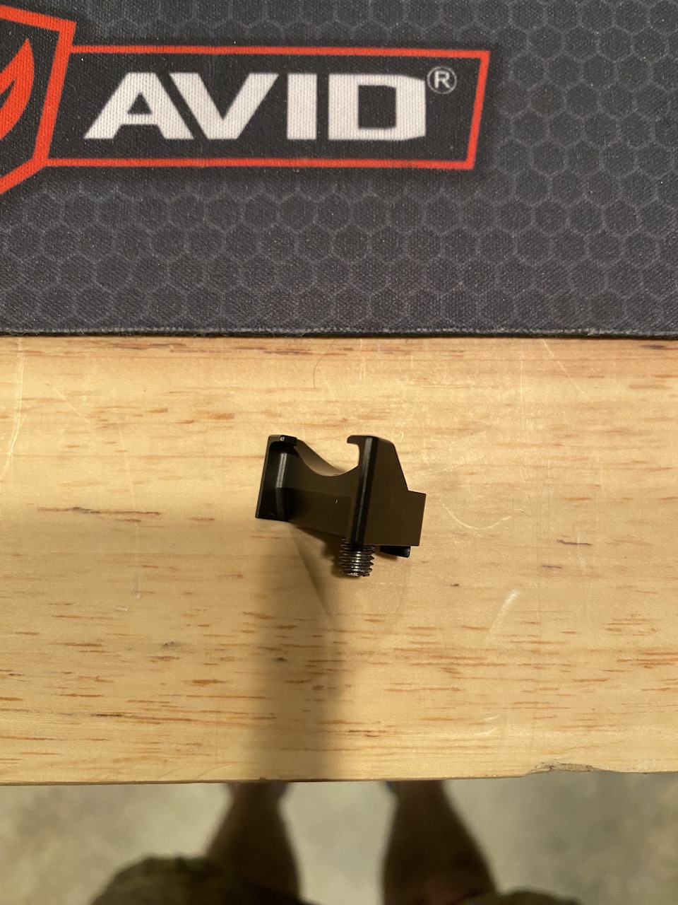

Building a rifle with my son and we ran into an issue. It appears the AICS mag block (?) is causing some issues keeping the action from going all the way down. We had to remove it to get it to fit around the trigger hanger and lower portion of the action. Pics attached.
Is this expected? Should we have done something different? Given the bolt head was there, grinding didn’t seem like the right approach. However, I”m unsure if not having the middling of the action supported is meaningful.

I run my 737 action in the AT-X chassis without the mag block and it's pretty much perfect. Just remove it.
Excellent. Thank you for the advice. Out of curiosity, are you using AICS or AW (or AX) mags with your Impact?

Does the mag block and bolt hold the chassis together in any way or support anything? What is effected by removing it? I can't find any pics of the AT-X showing where the mag block is located and exactly what it does. I would assume it's there for a reason.
It limits the height of an aics mag. It's needed in that situation, however it needs be removed to run aw mags. It's not structural by any means to the chassis.
We took it out of my son’s chassis and run AICS mags with the Impact action without issue. I’m guessing it might be needed for other actions, but perhaps not the Impact.
Put pressure to the front side of the mag and test bolt function/feeding. The mag stops there for a reason to prevent the mag from riding too high and causing feeding issues. Curious why you removed it? Was there an issue with aics mags? Is the impact aw cut and you want the option to run aw and aics? Wondering the method behind your madness.
Will try that when I get home, but I believe the mag stop might already be cut into the action.
With the mag block in place, the action would not physically fit in to the chassis. The front trigger hanger interfered with the bolt/block, thus the only option was to remove it.
Yup, I took some materials off of the mag stop but it still didn’t play nice with the trigger hanger on the Impact. Ended up removing the mag stop completely and has been running AICS mags without any issues for a year. Worked for me on 6gt and 6.5cm.
Got ya, hanger issue. I get that. Only hanger based actions I've put in the atx chassis was a CDG, which I removed the mag stop prior as I knew I needed to, for aw mags to latch in.
