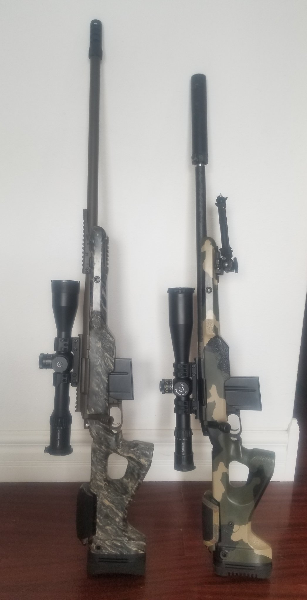

1.18 Spuhr(SP4001) would be my choice.
Rifle on right has 56mm in 4001 on an Impact, rifle on left is 1.36" with 56mm on Surgeon action.
