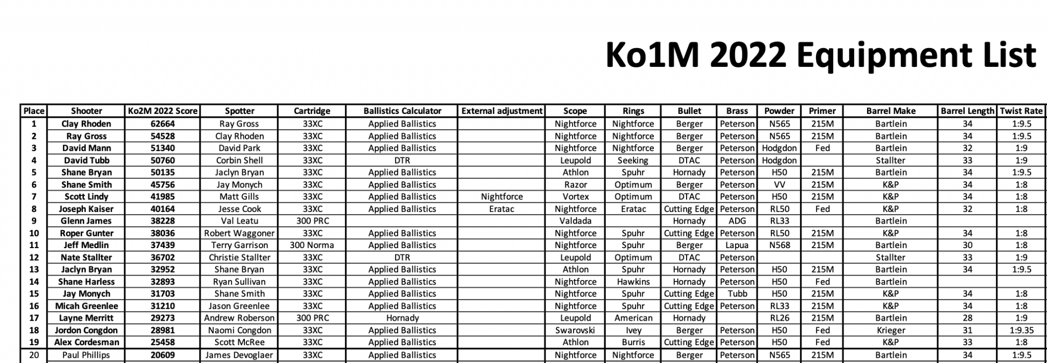

lol....because Lapua does not make 33xc brass, as yet.

The difference between throat erosion and performance When comparing the 33 XC to the Lapua AI and the 338 Edge it's just not worth the slight difference for the amount of throat erosion that you end up having with the XC they're just not that much of an edge in competition to be worth the hassle of by the time your Barrel settles in and you figure out your load you're chasing lands almost immediately having your rifle Go Out Of Tune in between matches for about a 500 round Barrel life at best is just not worth the effort. Sure you can download the thing just under 3,000 ft per second but then what's the point
am sure many do...but not the top 20
It's a good choice for sure but I wouldn't doubt if we see some of those top shooters come away from it for barrel life and the fact they aren't running much faster than some of the smaller cases. I've seen that list and there are a lot of the top ELR shooters in the world. I'm sure if you gave half those guys a 338 Lap AI the list would still look very similar. It's a lot more about consistency and wind reading than a couple feet per second
