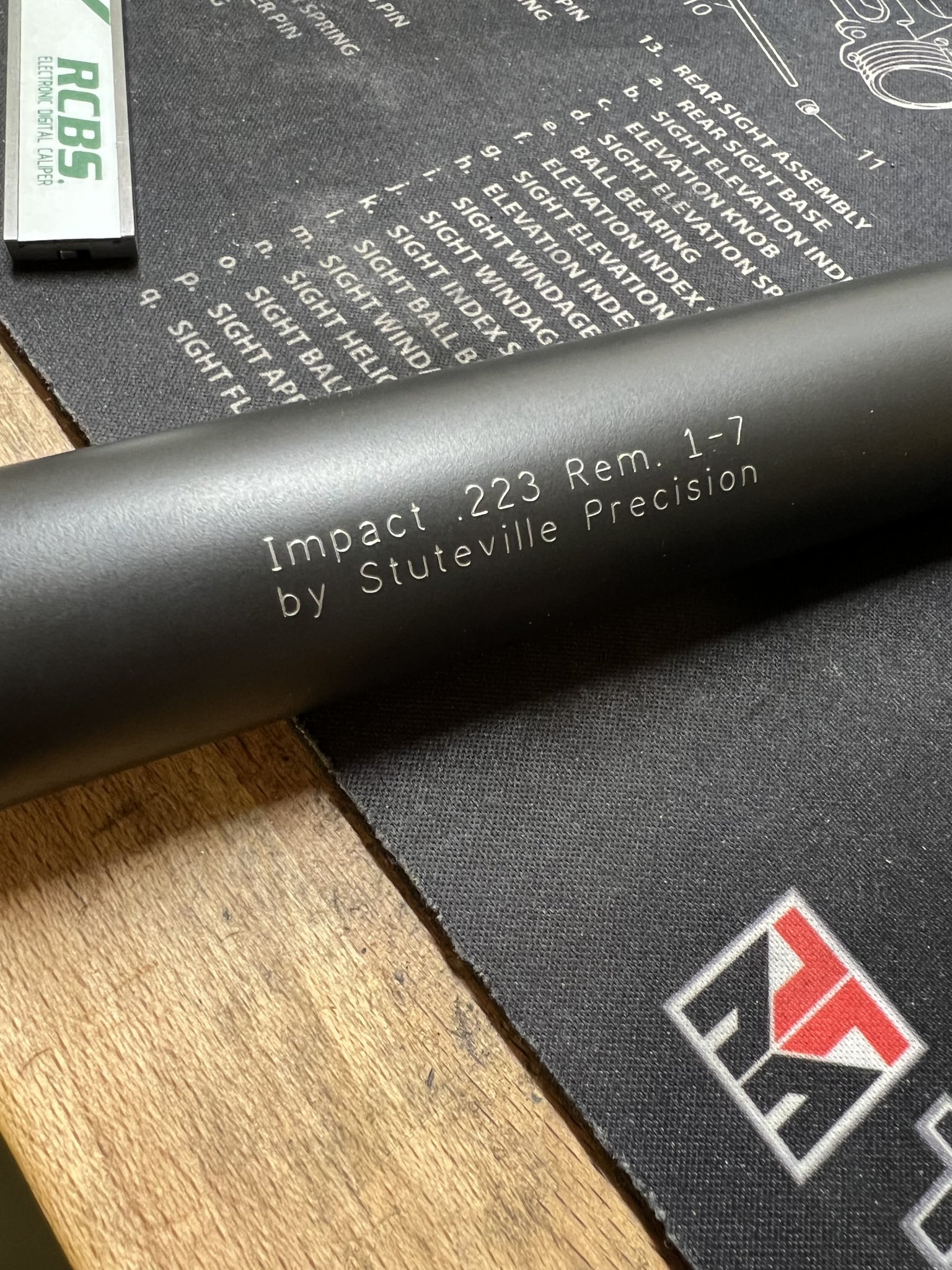

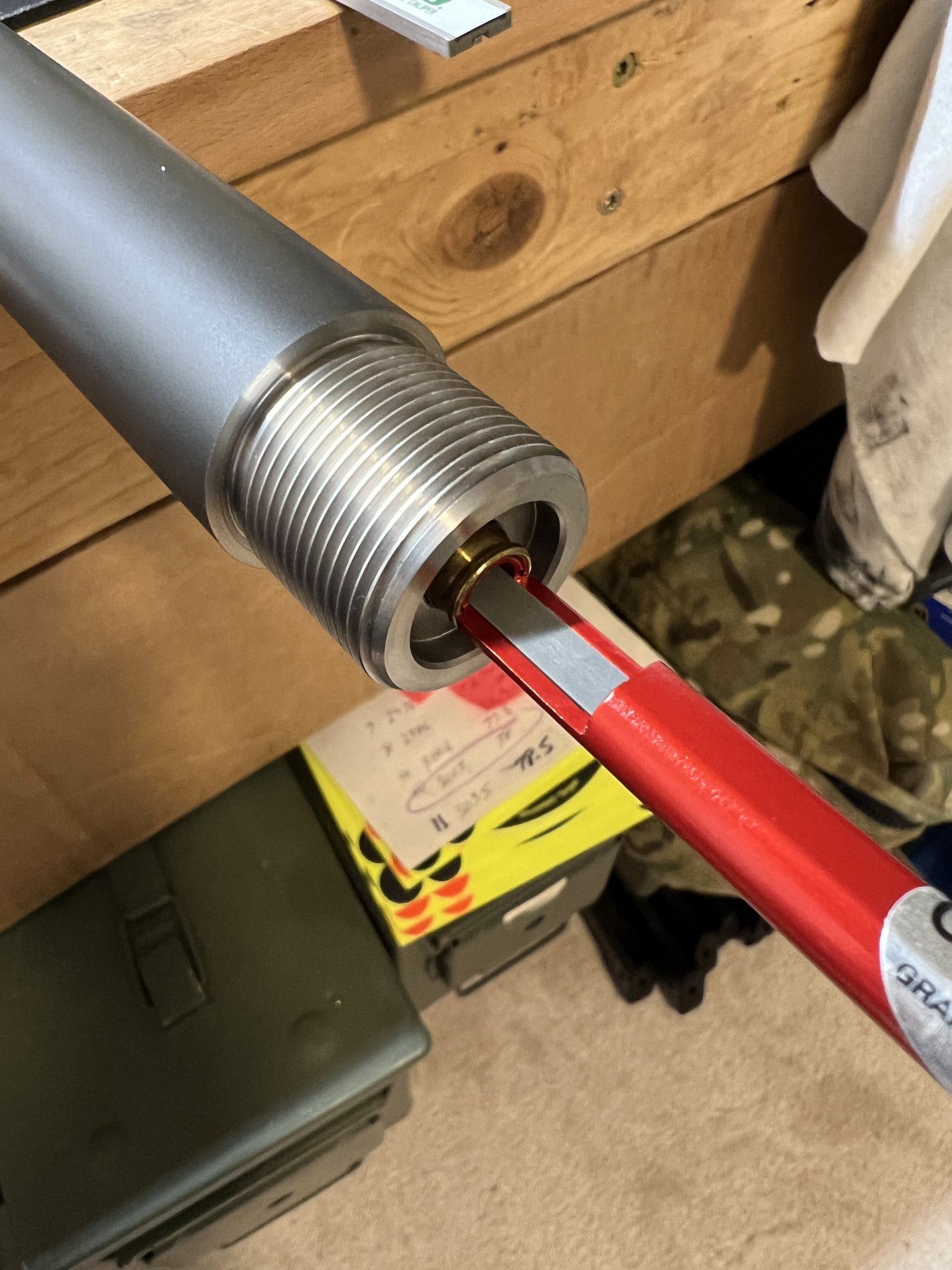

I recently purchased an Impact Precision pre-fit in .223. Upon receiving, I measured the chamber to determine the bullet jump with a 77gr SMK using the Hornaldy OAL gauge and discovered it to be very short...out of spec. The OAL of the measurement was 2.231(jam fit)? How did this barrel get through any QC process? What checks are normally made when chambering a barrel blank? I am glad I checked this barrel prior to screwing it on.

The Hornady OAL gauge is not reliable, there is too much variation based on how much pressure you're using on the tool. Use the Mark Gordon method and load a dummy round; it works every time.
Also, just email Impact. Every time I've had an issue, Tate responds within 5 minutes. Don't send anything off to PVA; if it's truly an issue from Impact/Stuteville, they'll make it right.
One more thought for you. Sometimes, for an inexplicable reason, people can seem to get a bad measurement from those hornady tools. If that is in impact pre-fit barrel that means you torqued it on and have the capability to take it off. I would recommend taking the barrel off and putting it in a vise with the chamber/ breach easily exposed to you. Take a piece of size brass without a bullet in it and "plunk" it down into the chamber and observe where the web and the rim sits. Observe and feel the "plunk" of the case shoulders hitting the front of the chamber. Make sure the case fits and slides freely without resistance in the chamber. Then seat a bullet at 2.260 and insert it into the chamber of the same way. If it doesn't "plunk" and instead it is stopped short of fitting in the chamber you should be able to feel the lands grab the bullet. Some sticky resistance. If you push in a little bit it makes pulling the dummy round out a little more difficult. Take that case with a bullet seated in it and progressively seat the bullet deeper 5 thou at a time and keep repeating until you feel the lands just barely grab the bullet and then eventually there will be no stickiness as the lands no longer grab or touch the bullet and it's replaced by the "plunk" feel of the shoulders hitting the front of the chamber. You can very easily discern where the lands are using this method and it's fairly foolproof.

I found the Hornady tool works fine if you use it properly. Don't jam the bullet as hard as you can. Just push the rod until it touches. Do it a couple times and should get the same reading.

The barrel has .025 FB. It shot Berger factory 77gr OTM very well at .310 sized groups going 2,825 fps.
I tried several other measurement techniques(remove the ejector and firing pin method...name?) and found the lands to be longer out than with the Hornady OAL gage was telling me. I am now measuring 75gr ELDs @ 2.438" OAL.
