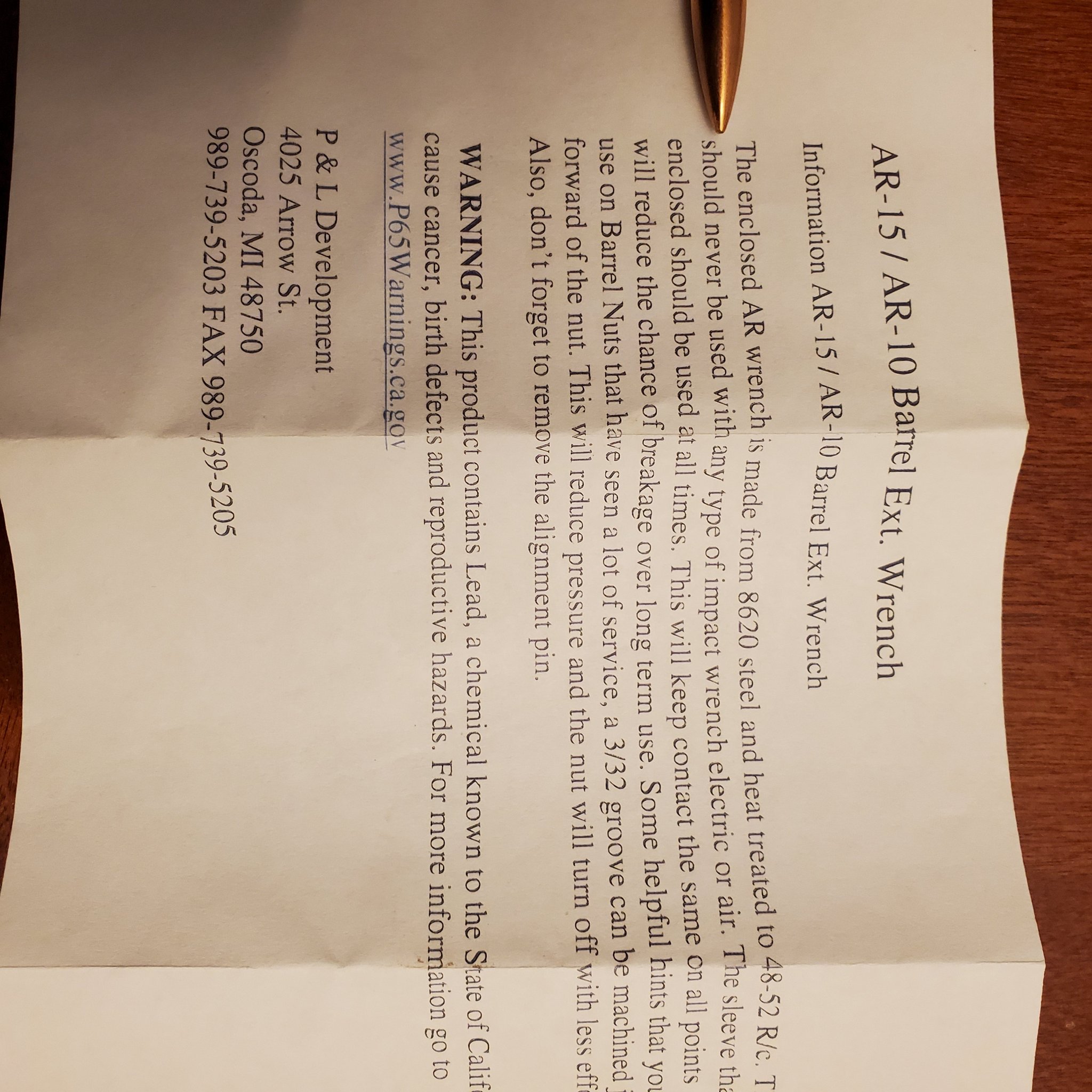

I remembered some instructions with AR barrel extensions...a similar situation. So I went and found instructions for AR 10 barrel extensions, the line where the bullet is ... states no impact wrenches should be used. They can be difficult to remove, but never use an impact wrench to remove or tighten. Remove with breaker bar, tighten with torque wrench...
