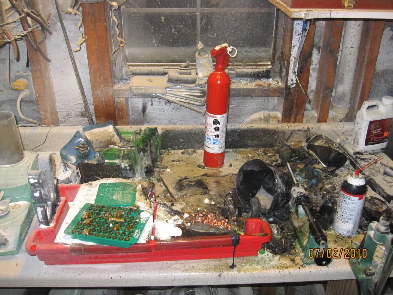

I just had a very real incident happen tonight. I had a friend stop by while I was reloading in my garage. I left to go have some beers with him in the house. Not more than five minutes later, we all hear popping noises. For some reason, I knew exactly what it was. Sure enough, I go back into my garage and gun smoke has filled the room. I cautiously approached my reloading bench as rounds are still popping off and see charged, but bullet-less cases burning one by one. Luckily for me, I have five fire extiguishers in my garage, so both me and my buddy go to town unloading all of them on the reloading bench, followed by several spray bottles of water.
The aftermath:

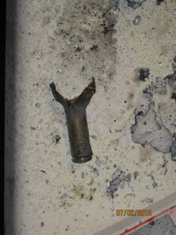

Most of the popping I heard was a box of .22 LR I had on the bench, some of it, some fully loaded .308 rounds in a plastic container. Luckily the cases exploded and the bullets didnt have enough energy to penetrate the walls or ceiling from what I can see:

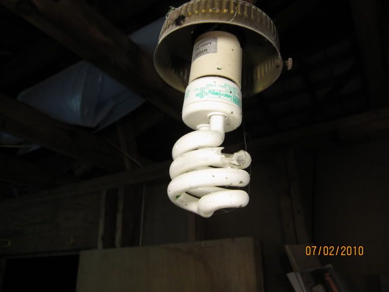

I'm still trying to figure out what started all this, but I found a possible culprit. This CFL bulb looks like it exploded, however Im not sure if a bullet hit it, or if it blew on its own accord:

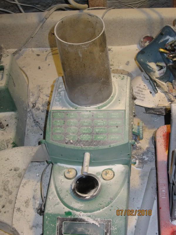

As a testament to RCBS, my Chargemaster had half a container of powder in it, which all got cooked out, however the Chargemaster still turns on:
Luckily the only damage so far is all of my bullet cases, an MTM maintenance station, maybe a few dies, and part of my bench. Oh, and my ego...
If it wasnt for my fire extinguishers, I'd probably be sleeping on the street right now.

Are either one of you smoker's? I've had at least a dozen of those "green" lightbulbs fail-always the ballast and with no smoke or fire. If I'm not mistaken florescent lighting is the only type allowed in closets and is VERY safe,I'd bet the source of ignition was some other source.Light bulb?I doubt it.

Since I made this post I went into my shop and sacrificed one of those curly bulbs by tapping at it with a rubber mallet, it took a sharp hit to break-no sparks,some white powder-NOTHING ELSE other than darkness.Breaker was not tripped either.It failed where the tubes come out of the ballast. My guess some debris may have broken yours. All my incandescent bulbs have industrial type shields. You post intrigued me as I have a shit load of those bulbs throughout my home (1 dollar each on sale-sponsored by our power company). I'm confident that they are safe. Sorry, as a former Police Arson Investigator this type of incident fascinates me.

What was sitting where the fire extinguisher is in the first pic? Seems like everything around that was burned away, and the fire was spreading outward hot enough to eat up the plastic quite quickly. Any chemicals that were around that area? Sometimes 2 chemicals may mix, and end up getting hot enough to cause themselves, or surrounding combustibles to ignite. I think in all honesty that it was a freak accident. I don't think that a primer exploding in open air would ignite much of anything. IIRC mythbusters did a test of igniting loose powder with a primer and it failed to ignite the powder (smokeless that is). Powder burning would burn up quickly, and melt plastic, but I don't think you had 8lbs of powder sitting on the bench without a lid, let alone sitting in a bowl.
My tip of the day for ALL reloaders.......smoke alarms, the type that is set off with excess heat if you have the dough or access to them. Powder burns with very little smoke, but a lot of heat. A heat alarm might give you more advance notice to act before more damage, or to evacuate before the 12 million primers you've been hoarding explode.

Like I said, Im not 100% sure it was the CFL.. I just found it to be the only thing that may have contributed to it, as it is directly over my reloading bench. We had a thunderstorm roll through a few hours earlier and were having power surges all night, but again, Im not sure if CFLs can become explosive during power spikes. The only other thing I can think of right now is I just put a surge protector strip near my outlet that same day and plugged everything into it. It was a pretty old power strip, but there was no evidence of fire coming from it.

I had a buddy of mine who is an arson investigator for our sheriff's department come by and assess the damage. He said it was pretty unlikely that the CFL caused it. He said when most CFL's explode, its just a vapor that immediately extinguishes when it hits oxygen. His thoughts were that it may have been a static electricity spark, given how charged the air was the past few nights and the amount of plastic on the bench..
Re: IMPORTANT!! PSA for ALL Reloaders
<div class="ubbcode-block"><div class="ubbcode-header">Originally Posted By: In da weeds</div><div class="ubbcode-body">I had a buddy of mine who is an arson investigator for our sheriff's department come by and assess the damage. He said it was pretty unlikely that the CFL caused it. He said when most CFL's explode, its just a vapor that immediately extinguishes when it hits oxygen. His thoughts were that it may have been a static electricity spark, given how charged the air was the past few nights and the amount of plastic on the bench.. </div></div>
Yeah, I'm no expert and I didn't sleep at a Holiday Inn last night, but something drastic happened.
I've got a million wall warts plugged in here and I'm in the second greatest lightning area on planet Earth, however while lightning strikes can kill electronics (CM 1500) they usually don't explode them.

Another observation I noticed which you all may take into consideration in case something like this happens- when I hosed down the flames with dry chemical extinguishers, it did a good job of putting out the flames, however it didnt do shit to cool off the brass and lead which occasionally flared up more flames. I know C)2 fire extinguishers are hard to come by nowadays, but find one, or go to Home Depot, and they sell these small aerosol cans of liquid extinguisher ( ttp://www.lowes.com/pd_120325-347-AF400_0_?productId=3009906&Ntt=fire%20extinguisher&Ntk=i_products&pl=1&currentURL=/pl__0__s?newSearch=true$Ntt=fire%20extinguisher$y=0$x=0 ).
Also, I just found out that the dry chemical is corrosive on some metals. Some of it managed to get into my range bag where I had my GP6 pistol and it destroyed the finish on the slide as well as the barrel..

I do want to mention something about CFL bulbs. We do use them around our house and haven't had a problem, BUT I know some people that have had problems with them. My father is a master electrician, and we've had questions and complains from 3 different customers on CFL's. 2 of the customers told dad that when they turned the light bulb on, it flashed and there was an open flame coming out of where the bulb meets the plastic. They put it out, but I've heard 2 different accounts of CFL's doing that, and the 3rd person's looked just exactly like the other two. They had my dad change out the fixtures, and the ones that saw the fire lost faith in CFL bulbs, and do NOT use them anymore. I haven't seen this personally happen with a CFL, but like I said, 2 of my dad's customers (who are trusted friends), have had that particular experience, and I've seen the burned fixtures that would support their stories. While it may not be common, I guess it does happen. I don't see any burn marks in the places where those peope reported it happening on their CFL's, but I guess it could also happen on the side. Maybe the CFL was broke from shrapnel, but I mention this so that others know what does sometimes happen with CFL's.
