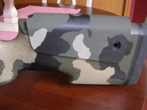

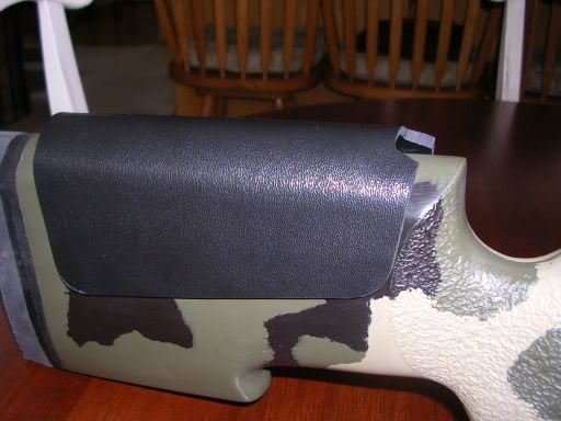

Re: Improvised Fitting
Made this simple cheek piece riser out of 1/8" ABS plastic, rough cut the ABS to shape, place it in the oven on a cookie sheet until its very workable, then place it over the stock till it cools. Grind to fit
